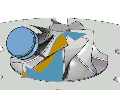

Operation Selection represents the current operation and other operations given in the CAD/CAM system.
The following picture shows toolpath in two colors. One color for the current operation, and another color for the other operations.

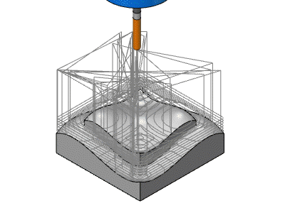

Sequence
The toolpath is colorized in a hot to cold gradient.
Main benefit
  • Identify start point and the end point of the machining.
  • Identify the cutting method (if ZigZag or OneWay).
  • Identify the cut order (from inside to outside, from outside to inside).
The following picture shows a machining of a half sphere. The sequence is from red to blue. You can see from the colorization the toolpath starts outside and ends in the middle of the sphere. Also, it is performed in a Oneway.

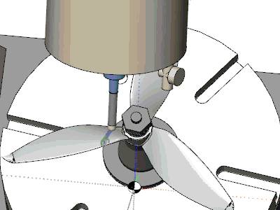

Rotation Axis Value
The toolpath will be colorized based on the tilt angle of the machines rotation axis. The coloring of the toolpath is done based on angle intervals.
Main benefit
  • Identify the rotation axis angle range being used.
  • Identify under which rotation angle a certain area is machined.
  • Identify limit overruns.
Start value - represents the starting value for the interval that will have the specific color
End value - represents the end value for the interval that will have a specific color
In the following images, you will see a part being machined in simulation, and a color change in the toolpath being cut. This is due to the assigned axis value colors.

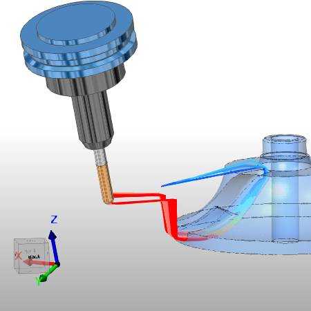

Linear Axis Reversal
The toolpath is colorized after linear axis reversals. A reversal can be defined by a threshold angle. The default is 150 degrees. So every time the linear axis changes the direction 150 degrees or more, the toolpath segment is colorized red.
Main benefit - Identify the area where possible axis reversal could have negative influence on the machining result or surface quality.
Due to the pattern, in some areas the toolpath changes its direction instantly.

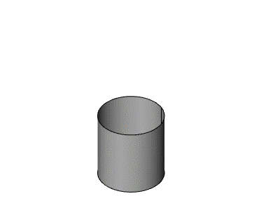

Feedrate
The toolpath is colorized after the feedrate.
  • Blue means that the toolpath has machining feedrate.
  • Yellow means that the feedrate is rapid rate.
The following animation shows a machining of a cylinder. You see the first entry and the last exit have travel with rapid feedrate.

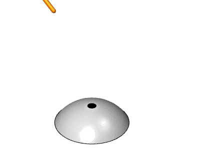

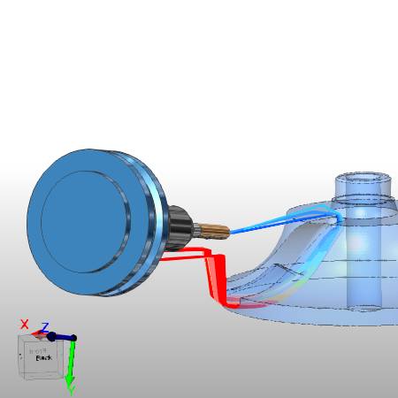

Height Change
The toolpath is colorized after its orientation of the tool relative to the toolpath. The colors are indicated next.
  • Red - Plunge in tool axis direction.
  • Orange - Lag angle orientation of the tool (pushing).
  • Grey - Normal orientation.
  • Light green - Lead angle orientation of the tool (pulling).
  • Green - Retracting along tool axis.
Main benefit
  • Identify if the tool is plunging into the part along its tool axis or with an angle.
  • Identify if the tool is being pulled or pushed.
  • Identify if the tool is retracting from the part along its tool axis or with an angle.
The following animation shows a machining of a convex shaped surface. The toolpath is a single motion. You can see the different orientations of the tool relative to the toolpath.

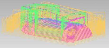

Single Marking
The Single Marking analysis option displays all toolpaths using a single color. After selecting the Single Marking option, you can double-click the small color box, next to Color for Toolpath Line, to select a different color than the default.
Main benefit
This is useful when you want to view all toolpaths in a single color, or for example, when taking screen shots of the toolpath from the simulation window.
The following image shows a program with multiple operations and the toolpath analysis is set to Single Marking.
