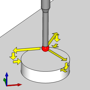

This cycle measures a cylinder extruded in the Z Axis with 3 points. This cycle can utilize the following geometry inputs:
  • An arc whose normal is parallel to the Z Axis.
  • A cylindrical surface edge whose normal is parallel to the Z Axis.
  • A cylindrical surface whose normal is parallel to the Z Axis.
Note: The probe lifts between measurements and the touch points move in towards each other along the specified angles as this cycle is meant to measure extrusions.

The Parameters section for this cycle consists of the Z Measurement Height, the angles on which the contact points will extend, the Diameter and the Update Work Offset value. In this case we do not really need to adjust the height at which the probe will make contact. The diameter is automatic and should not need to be adjusted, and the Update Work Offset value can be used as needed.In this part, let's just take a look at adjusting some of the angles.
  1. In the Parameters section, update the Third Angle value to 170 and pressing tab.
    The angle is updated, and we now have each contact point separated equally around the boss.
