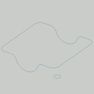

  1. The next step is to select geometry as the Sweep Path.Becausewe are selecting a closed sweep path, we could just hold Shift and click anywhere along the path to select it and define the direction in one click.Instead, we use the two click method and skip an entity to show how it is done.
    Click the end of entity shown below to set the start of the sweep path.
    The start arrow of the sweep path displays.
  2. To set the end of the sweep path, hold Shift and click near the end of the entity shown below.
    The Preview displays.
Note: Even though the chain for the sweep path is a closed path, we have selected the chain in such a way that we have avoided including a particular entity. Had we held Shift when clicking the first entity of the sweep path, all entities would have been included.
