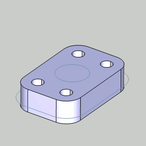

Part 3) Create the First Extrude Boss
For the first Extrude Boss, we use data entry only.
Tip: For the creation of the initial solid, you could also use Extrude Curve and get the same result. The Extrude Boss will combine any intersecting solid or surface, even if that intersecting solid or surface is on a hidden layer.
  1. In the Data Entry Manager under Positive Direction, double-click in the Distance box to select all the text.
    Type 0.625 to update the Distance value.
  2. In the graphics area, click and drag a window to select the wireframe flange shape.
    The entities go into the Selected Geometry list and the Preview appears.
  3. In the Selected Geometry list, highlight Arc-10.
    The arc highlights in the graphics area.
  4. With Arc-10 highlighted in the Selected Geometry list, click (Delete).
    The arc is removed from the Extrude Boss Preview.
Note: The center circle is removed because it is used later to create another boss. The other four circles are selected because we want them to create the holes for the flange. By including these in the first extrude, we eliminate the need to cut the holes using another CAD function.
  1. Leave the Scope set to All Bodies, and click OK to confirm.
    The Extrude Boss is created in the graphics area and an Extrude Boss feature is created in the CAD Tree.
    That is all that is needed to create an Extrude Boss feature.
    Leave the Extrude Boss function open.Another boss is created in the next part of this example.

Part 4) Create the Second Extrude Boss
For the second Extrude Boss, we explore Dynamic Drawing.
  1. Under Positive Direction, click in the right side of the Distance box so the cursor displays after the current value of 0.625.
  2. Type +0.05 and press Tab to update the value.
    The value displays 0.675.
  3. To make it easier to select the geometry press S, or  in the document toolbar, click Shaded.
    The Shading disappears.
  4. Hover over the center arc as shown in the image below.
  5. The CAD preview displays.
  6. Under the graphics area, change the value of the (Snap Increment) to 0.2500.
    This allows us to sketch CAD sizes and depths in increments of 0.2500.
  7. Now to show how to use the dynamic sketch handles.
    Hover over the lower sketch handle to highlight it.
  8.  Click to select the lower sketch handle.
    The sketch handle highlights and shows the next possible position based on our Snap Increment.
  9. Move the sketch handle down slightly.
    The Preview displays the next possible position based on our Snap Increment.
  10. Move the sketch handle back to the 0.2500 position and click to set it to create a small extrusion on the underside of the part.
    The Preview updates to show the current Other Direction amount.
  11. To confirm the selection, click (OK).
    The Extrude Boss is created in the graphics area and another Extrude Boss feature is created in the CAD Tree.
  12. Pres S,or select Shaded from the document toolbar.
Leave the Extrude Boss function open. Another boss is created in the next part of this example.

Part 6) Understanding/Verifying the Result
It is important to understand that the Extrude Boss function merges all intersecting solid bodies into a single solid body. The CAD Tree helps to illustrate this fact. When you close the Data Entry Manager, the CAD Tree Manager automatically displays.
  1. Notice that there are three Extrude Boss features in the CAD Tree.
    The CAD Tree provides many tools to help you modify, verify, and organize your CAD features.
    If you enable selection mode and point to the solid in the graphics area, you can see that it highlights as a single solid body.
    Another way to confirm this is to use the Solids folder in the CAD Tree.
  2. Double-click the Solids folder to expand it, or, click the small plus sign.
    Notice that there is one item, Solid 1.
    Click Solid 1 to highlight the solid body in the graphics area.
    All of the feature items in the CAD Tree show a preview when you click them.
  3. Click the first Extrude Boss feature in the CAD Tree, and notice the result of the feature is highlighted in the graphics area.
To make this easier to view, in the Layers Manager, right-click Solid and click Hide.
Note: Notice that there are no longer any items in the Solids folder of the CAD Tree. The Solids folder only contains Solid items that are currently visible in the graphics area. Hiding the Solid layer temporarily removes the Solid item from the Solids folder.
  1. Click each feature and geometry item in the CAD Tree to view the result or selection of the feature, respectively.Expand each feature if needed.
