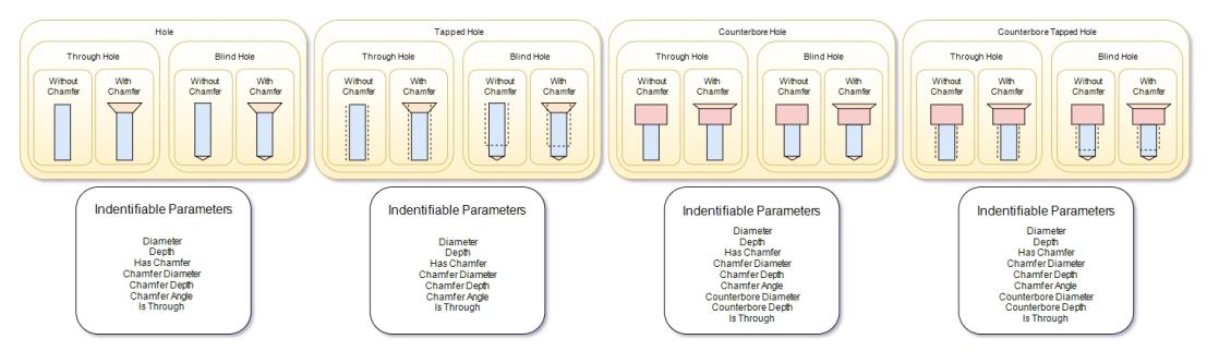

The Hole Recognition in BobCAD-CAM is able to automatically identify the 4 types of supported hole features from the selected geometry:
  • Hole
  • Counterbore Hole
  • Tapped Hole
  • Counterbore Tapped Hole
In order to create the features, certain parameters are also identified from the geometry:
