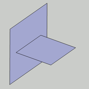

The boundary options determine how the fillet is trimmed at the outer boundaries. The following image shows the two original surfaces as a reference to the result shown below each option.
Original Surfaces

  2.  Hover over the surface created on the Front Plane as shown in the image below.
  3. Select the surface.
    The surface is added to the First Surface/Solid list.
  4. Hover over the surface created on the Top Plane as shown in the image below.
  5. Select the surface.
    The surface is added to the Second Surface/Solid list and the Preview appears showing the result if the default Blend option is used.
