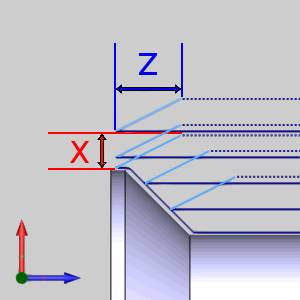

  • Custom - creates a lead into the material that is dictated by the values entered in the Lead-in Z, and Lead-in X boxes.
    • Lead-in Z - sets the distance and direction of travel, in the Z-axis, for the approach into the toolpath.
    • Lead-in X - sets the distance and direction of travel, in the X-axis, for the approach into the toolpath.

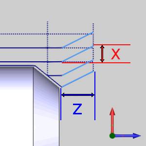

  • Custom - creates a lead out of the material that is dictated by the values entered in the Lead-out Z, and Lead-out X boxes.
    • Lead-out Z - sets the distance and direction of travel, in the Z-axis, for the approach into the toolpath.
    • Lead-out X - sets the distance and direction of travel, in the X-axis, for the approach into the toolpath.
