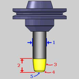

Drill
Center Drill
  • Diameter (1) - sets the diameter of the tool.
  • Small Diameter (2) - sets the small diameter of the tool.
  • Angle (3) - sets the angle of the area between the Small Diameter (2)  and the Diameter (1).
  • Point Angle (4) - sets the angle of the tip of the Center Drill.
  • Small Diameter Length - sets the length of the Small Diameter from end of Point Angle (4) to beginning of Angle (3).
  • Additional Information - lists any notes added by the user in the Additional Information field on creation. (Displayed for informational purposes)
  • Holder Label - displays the name of the associated tool holder. When blank, no tool holder is associated. (Displayed for informational purposes)
  • Tool Material - is the tool material type of the selected tool. (Displayed for informational purposes)

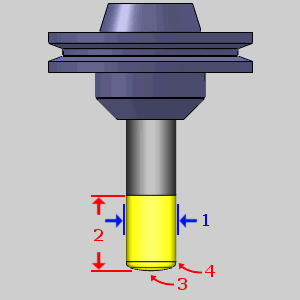

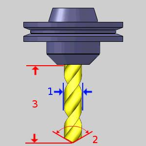

Drill
  • Point Angle (2) - sets the angle of the tip of the Drill.
  • Flute Length (3) - sets the length of the flute/cutting portion of the tool.

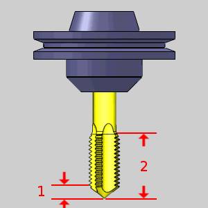

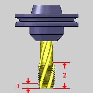

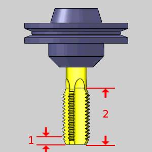

Spiral Tap
  • Thread-  displays the thread type - size. This value is selected on the Feature page.
  • Ineffective Number of Threads (1) - sets the ineffective length for tap tools using the number of threads.
  • Thread Direction - is disabled, as it is set on the feature page.

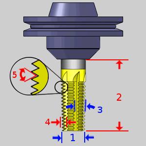

Point Tap

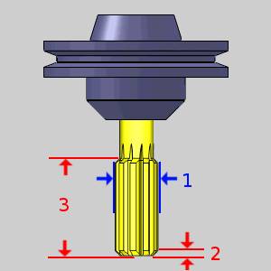

Rolling Tap

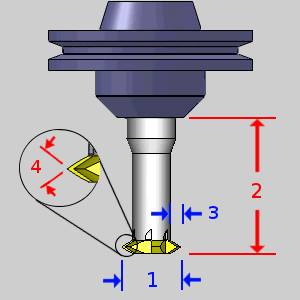

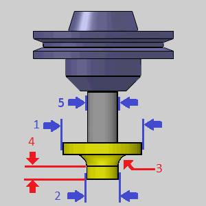

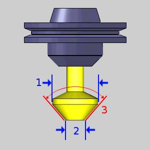

Chamfer Tool
  • Small Diameter (2)- sets the small diameter of the tool.
  • Ineffective Length - specifies the length of extension on the small diameter that is not used for cutting.

Counterbore
  • Diameter(1)- sets the diameter of the tool.
  • Small Diameter Length - sets the length of the small diameter.
  • Overall Length - set the total length of the tool.This value must be greater than the Protrusion Length.
  • Holder Label - displays the name of the associated tool holder.When blank, no tool holder is associated.

Reamer
  • Ineffective Length (2) - sets the length of the chamfer on the tip of the tool.

Boring

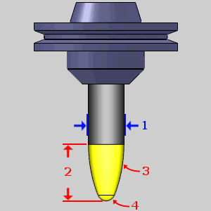

Endmill Rough
  • FluteLength (2) - sets the length of the flute/cutting portion of the tool.
  • Corner Radius - sets the size of the corner radius.
  • Number of Flutes - specifies the number of cutting flutes for the tool

Endmill Finish

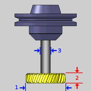

Chamfer Mill
  • Angle (2) - sets the included angle of the tool.
  • Small Diameter (3) - sets the small diameter of the tool.

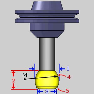

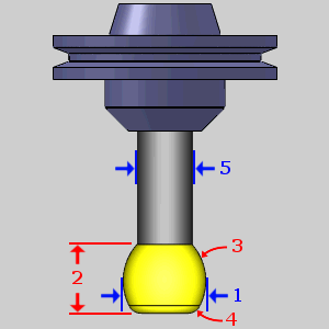

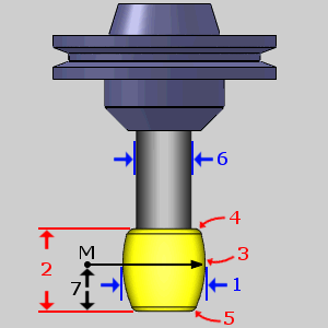

Corner-Round
When defining a corner rounding tool, the diameter must be greater than or equal to the small diameter plus twice the corner radius.
Diameter >= Small Diameter + (Corner Radius * 2)
If you enter values that do not fit this equation, an error message displays.
Tip: When defining a corner rounding tool, if the Diameter is greater than the current/default value, set the Diameter value first. This allows you to avoid receiving the error message. If the Diameter is less than the current/default value, set the Corner Radius first to avoid the error message.
  • Corner Radius (3) - sets the corner radius size of the tool.
  • Small Diameter Length (4) - sets the size of the small diameter of the tool.
  • Shaft Diameter (5) - sets the diameter of the shaft.

Thread Mill
  • Protrusion Length (2) - sets the distance that the tool protrudes from the tool arbor when a tool holder is assigned to the tool.
  • Taper Angle (3) - sets the angle of the tool if applicable.
  • Thread Height (4) - sets the height of the threads of the tool.
  • Thread Angle (5) - sets the included angle between the thread flanks.
  • Pitch - sets the distance from one tooth to the next.
  • Flute Length - sets the cutting length of the tool.
  • Pitch- sets the pitch of the tool.
  • Thread Height (3) - sets the height of the threads of the tool.
  • Thread Angle (4) - sets the angle of the thread.

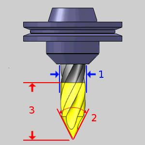

V-Tool
  • Included Angle (2) - sets the angle of the tool tip.

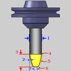

Tapered
  • Flute Length (2) - sets the cutting length.
  • Angle(3) - sets the angle of the taper.
  • Corner Radius - sets the corner radius of the tool.
  • Overall Length - sets the overall length of the tool.

T-Cutter
  • Shaft Diameter (3) -sets the diameter of the shaft.
  • Protrusion Length  - sets the distance that the tool protrudes from the tool arbor when a tool holder is assigned to the tool.

Lollipop
  • Shaft Diameter (3) - sets the diameter of the shaft.

Barrel Standard
  • Profile Radius (3) - sets the radius used as the side profile of the tool.
  • Corner Radius(4) - sets the radius used as the transition between the bottom and the Profile Radius of the tool.
  • Shaft Diameter(5) - sets the width of the tools shaft.
  • Overall Length- sets the overall length of the tool.

Barrel Advanced
  • Flute Height by
    • Upper Diameter - defines the end of the flute by specifying the diameter at which it terminates.
    • Length - defines the end of the flute by the height at which it terminates.
  • Profile Position by (Axial) - defines the center arc of the profile radius in height along the center of rotation.
    • Distance(M) - defines M in height from base.
    • Reference Diameter - defines M by specifying the diameter at the base.
  • Profile Position by (Radial) - defines the center arc of the profile radius in width from the center of rotation.
    • Distance(M) - defines M in distance from center of rotation.

Barrel Tangent
  • Profile Radius (3) - sets the radius of the tools cross section.
  • Corner Radius (4) - sets the radius used between the tools bottom and the Profile Radius.

Barrel Taper
  • Taper Angle (2) - sets the angle along which the Profile Radius will be applied.
  • Flute Length (3) - sets the cutting length.
  • Upper Radius (4) - sets the radius applied between the Profile Radius and the shaft.
  • Profile Radius (5) - sets the radius applied to the face of the taper angle.
  • Corner Radius (6) - sets the radius used between the tools Flatness Diameter and the Profile Radius.
  • Flatness Diameter (7) - sets the width of the flat portion of the tool bottom.

Barrel Section
  • Profile Radius (3) - sets the radius applied to the cross section of the tool.
  • Upper Corner Radius (4) - sets the radius applied between the Profile Radius and the shaft.
  • Lower Corner Radius (5) - sets the radius used for the profile section of the tool tip.
  • Shaft Diameter (6) - sets the width of the tools shaft.
  • Distance(M) Axial (7) - defines the center arc of the profile radius in height along the center of rotation.
