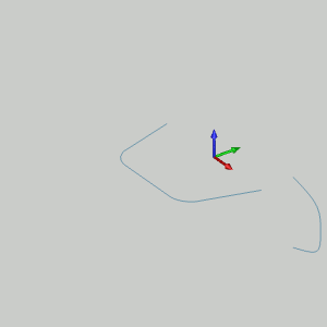

  2. Use any of the Auto-Chaining option in the Picking Manager to chain select the Trajectory Curve on the XY plane. Click near either end of the chain.
    Notice that the Trajectory Curve is selected on the XY plane of the Active UCS, and that the focus has shifted to the Profile Curve list.

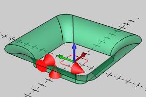

  3. Click to chain select the Profile Curve on the XZ plane. (Click near the upper end of the chain.)
    Note that the Profile Curve is selected on the XZ plane of the Active UCS.
    After selecting the profile curve, the CAD preview displays in the Workspace.
    Notice the resulting surface. The profile curve follows the trajectory curve while being revolved around the Z-axis of the Active UCS. (Also, the direction of the profile curve does affect the result when using Follow Trajectory Curve as it defines where the profile starts and ends in relation to the path.)
