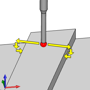

This cycle measures the distance between two planar surface faces which are parallel with each other, but not to the X Axis, nor the Y Axis. This cycle can utilize the following geometry inputs:
  • Two parallel lines which are not parallel to the X or Y Axes.
  • Two parallel planar surface edges which are not parallel to the X or Y Axes.
  • Two parallel planar surfaces whose normals are not parallel to the X or Y Axes.
Note: The probe lifts between measurements and the touch points move in towards each other as this cycle is meant to measure extrusions.

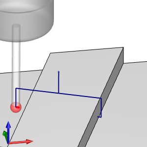

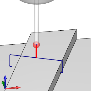

Note: The Web measure cycle measures the distance between two parallel surfaces that are both either parallel with the Y Axis, or the X Axis. In this case we measure two surfaces parallel with the Y Axis.
  1. Click the Parameters tab.
  2. Select the edge of one of the planar surfaces whose normal is not parallel with the X or Y Axes.
    Since our current geometry works for a Angled Surface in XY Plane cycle, that is the cycle that is currently selected for us.
  3. Select the edge of the parallel surface.

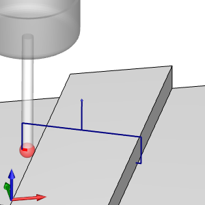

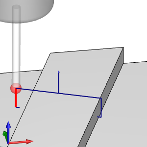

    However, notice how the end positions are tied to the initial position.Since this is obviously not what we need, we will set that value back as it was.
  3. In the Initial Position group, update the Z value by adding -0.75 to the end, and pressing Tab.
    The value and the toolpath update to put the moves out from the initial position three-quarters of an inch further down toward the part.
