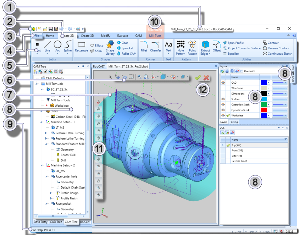

The User Interface
There are twelve main areas of the user interface. Learning about these twelve areas and the terminology that is used to describe them is an integral part of learning to use BobCAD-CAM software. Every action that is performed inside the software is handled through one of these areas. Click the links listed for detailed descriptions to start learning about each section of the user interface.
| Interface Key | |
| 1. Title Bar | The title bar shows the name of the file currently open in the graphics area. |
| 2. Ribbon Tab | The Ribbon Tabs allow you to activate one ribbon at a time. Click Introduction to Ribbons for more details. |
| 3. Quick Access Toolbar | The Quick Access Toolbar gives you access to basic file options. Click The Quick Access Toolbar for more details. |
| 4. Backstage | The Backstage is where all the file options, Themes, Help options, Settings Part and Default, User Profiles, and keyboard shortcuts can be found. Click Introduction to the Backstage for more details. |
| 5. Ribbon | The Ribbons give you access to various functions. Click Introduction to Ribbons for more details. |
| 6. Document Toolbar | The Document Toolbar keeps all of your view options right inside the graphics area. |
| 7. Graphics Area | The Graphics Area is the visual interface between the user and the file. Will show all CAD, and Toolpath data. Click The Graphics Area for more details. |
| 8. Docking Pane | The Docking Panes include all managers: Data Entry, CAD Tree, CAM Tree, Operation Manager, BobART, BobCAD Live, Layers, UCS, Posting, and Measure. Click Introduction to Docking Panes for more details. |
| 9. Status Bar | The Status Bar displays the steps of the current operation, shows the mouse position, and allow you to set a Snap Increment, along with the active Color, Line Style, and Unit. Click The Status Bar for more details. |
| 10. Contextual Tab | The Contextual Tab will show Job related options when you click on the job in the CAM Tree. Click Introduction to Contextual Ribbons for more details. |
| 11. Selection Masks | A toolbar that remains in the graphics area to allow access to all selection masks. These commands are used to determine what entity types are able to be selected. See the Selection Mask section of The Home Ribbon topic for more information. |
| 12. OK and Cancel | The OK and Cancel button are also located directly in the graphics area to allow them to be accessed with ease. |
