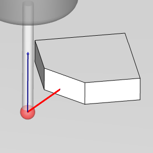

The Angled Surface in XY Plane Cycle
This cycle measures a planar surface whose normal is neither parallel to the X Axis, nor the Y Axis. This cycle can utilize the following geometry inputs:
  • Line which is neither parallel to the X Axis, nor the Y Axis.
  • Planar surface edge which is neither parallel to the X Axis, nor the Y Axis.
  • Planar surface face whose normal is neither parallel to the X Axis, nor the Y Axis.

  2. Select the edge of the surface whose normal is not parallel to the X, or Y Axis.
    Since our current geometry only works for a few cycles, the intended cycle is currently selected for us.
Note: Notice we are on the wrong side of the surface though. This could easily be corrected with the Other Side button in the Initial Position group, but we will update the geometry instead.
Part 5) Updating the geometry
In this case, the geometry we have chosen is interpreted as an External Corner cycle. The probing feature can do quite a bit of intelligent placement of the toolpath based on the surfaces selected. When edges are the only thing used for geometry selection, not as many assumptions can be made for the intelligent placement of the toolpath. We will take a look at how the geometry selection affects the automatic placement of the created toolpath.
  1. Next to the Selected Geometry list box, click the Delete All button.
    The geometry is removed from the list, and the edge is no longer highlighted.
  2. Select the surface whose normal is not parallel to the X, or Y Axis.
    The surface is added to the Selected Geometry list, and the toolpath updates.
    Notice this put the toolpath on the correct side of the part, as well as sets a more reasonable Z Measurement Height.
