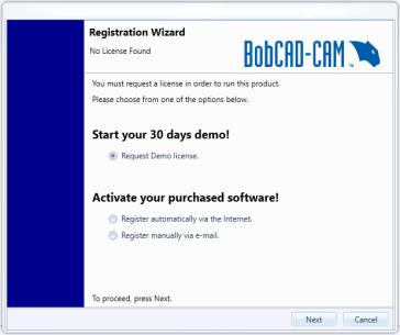

    The Unregistered dialog box appears and you are prompted with three choices:
    • Request Demo License - activates all modules of the software for a 30 day period. Code output is limited to headers and end blocks only.
    • Register automatically via the internet - walks you through licensing a network, or node locked license over the internet.
    • Register manually via email - walks you through licensing a network, or node locked license through a separate computer with internet connection. This method utilizes email and USB Flash Drive file transfers between the station to be licensed and the station with an internet connection.
2) Request Demo license
  1. With Request Demo license selected, click Next>.

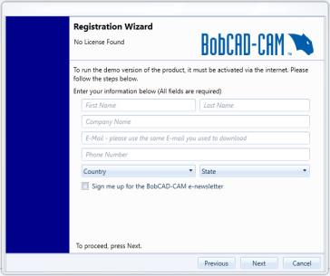

    The Request Demo License dialog box appears.
  2. Complete all fields in the form and click Next.
    A Success message should appear.

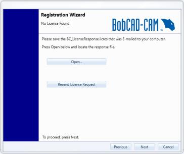

3) Open the Attachment with Registration Wizard
  1. You receive an email with an attachment in response to your request.
    Save the attached file and take note of the location in which it is saved.
  2. Click Open... .
    The File Open dialog box appears.
  3. Locate the attachment you saved and click Open.
    An Activation Success! message should appear.
  5. The File Open dialog box closes and you are returned to the Request Demo License dialog box.
    Click Next>.

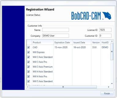

  6. The License Status dialog box appears.
    The software is now registered as a demo for the next 30 days.
