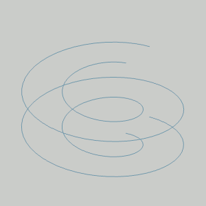

    In the example file, the geometry for the ruled surface is two 3D spirals (helices) that consist of many line segments. Ruled Surface uses two wireframe chains to create a surface with a linear connection between the chains. For the first part of this example we see the result of the spline curves made of line segments.

  1. Using the Auto-Chaining option with Constant Z off, click the small line segment at the upper end of the helix.
    The start and end arrows display to show the first chain is selected.
  2. Select the second helix using the same method. Be sure to click near the upper end of the helix to define the same chain direction as the first chain.
    When you complete the second chain selection, the surface preview is automatically created.
    Notice the preview of the resulting surface is many small surfaces, one for each set of line segments in the two helices.

Notice the significant improvement in the Ruled Surface as a result of creating the spline curves. The surface is now a single entity. This method can often be used to improve the result of a Ruled Surface when using complex wireframe input geometry, especially when the chains don't contain the same number of entities.
