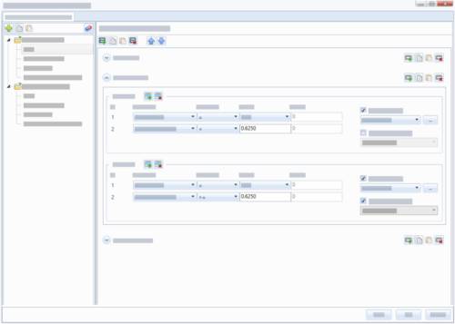

The Knowledge Base allows you to determine, in advance of a job, how to handle the 4 types of supported hole features BobCAM automatically recognizes:
  • Hole
  • Counterbore Hole
  • Tapped Hole
  • Counterbore Tapped Hole
The Knowledge Base contains templates comprised of various rules that you will define to determine which operations and parameters to apply to any geometry identified as one of these feature types. When a particular hole type is identified, the rules are then referenced in order to build the features and operations based on your specifications.

The Knowledge Base Manager
Rule Templates
Each  template is essentially a folder containing all the rules for determining which operations, and which parameters, are applied to each hole found under each particular hole type.
Tip: You can modify the existing default templates, or create your own. Perhaps you handle your holes differently depending on the machine you are working on, or the material you are working in. You can create a different template for each of these situations. Each template, will then allow you to handle each of the four hole feature types differently.
Quick access menu
By right-clicking in the template column, you can access a context menu that gives you the ability to create new templates, as well as copy, paste, and delete templates. The quick access menu gives you these same options:
  • Create New Template - automatically creates a blank Template and adds it to the list.
  • Copy Template - adds the highlighted template to the clipboard so you can utilize the Paste Template option.
  • Paste Template - allows you to add another of the copied template to the list. The new template will utilize the same name with "-Copy" attached to the name.
  • Delete Template - opens a dialog verifying you intend to remove the selected template. Click Yes to remove, and No to keep it in the list.
Note: Clicking on a hole type in a template gives you access to its Rule Groups.

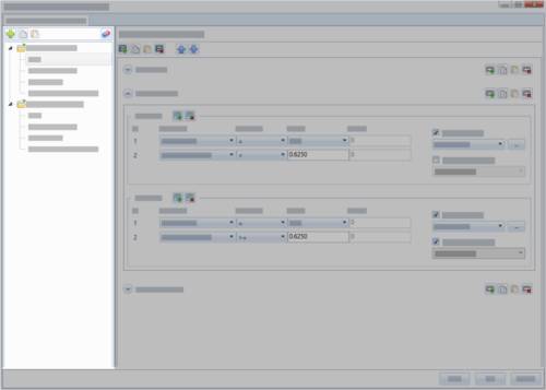

Rule Template Features
Each template is broken down into four parts, one for each of the possible hole types:
  • Hole
  • Counterbore Hole
  • Tapped Hole
With one of these features highlighted in a particular template, the rule groups to the right will be assigned to that particular feature, and template.

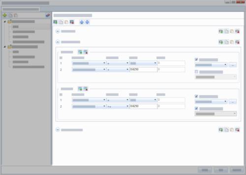

The Rule Group Section
This section is where all rules are made. The top level item in this section is the Rule Group which contains Rule Sets. It is the Rule Sets that contain the Rules themselves.
Context menu
Right-clicking along the top of a Rule Group section gives you access to the following items in a context menu:
  • Create new group - automatically creates a blank rule and adds it to the list.
  • Copy group - adds the highlighted rule to the clipboard so you can utilize the Paste Template option.
  • Paste rule group - allows you to add another of the copied rule to the list. The new rule will utilize the same name with "-Copy" attached to the name.
  • Delete rule group - opens a dialog verifying you intend to remove the selected rule. Click Yes to remove, and No to keep it in the list.
  • Move up rule group - moves the highlighted rule up the list.
  • Move down rule group - moves the highlighted rule down the list.
Quick access menu
The quick access menu gives you access to the following items:
  • Create new rule group - automatically creates a blank rule and adds it to the list.
  • Copy rule group - adds the highlighted rule to the clipboard so you can utilize the Paste Template option.

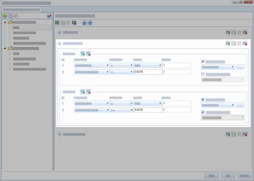

Rule Groups
Rule Groups contain Rule Sets, which are comprised of individual rules. The Rule Group contains as many Rule Sets as necessary to define what operations will be utilized when the rules are met.
Tip: The best way to think about the Rule Groups is equate them to particular considerations of how to cut a hole. When you approach a machining job with a hole, you probably consider how large it is, how deep it is, and whether it has a chamfer or not. Each one of these considerations can be expressed as a Rule Group.
Context menu
Right-clicking along the top of a Rule Group gives you access to the following items in a context menu:
  • Copy - copies the entire Rule Group, and can then be pasted by using the Paste rule group option as seen in the section above.
  • Delete - opens a dialog verifying you intend to remove the selected rule group. Click Yes to remove, and No to keep it in the list.
  • Rename - allows you to rename the rule group.
  • Move Up - will move the selected rule group up one position in the list of rule groups.
  • Move Down - will move the selected rule group down one position in the list of rule groups.
  • Create New Rule Set - will add a new rule set to the rule group.
  • Copy Rule Set - will copy the currently selected rule set to the clipboard. If a rule set is not highlighted a dialog will appear instructing you to select one.
  • Paste Rule Set - once a rule set has been copied to the clipboard, this option will paste a copy of the rule set to the rule group.
  • Delete Rule Set - opens a dialog verifying you intend to remove the selected rule set. Click Yes to remove, and No to keep it in the list. If a rule set is not highlighted a dialog will appear instructing you to select one.
Quick access menu
The quick access menu gives you access to the following options:
  • - will add a new rule set to the rule group.
  • - will copy the currently selected rule set to the clipboard. If a rule set is not highlighted a dialog will appear instructing you to select one.
  • - once a rule set has been copied to the clipboard, this option will paste a copy of the rule set to the rule group.
  • - opens a dialog verifying you intend to remove the selected rule set. Click Yes to remove, and No to keep it in the list. If a rule set is not highlighted a dialog will appear instructing you to select one.

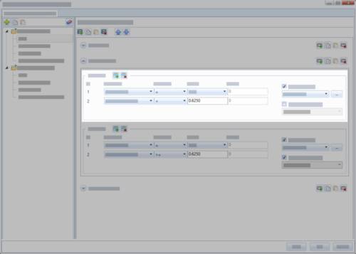

Rule Sets
Rule Sets contain at least one rule, and sometimes many rules. These rules decide what operations are added to the feature when one of those rules are met.
Tip: If you think of the Rule Group as one of the considerations of how to cut a hole, (perhaps you cut a large hole differently than a small hole) the best way to think about a Rule Set is equate them to the desired results for each one of those possibilities. (Create one Rule Set for the large hole, and one for the small hole.)
Context menu
Right-clicking along the top of a Rule Set gives you access to the following items in a context menu:
  • Copy - copies the entire Rule Set, and can then be pasted by using the Paste rule set option as seen in the section above.
  • Delete - opens a dialog verifying you intend to remove the selected rule set. Click Yes to remove, and No to keep it in the list.
  • Create New Rule - will add a new rule to the rule set.
  • Delete Rule - opens a dialog verifying you intend to remove the selected rule. Click Yes to remove, and No to keep it in the list. If a rule is not highlighted a dialog will appear instructing you to select one.
Quick access menu
  • - will add a new rule to the rule set.
  • - opens a dialog verifying you intend to remove the selected rule. Click Yes to remove, and No to keep it in the list. If a rule is not highlighted a dialog will appear instructing you to select one.
