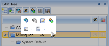

  • Enable CAM Tree Flyouts - The CAM Tree Flyouts appear as the '>>' symbols next to items in the CAM Tree. These allow you to double check some, and even edit other values by simply clicking on them in the CAM Tree.
    Select the check box to show, and be able to utilize, the CAM Tree Flyouts.
    Clear the check box to hide the CAM Tree Flyouts.
