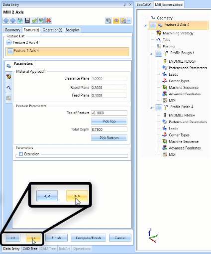

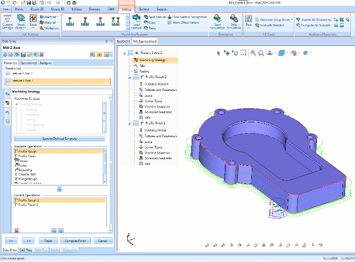

New Built-In CAM Wizard
As shown above, the brand-new CAM Wizard is now built directly into the side panel, giving you a streamlined, modern workflow like never before. Unlike previous versions where you had to fully set the parameters and compute blind without seeing a visual, you can now set up your toolpaths while keeping full visibility of the graphics area — see exactly what you're creating in real time
Even better, the Mill 2-Axis, Lathe, and Wire EDM toolpaths auto-compute on the fly while you're building the feature. For the other toolpaths, you can simply click the "Compute Toolpath" icon button located at the top right of the CAM wizard to see the toolpath changes in the graphics area. That means faster setup, instant visual feedback, and the freedom to make adjustments on the spot.
No need to worry about the visual change of the UI for existing customers. The workflow remains the exact same as the previous CAM Wizard. You will have the same tabs to go through and the same"Previous", "Next", "Finish", "Compute/Finish" and "Cancel" buttons at the bottom to click through the whole wizard.
This is the biggest UI upgrade in BobCAD-CAM V38 — and it will streamline your workflow and the way you program.

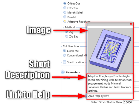

Learning the CAM Wizard just got way easier in BobCAD-CAM V38! We've expanded our popular Contextual Help system — previously available in CAD — into the new CAM Wizard.
Now, as you build your toolpaths, just hover your mouse over any parameter in the CAM Wizard. Instantly, you’ll get a helpful pop-up with:
  • A visual image of what the parameter does
  • A short, easy-to-understand description
  • A link to full documentation in the Help System
This makes it simple to understand every setting without ever leaving the workflow.

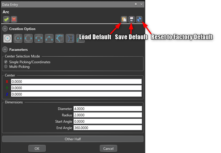

CAD Defaults: Your Settings, Your Way

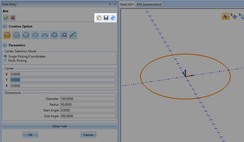

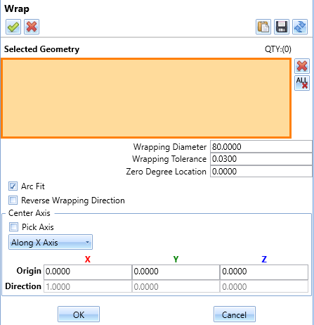

Take control of your CAD workflow with the new CAD Default Parameters feature in BobCAD-CAM V38! You can now save your own custom settings for CAD functions — no more resetting values every time you open a new file.
At the top of every CAD function window, you'll now see three new buttons:
  • Load Default – instantly applies your saved preferences
  • Save Default – stores your current settings as your personal default
  • Reset to Factory Default – reverts everything back to factory settings
Want to always start with arcs at 0.5" diameter? Set it once, click Save Default, and you’re done — every new file will automatically use that value. You can even use Load Default to restore your custom settings after tweaking things mid-session.
And for metric users — no more odd decimal values! We've updated the default metric values so they make practical sense when working in millimeters (no more awkward inch conversions).
Whether you're working in inches or millimeters, this feature helps streamline your design process, reduce repetitive setup, and give you a CAD experience that fits your style.

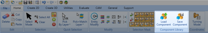

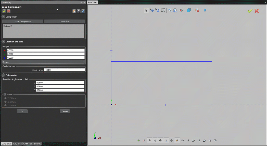

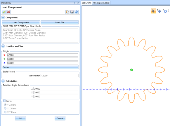

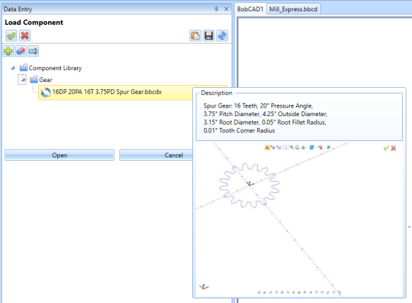

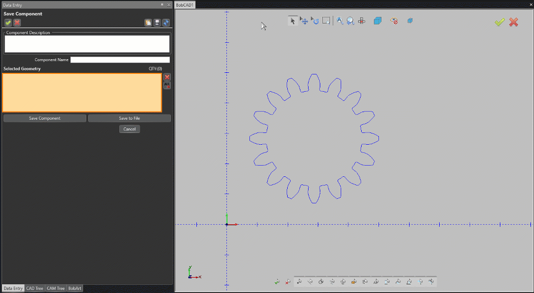

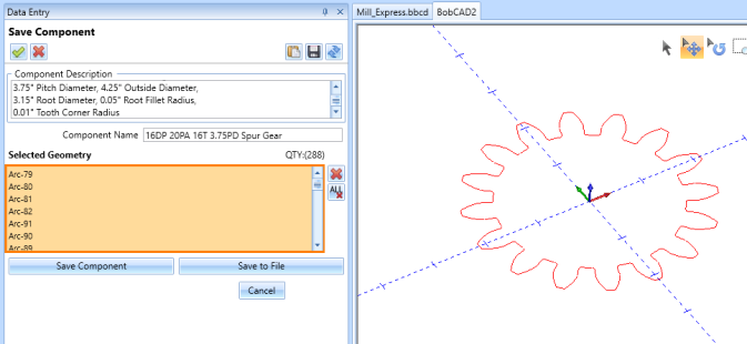

Component Library: Save, Reuse, and Speed Up Your CAD Workflow
Design smarter with the new Component Library, now available right on the "Home" tab. This powerful feature lets you easily save and reuse your own custom 2D or 3D geometry — helping you work faster and more consistently across projects.
With the Load Component tool, you can search through your library, preview your saved models, and drop them right into your workspace — complete with options to scale, rotate, and mirror as needed. You can even browse and load supported BobCAD file types from any folder, giving you complete flexibility.

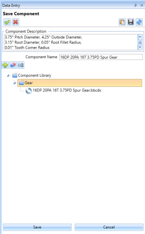

Creating reusable components is just as simple. Select geometry from the graphics area, use Save Component to name and describe it, and it’s ready to go for future projects. Saved components use the new .bbcdx format — a universal BobCAD format that works across multiple product lines.
Whether you’re building your own library of go-to parts or pulling in models from your file system, the Component Library helps you save time, standardize designs, and boost productivity.

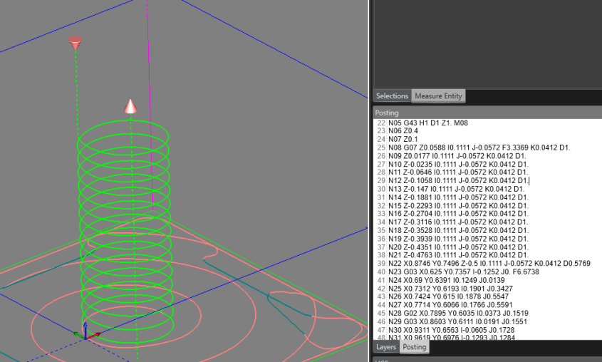

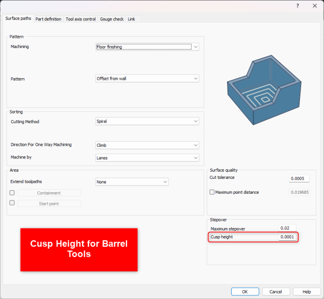

New CAM Toolpath Parameters
BobCAD-CAM V38 brings a wave of powerful improvements that make programming even more flexible, visual, and efficient.

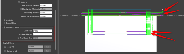

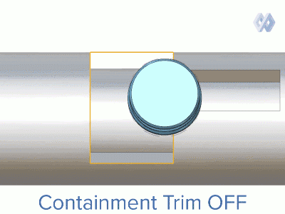

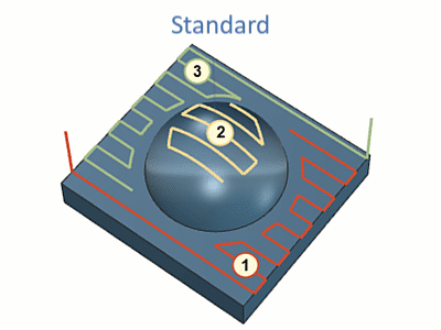

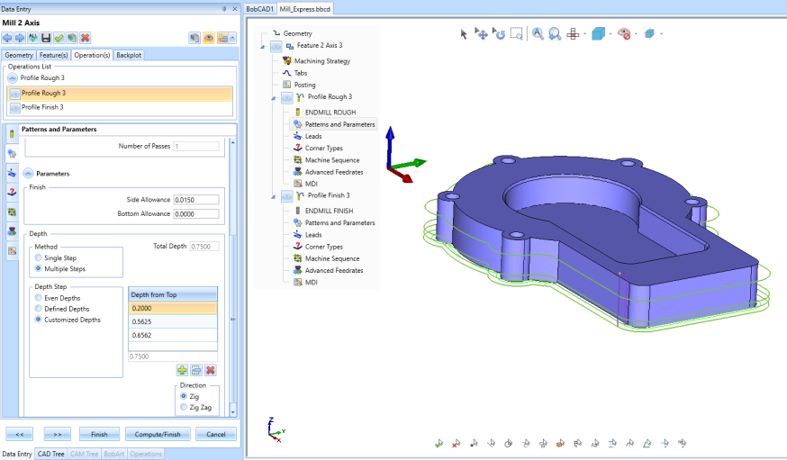

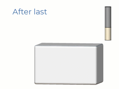

In Mill 2-Axis, you now have full control over your cut depths with the brand-new "Customized Depths" option. Rather than sticking to uniform depths, you can manually define each step exactly how you want it — perfect for using larger depths at the top of the profile and smaller depths at the bottom for precision control.

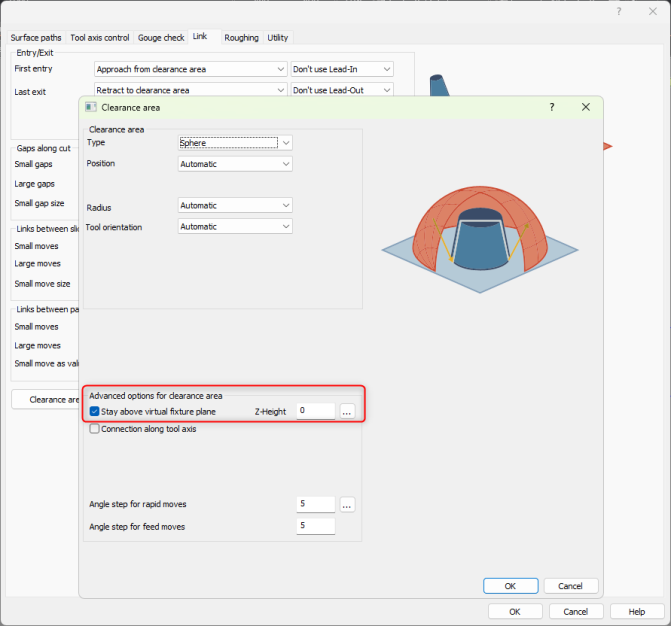

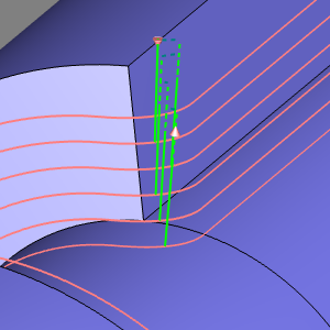

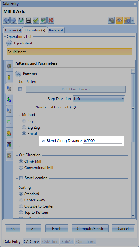

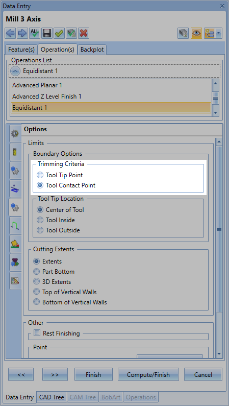

For Mill 3-Axis, Setting up Boundary constraints for the Operations just got a lot easier! The all-new "Boundary Options - Trimming Criteria" gives you a smarter, more accurate way to define machining areas. With the options of "Tool Tip Point" (Old Method) or "Tool Contact Point", you are able to easily cut along 3D surfaces in any X, Y, or Z direction. Instead of manually calculating and adjusting the boundary to where the tool hits, just let the system calculate it for you. The result? Your toolpath follows the actual contact point of the tool rather than over or under traveling, making setup faster and avoiding edge violations.

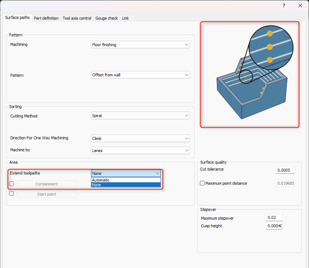

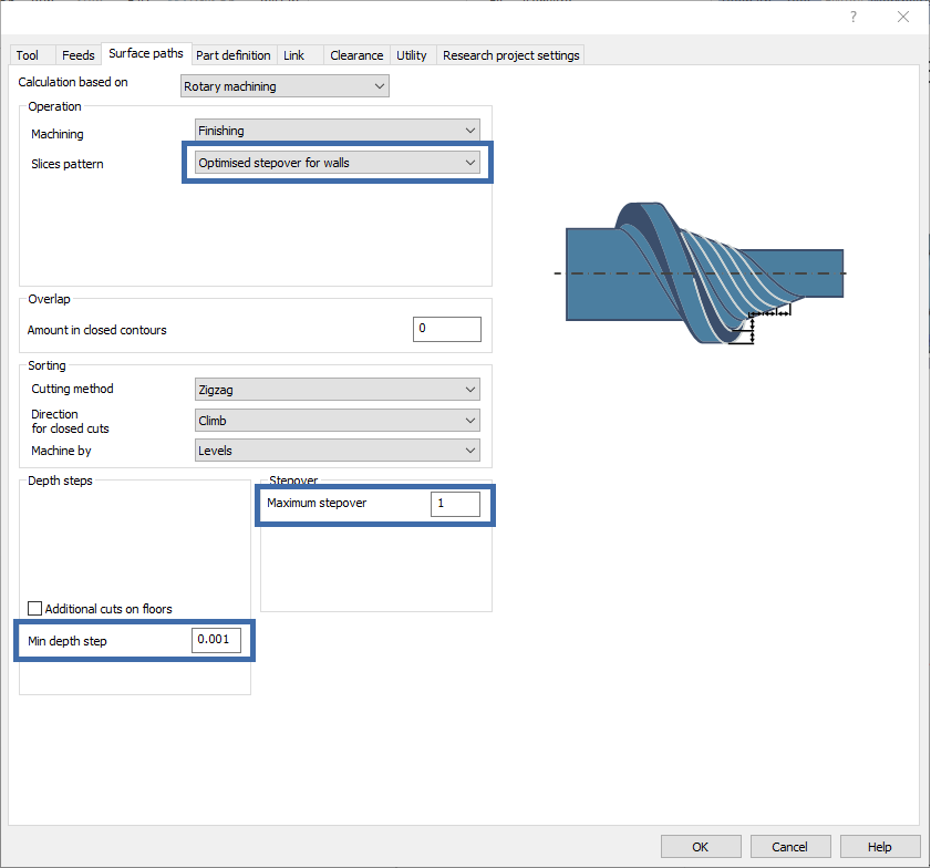

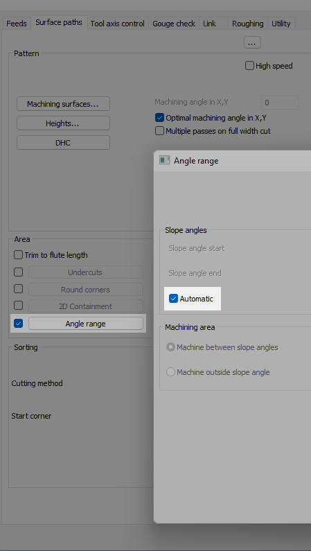

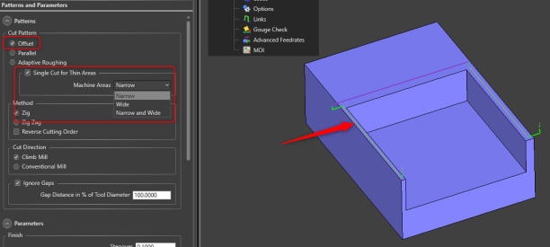

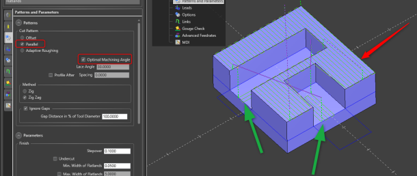

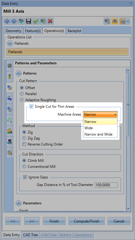

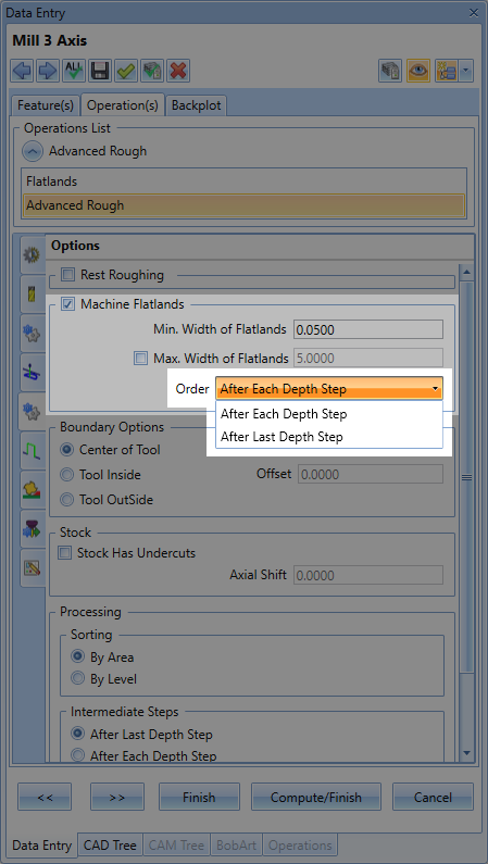

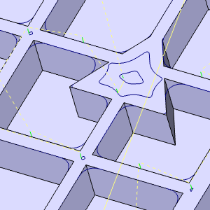

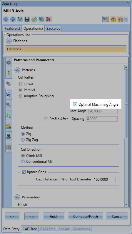

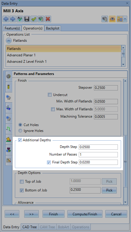

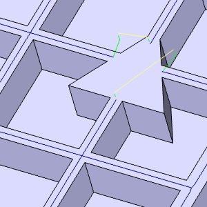

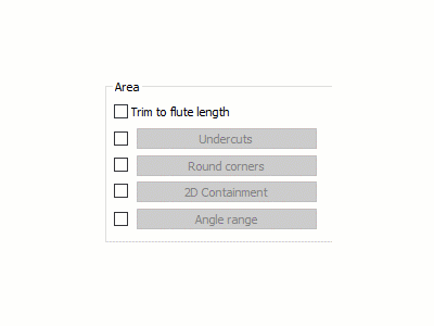

You’ll also see major gains in the Flatlands Operation, now upgraded with features like optimal XY machining angle, multi-pass depth control, and even an automatic single-pass strategy for thin areas. Combined with a smarter outside-in cutting order, these changes improve surface finish, tool life, and programming efficiency across the board.

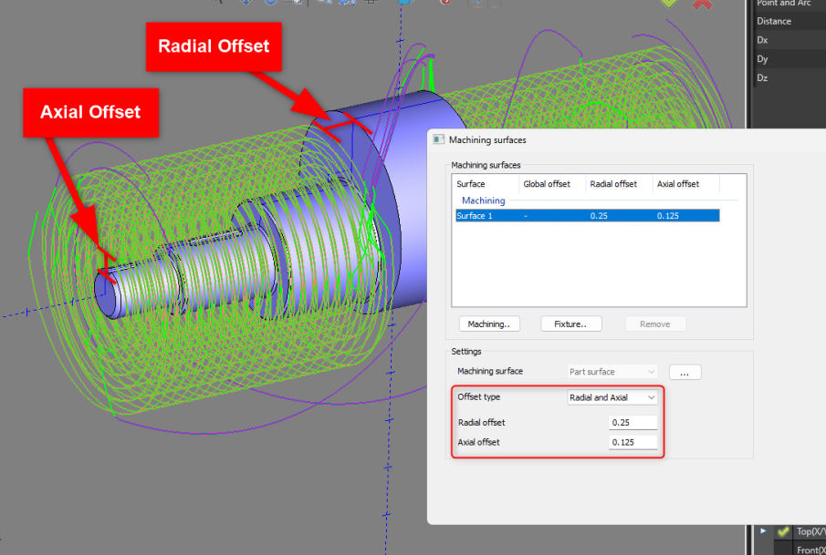

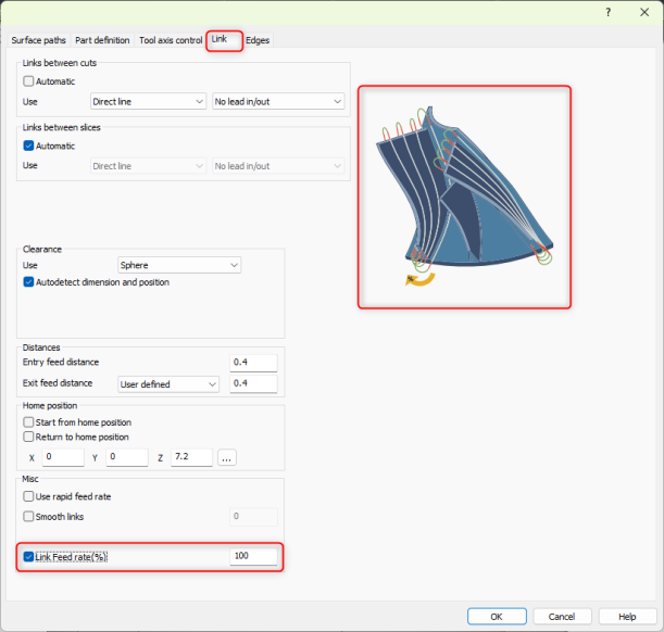

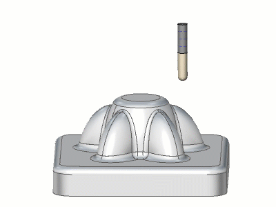

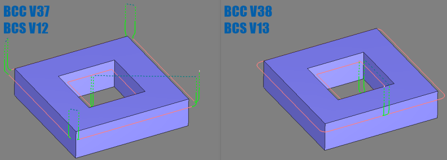

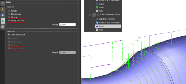

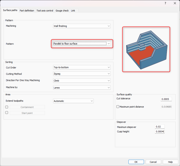

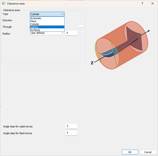

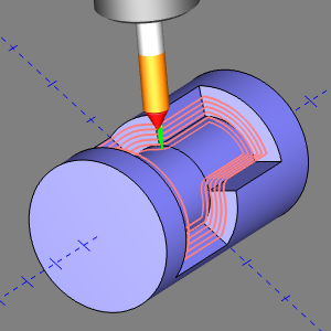

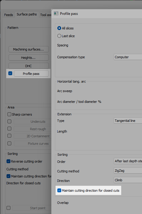

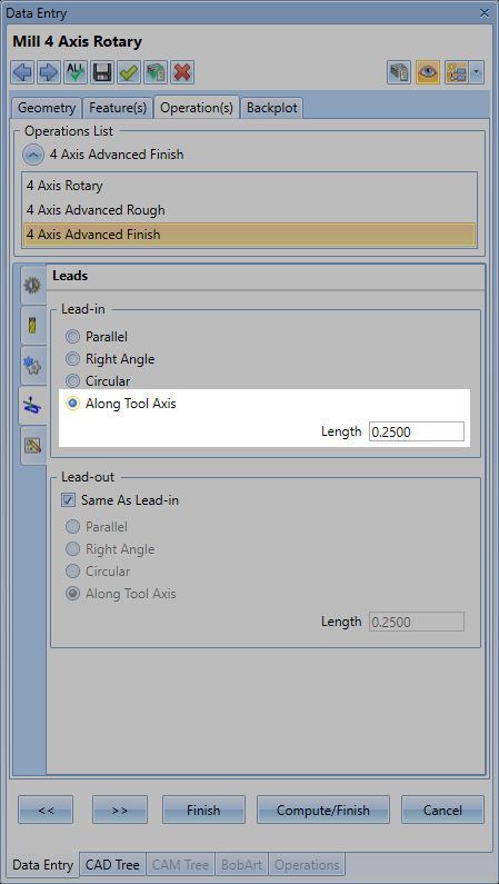

And for those working in 4-axis, the Advanced Finish operation just got a big boost with a new "Along Tool Axis" lead-in/out option. This gives you more control over how your tool enters and exits locking the tool orientation to the rotary axis, especially in complex geometries — reducing marks and improving part quality.

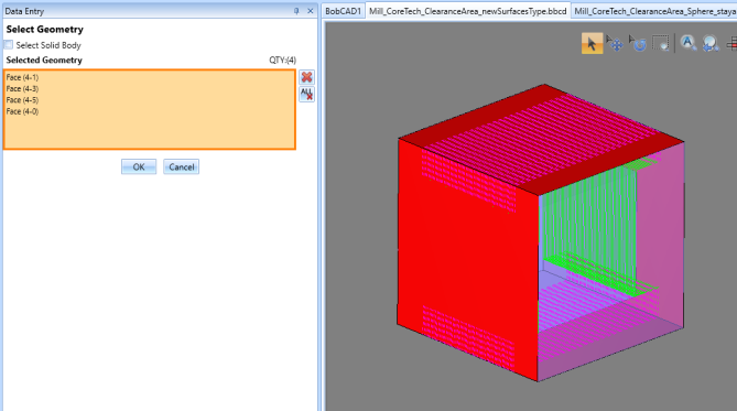

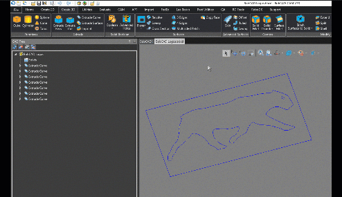

Pre-Selection for CAD Functions
Say goodbye to re-selecting geometry! In BobCAD-CAM V38, your CAD workflow is smoother than ever with Pre-Selection support.
Now, when you select geometry before launching a CAD function, the software keeps it selected — and immediately applies it to the function you open. That means less clicking, less repetition, and a much faster design experience.
As shown above, you can now pre-select a piece of geometry like a complex wireframe chain. When you go to “Extrude Curve,” for example, the preview now automatically activates using your pre-selected geometry. No need to reselect anything — it’s all ready to go.
This streamlined workflow also feels right at home for users familiar with other CAD systems, making BobCAD-CAM more intuitive.

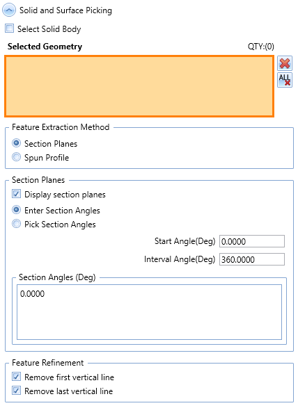

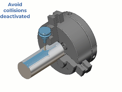

Smarter Lathe Picking - Now Works with Solids

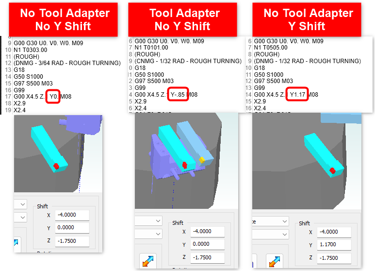

Lathe programming just got a major upgrade in BobCAD-CAM V38! You can now also select solids and surfaces directly when defining your Lathe features and the software will automatically convert them into a turn profile behind the scenes. Although you still can select wireframe geometry if desired, there is no more need to revolve or extract wireframe geometry first if you already have the solid model. This makes setup faster, easier, and far more intuitive, especially for users working from 3D models.
This new picking method matches the workflow in BobCAM for SolidWorks, creating a more seamless experience between the two platforms. Whether you're programming in BobCAD-CAM or inside SolidWorks, your Lathe workflow now feels familiar, consistent, and more efficient.

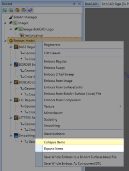

You can now collapse or expand all items in the Emboss Model BobArt Tree.
You can now right-click on an Emboss feature and rename the feature rather than previously where you would have to enter into the feature to change the name.

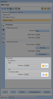

The buttons for the Distance parameter in the Extensions are now more clearly defined to easily distinguish between a percentage value and a absolute distance value . With the percentage toggle enabled, if a value of 50 is set with a tool diameter of 0.5 inch, the extension distance will be 0.25 inches. With the absolute distance toggle enabled, if a value of 0.25 is set, the extension distance will be 0.25 inches regardless of the tool diameter.
New CAM Wizard
The brand-new CAM Wizard is now built directly into the side panel, giving you a streamlined, modern workflow like never before. Unlike previous versions where you had to fully set the parameters and compute blind without seeing a visual, you can now set up your toolpaths while keeping full visibility of the graphics area — see exactly what you're creating in real time
This is the biggest UI upgrade in BobCAD-CAM V38— and it will streamline your workflow and the way you program.

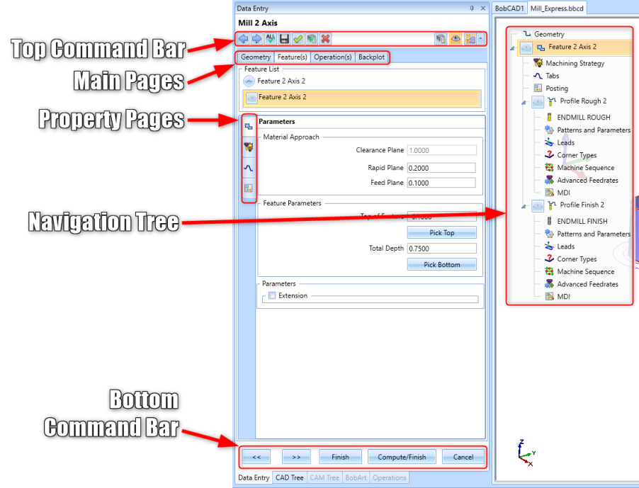

The Flow of the CAM Wizard
Components of the CAM Wizard
Top Command Bar
This Command Bar provides a quick way to access and adjust additional settings for the CAM Wizard. Use this bar to navigate the wizard, save default parameters, Compute Toolpath, and adjust the Navigation Tree.
These are the settings from left to right:
  • Previous - Go back a previous page
  • Next - Go forward to the next page
  • Apply to All Operations - Apply parameters on current page to all other Operations with the same parameters
  • Save Defaults - Dave Default Parameters to a template. Choose which Operations you want to save as well as if you want to save the feature page information (eg. Rapid/Feed Plane).
  • Finish - Finish the CAM Wizard by closing out of the wizard and retaining all information without computing toolpath
  • Compute/Finish - Finish and Compute the toolpath for the feature. This closes the wizard.
  • Cancel - Close out of the CAM Wizard without retaining any change you made to the feature
  • Compute Toolpath - Compute the toolpath of the currently active Operation you have selected in the Navigation Tree. The CAM Wizard will remain opened
  • Enable/Disable Preview - Blank/Unblank the currently active Operation in the Navigation Tree
  • Show/Hide Navigation Tree - Show or Hide the Navigation Tree
    • Collapse Navigation Tree - Collapse all items in the Navigation Tree
    • Expand Navigation Tree - Expand all items in the Navigation Tree
    • Switch Transparency - Switch between the Navigation Tree having a background of making it transparent
Main Pages
These pages contain all the parameters for the feature.
These are the pages listed from left to right:
  • Geometry - This page is used to select geometry for the feature
  • Feature(s) - This page contains the; Parameters page, Machining Strategy page, Tabs page, Posting page, and Multiaxis Post page. Setup initial parameters, the Operations you want to use, if you need tabs, and adjust any post settings for the g-code.
  • Operation(s) - This page contains the; UI Choice page, Tool Definition page, Patterns and Parameters page, Leads page, Options page, Links page, Corner Types page, Machine Sequence page, Advanced Feedrates page, and MDI page. This is the "meat & potatos" of the CAM Wizard. Setup all the main parameters of each Operation on this page from the tool used to the stepover, allowance, leads, number of steps and so much more...

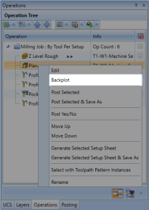

  • Backplot - This page allows you to simulate the motion of the tool while still inside the CAM Wizard to give you a good idea what the toolpath will look like. Just pick the Operation you want to view and hit the Play button. Note: For more detailed simulation, click "Start SImulation" in the Milling/Turning/Wire EDM/Mill Turn tab at the top ribbon to load our full simulation.
Property Pages
The property pages are the children of the main pages. These pages show up as tabs on the left-hand side of the CAM Wizard. They section off the data into segments to make it easier to work through. You will notice a similar naming convention for these pages from the previous versions of the software.
  • Feature(s) (Main Page):
    • Parameters - Setup general parameters for the Operation like: Clearance, Rapid, Feed Plane; Top of Feature, Total Depth; Extensions
    • Machining Strategy - Setup any number of Operations you want to use in the Feature.
    • Tabs - Add tabs to your profile to hold the stock in place. Primarily used for Mill 2-axis Profiles with CNC routers

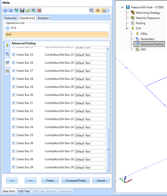

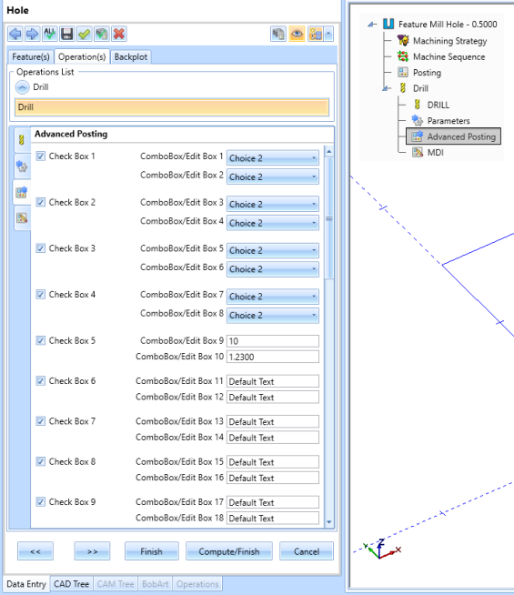

    • Posting - Gives more control of the g-code posting modes and parameters such as defining: Work Offset number; Posting Mode and Submachine selection (For Mill-Turn)
    • Multiaxis Post - Give more control of the g-code posting sequence and parameters such as defining: Angle Pair solutions; Machine Limits; Pole Handling; Tool Repositioning; setting TCP or other Move List Coordinates
  • Operation(s) (Main Page):

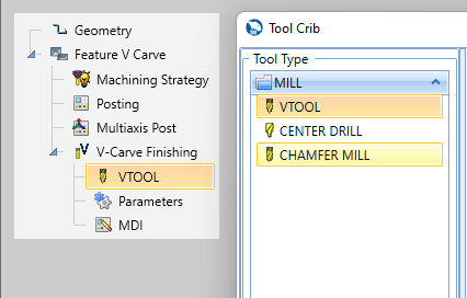

    • UI Choice - Set "Standard UI" or "Advanced UI" to expose all of the ModuleWorks toolpath options available. This page is only available for Operations that have ModuleWorks User Interfaces (Eg. Advanced Rough, Equidistant).
    • Tool Definition - Setup the tool used for the Operation, open the Tool Crib, and adjust dimensions if needed.

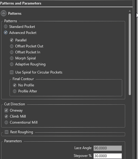

    • Patterns and Parameters - Setup all the main parameters of the Operation such as defining: Cut Pattern/Direction; Depth of Cut and Stepover; Allowance; Top/Bottom of Job

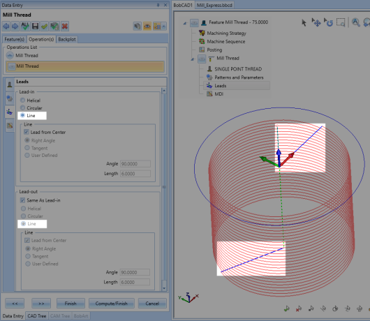

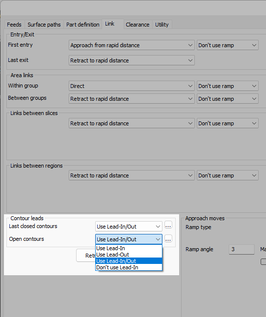

    • Leads - Setup the Entry/Exit type as well as the Lead-in/out for the Operation

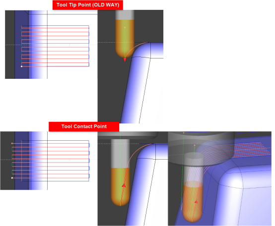

    • Options - Setup parameters like: Cutting Extents and tool point of calculation
    • Links - Define how the toolpath links between cuts
    • Corner Types - Define how to handle corners on profiles: Rounded, Sharp, Loop Radius, etc...
    • Machine Sequence - Define how the order of multiple geometries are processed.
    • Advanced Feedrates - Gives more control over the feedrates and provides options such as: Convert Rapids to Feeds; Lead-in/out feedrate percentage; Corner Slowdown; Adaptive (Volume Based) or Radial Chip Thinning Feedrates
    • MDI - Define and Setup custom M and G Code commands used before or after a tool change, or after an operation. Examples could be: Adding Optional Stop after Operation; Adding a Part Transfer routine for a Mill-Turn machine; Adding special Macro B programming calls

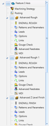

Navigation Tree
The Navigation Tree and used to quickly move through the CAM Wizard providing a easy visual of all the pages in the feature. Simply click on the icon/title of the page that you want to go to and the CAM Wizard will load that page.
The navigation tree also has the ability to Blank or Unblank a toolpath operation. Blanking out a operation can help you focus on a specific operation while editing the parameters so that the other toolpaths are not in the way. Alternatively, if you always want this behavior of blanking out Operations and only viewing the toolpath of the current Operation you are working on, you can go to Settings > System > CAM and enable "Auto Blank New Items". This will automatically balnk out Operations as they get created. Then, whatever Toolpath Operation is actively selected in the Navigation Tree will be shown in the graphics area.
You might also notice that the Navigation Tree will sometimes give you a "Need to compute toolpath!" flag (shown here: ). Mill 2-axix, Lathe, and Wire EDM operations will compute automatically. However, the Mill 3-Axis and Mill 2-Axis Adaptive Roughing Operations will need to be computed by either pressing the Compute Toolpath icon in the Top Command Bar to stay in the CAM Wizard or hitting "Compute/Finish" at the Bottom Command Bar to exit the CAM Wizard.
You can also control the whether or not you even want to see the Navigation Tree by clicking the Show/Hide Navigation Tree (pictured in the top left here: ) button in the Top Command Bar. Use the drop-down arrow of this button to collapse/expand the Navigation Tree items and toggle off and on the background transparency of the Navigation Tree.
Bottom Command Bar
This bar serves as the main navigation and compute tool of the CAM Wizard. Similar to the CAM Wizard in the previous versions of the software, this command bar allows you to progress through each page, finish and close the Wizard without computing any additional toolpath, Compute and close the CAM Wizard and cancel out of the Wizard without saving any information.
These are the buttons from left to right:
  • Previous - Go back a page
  • Finish - Close the CAM Wizard and save all information. The Feature will be created in the CAM Tree without any additional toolpath being computed
  • Compute/Finish - Close the CAM Wizard and compute all toolpath. The Feature will be created in the CAM Tree with all Operations getting computed
  • Cancel - Close the CAM Wziard and DO NOT save any data at all. If you started a new Feature, no CAM Tree feature would get created. If you are editing an existing Feature, no changes will be made to the parameters and it will return to the original state it was in before entering into the Feature.
Contextual Help for CAM
The new version brings the Contextual Help pop-up to the CAM parameters! In the previous version these pop-ups are shown in the CAD functions when you hoover over a parameter. Now, in the new version, this Contextual Help shows up in the new CAM Wizard. Simply hoover your cursor over a parameter name and wait for the Contextual Help to pop-up (See below)
These are the sections from top to bottom:
  • Image - An image showing an example of the parameter sometimes with visual aids to help understand where the parameter is used in the toolpath
  • Short Description - A short description describing what the parameter is
  • Open Help System - A link that opens either the Online Help System or local Help System to the page the parameter is.
With the new version comes a new setting for the Contextual Help called the "Context Help Delay Time". This allows you to setup the delay that the contextual help will pop-up when you hoover over a parameter. Choose between 0.25 seconds - 2 seconds delay.
As you could in the previous version, you still have the ability to enable/disable this pop-up if you understand what you are doing and the pop-up gets in the way. Just click the Enable/Disable Contextual Help button at the bottom right corner of the software.

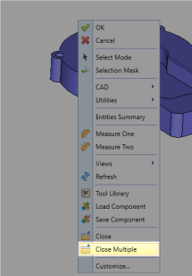

Close Multiple Documents inside of BobCAD-CAM
There is now a new function in the Context Menu when you right-click inside the graphics area that allows you to multiple documents at once.
When clicked, a dialog box will pop-up and allow you to choose from: Close All; Close All BUT Current; Close All Unchanged; Close All to the Left; Close All to the right.
If a document(s) is unsaved, you will be prompted if you want to Save. There are additional buttons, "Yes to All", "No to All" to save all files at once.

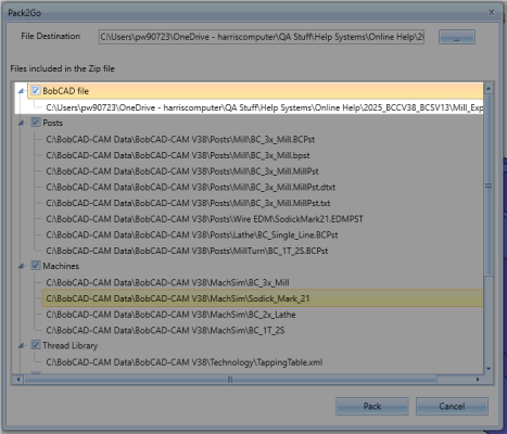

Pack2Go: Exclude The Main Part File From the Pack2Go Zipped Folder
Inside the Pack2Go dialog, it is now possible to uncheck the BobCAD file and Pack the files without including the main file. This was primarily added to make it easier to transfer just Post Processors from computer to computer.
NOTE: As an additional note about the Pack2Go function, the software will now prompt you to save as a BobCAD File (.bbcd) when clicking Pack2Go if you have yet to save the file as a BBCD file already. This is to avoid lost data like the CAM Tree info which is stored in the .bbcd file type.

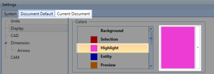

Settings
The Line Thickness Scale Option in the Print dialog now retains the previously held value when closing and reopening the software.
A big update to the CAD package is the introduction of user defined CAD Default Parameters! Based on popular feedback from users, may users wanted the ability to set their own default values for the CAD functions to align closer to the dimensions they use for their specific application. You can set up Default values for all the CAD functions inside the "Create 2D", "Create 3D", "Utlities", and "Evaluate" tabs. (eg. Arc, Line, Shape Library, Extrude Functions, Dimensions). At the top right of each functions page, you will now see 3 buttons: Load Default, Save Default, Reset to Factory Default. You can setup separate CAD parameters for Inch or Metric Units. Just set the units at the bottom right of the software before saving a default.

  • Load Default - This button loads in the currently saved User-defined default values. If user-defined values were not set up, it will load the factory default values
  • Save Default - This button saves the entirety of the input values on the currently opened CAD function. This includes saving data such as, text fields, radio buttons and toggles. Note: it does not save any selected geometry. Just the parameters for that function.
  • Reset to Factory Default - This reverts the defaults back to the factory values. If you have "Load Default" after hitting this factory reset button, It will load the default values that come built into the software.
You can also use the Migration Tool (File > Migration) to bring these settings over to other BobCAD-CAM software or computers.

The NEW Component Library
BobCAD-CAM V38 introduces the all new Component Library! This new library introduces the ability for users to setup and define a library of their own CAD geometries. There are two functions to Load and Save geometry into the Component Library: Load Component, Save Component found on the "Home" tab in the top ribbon. You can now store common geometries that you use all the time and access them quickly. The Component Library functions allow you to save or bring in geometries (also called, "components") from the current file you have opened. Browse the library, see a preview, see title and description, and load in the components using all the familiar transform functions that you know and love such as set origin location, scale, mirror, and rotate.
Additionally, as you are saving/loading the components, you have the ability to choose from "Save/Load Component" or "Save/Load to File".
  • The "Save/Load Component" button, you are using the Component Library file directory built into BobCAD-CAM found here: C:\BobCAD-CAM Data\BobCAD-CAM V38\Component Library with the advantage of being able to use the Migration tool to bring the library over to new or other BobCAD-CAM software.
  • The "Save/Load to File" button, pulls up a file explorer and allows you to store your library anywhere on your computer if you have our own file directory that you want to store the components in.
Save Component
The Save Component function found on the "Home" tab allows you to save any piece of geometry in the current document into the Component Library. Simply click "Save Component", select your geometry in the graphics area, setup a desired name and description and hit, "Save Component" or "Save to file". If "Save Component" is selected, a new dialog will pop up shown below where you can define where specifically you want to save the component in the library. If "Save to file" is selected, it will load a file explorer where you can pick the location of where you want to save the component on your computer. Once saved, a bbcdx file (a universal BobCAD format that works across multiple product lines) will be saved to the location set by the user.
Initial Save Component Dialog
These are the options from top to bottom:
  • Component Description - A multi-line text field that allows you to setup a description of the component
  • Component Name - The name of the component that shows up when searching through the library. Note: This will be the .bbcdx file name which follows the same rule of standard file names in Windows. You can not use the following characters: \ / : * ? " < > |
  • Selected Geometry - While this box is active, select geometry in the graphics area and this box will populate with all the geometry to save
  • Save Component - loads the "Save Component" dialog below. If you want to save the components in the built-in library, click this button
  • Save to File - loads a Windows File Explorer to save the component to your own file directory. If you want to save the components to an external folder location, click the button.
  • Cancel - Click this button to cancel out of the function without saving anything
Save Component Button Dialog
  • Component Description - Retains the description set in the previous dialog, but allows you to update on the dialog if needed
  • Component Name - Retains the name set in the previous dialog, but allows you to update on the dialog if needed
  • New Component Group - Create a new folder to save the component into
  • Delete - Deletes the selected item in the tree
  • Rename - Rename the currently selected Component or Component Group
  • Component Library Folder - The root directory where all the components are stored inside of
  • Save - Saves the current component
  • Cancel - Cancel out of the function without saving anything
Load Component
The Load Component function found on the "Home" tab allows you to load any piece of geometry into the current document from the Component Library. Simply click "Load Component", select the component from the "Load Component" or "Load File" button, and place the component into the graphics area by using the "Location and Size" and "Orientation" sections to adjust the component and/or click inside the graphics area to place it manually. Then, click "OK" at the bottom to confirm it.
Load Component Setup Dialog
  • Load Component - Opens the "Load Component" dialog. Click this button if you are loading in a component directly from the built-in Component Library
  • Load File - loads a Windows File Explorer to load the component from your own file directory. If you want to load in components from an external folder location, click the button.
  • Component Name / Description - Once a component is selected, the Name and Description will show up here
  • Origin - Allows you to set the origin inside the graphics area. the X, Y, and Z fields move the whole component and position the origin in the location. To adjust the location of the origin point (In relation to the component), Use the drop-down box to select from: Center, Bottom Left, Bottom Center, Bottom Right, Right Center, Top Right, Top Center, Top Left, Left Center. Note: If you need to set the Origin to a custom specific location, follow the steps below under "Custom Place the Component into the Graphics Area".
  • Scale Factors - Scale the component in the XYZ direction
  • Rotation Angle Around Axis - Rotates the component around the Z, X, and/or Y directions relative to the component origin
  • Mirror - Mirror the component about the Y-Z Plane, X-Z Plane, or X-Y Plane relative to the component origin
  • OK - Click OK to execute the placement of the component
  • Cancel - Cancel out of the function without placing the component into the graphics area
Load Component Button Dialog
  • Open - Click OK to confirm the currently selected component
Custom Place the Component into the Graphics Area:
It is also possible to place the origin in a specific user-defined location other than the options shown in the Origin section. This can be done by first placing the component into the graphics area by left-clicking. Then, hoover your cursor over the desired area you want to place the origin and click on a snap point that shows up. Note: You need some sort of reference geometry in the graphics area to select. You should now be able to drag the component freely around the graphics area. Now, you can simply click again to place the component in the desired location.
You can also use the Migration Tool (File > Migration) to bring this Component Library over to other BobCAD-CAM software or computers.

In addition to the new CAD Default Parameters, there are also CAD functions that now retain their previous values when closing and reopening the function. Some CAD functions had this capability in the previous version. However, more CAD functions such as the Entity and Shape functions (Point, Line, Arc, Rectangle) now also retain the previous set value in the current document.
Pre-selection Of Geometry When Entering Into A CAD Function
Another major feature added to BobCAD-CAM V38 to the ability to pre-select geometry as shown in the videos below. It is now possible to select geometry before entering into a CAD function. Once, you open a CAD function, the software will maintain the selections of all relevant selected geometries for the function. This helps the workflow of users who have used other CAD software previously that had this capability. Where those users may have accidentally selected geometry before entering into the function and got frustrated because they had to re-select geometry again, the issue is now gone for good! Also, if you selected a large chain of geometry, but forgot to enter into the function first, you also no longer have to worry! Simply click on the function and the pre-selected geometry will be maintained.
 Example Extrude Curve Function:
 Example Spline with "Multi-Picking" used as User-Defined Saved Default
 Example Auto Dimension (Observe the de-selection of the Radius dimension even though it was selected)
The New Wrap CAD Function
The new Wrap CAD function allows you wrap geometry (Lines, Arcs, Splines, Text, Hole Patterns, Surfaces) around a cylinder. This works very similar to the Wrapping Group function used in CAM to wrap toolpath around a cylinder. The difference is this wraps CAD geometry. Select your geometry and set the "Wrapping Diameter". It will then place the geometry wrapped in the correct placement based on the XY position of the geometry. There is no need to setup a 3d cylinder. This function works with only needing to select the geometry. If you select a surface as the Selected Geometry, the software will extract the edges of the surface and wrap that wireframe geometry around the cylinder.
Note: The Z height of the selected geometry is ignored and the "Wrapping Diameter" is used instead of assign the correct height around the cylinder.
  • Selected Geometry - Select the geometry (Lines, Arcs, Splines, Text, Hole Patterns, Surfaces) in the graphics area. If you select a surface as the Selected Geometry, the software will extract the edges of the surface and wrap that wireframe geometry around the cylinder.
  • Wrapping Diameter - The Diameter of the wrapped geometry around the center axis defined in the "Center Axis" section
  • Wrapping Tolerance - The tolerance of the wrapped geometry. A lower number results in a more accurate geometry, but more entities are possible. A higher number results in looser tolerance or less accurate result, but typically less entities
  • Zero Degree Location - Adjust where the start of the wrapped geometry references (Units in Degrees). If you want to move the wrapped geometry around the cylinder in a different location, adjust this value.
  • Arc Fit - With Arc Fit enabled, The resulting wrapped geometry will creates arcs if possible. If Disabled, the results geometry will be lines only.
  • Reverse Wrapping Direction - This is used to adjust whether you want to wrapped geometry on the interior or exterior of the cylinder. For example, if you are wrapping words: If unchecked, the words will be readable when looking at the cylinder from the outside. If Checked, the words will be readable when looking from inside the cylinder.
  • Center Axis - This section is used to adjust the center of rotation of the wrapped geometry. To find the center of rotation, you need two points. A start point and end point. With these two points defined, the software draws a line to connect them and uses that as the center of rotation to rotate the wrapping geometry around. In this dialog, the "Origin" X, Y and Z fields define the start point and the "Direction" defines the end point. Based on the options selected, there are many different ways to find these two points.
    • Pick Axis - When enabled, a "Selected Center Axis" box will show up and you can then select a line in the graphics area as your center of rotation. The "Origin" and "Direction" boxes will grey out and the start and end points of the line selected are used. When disabled, there will be a Along Axis Drop-Down box where you can set: Along X Axis (Will auto set "Direction" to an end point of X1), Along Y Axis (Will auto set "Direction" to an end point of Y1), Along Z Axis (Will auto set "Direction" to an end point of Z1), Customized Axis.
    • Origin - Set the start point of the center of rotation. Greyed out when: Pick Axis or Customized Axis is selected.
    • Direction - Define the end point of the center of rotation. If Customized Axis is selected, the "Direction" X, Y and Z fields will un-grey and you can manually select these values.

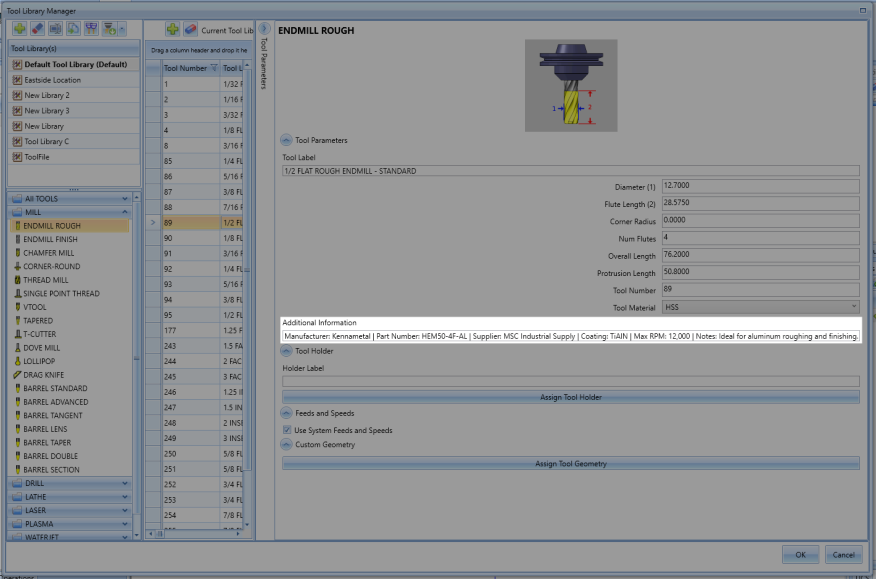

Additional Information Parameter for Tools
There is a new text field when you are editing a tool in the Tool Library to set up "Additional Information". Now store info about the tool such as Manufacturer, Part Number, etc...
Example Additional Information:
Manufacturer: Kennametal | Part Number: HEM50-4F-AL | Supplier: MSC Industrial Supply | Coating: TiAlN | Max RPM: 12,000 | Notes: Ideal for aluminum roughing and finishing.
Auto Rename All Names In The CAM Tree
There is a new option when you right-click on the Machine Setup or Job in the CAM Tree to "Auto Rename All". This tool finds any names that are identical and appends the name with a number so that each name is unique. The new CAM Wizard does already auto-rename the Operations. However, this can be used if you are opening an existing file.

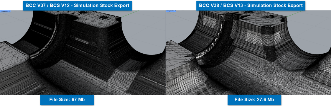

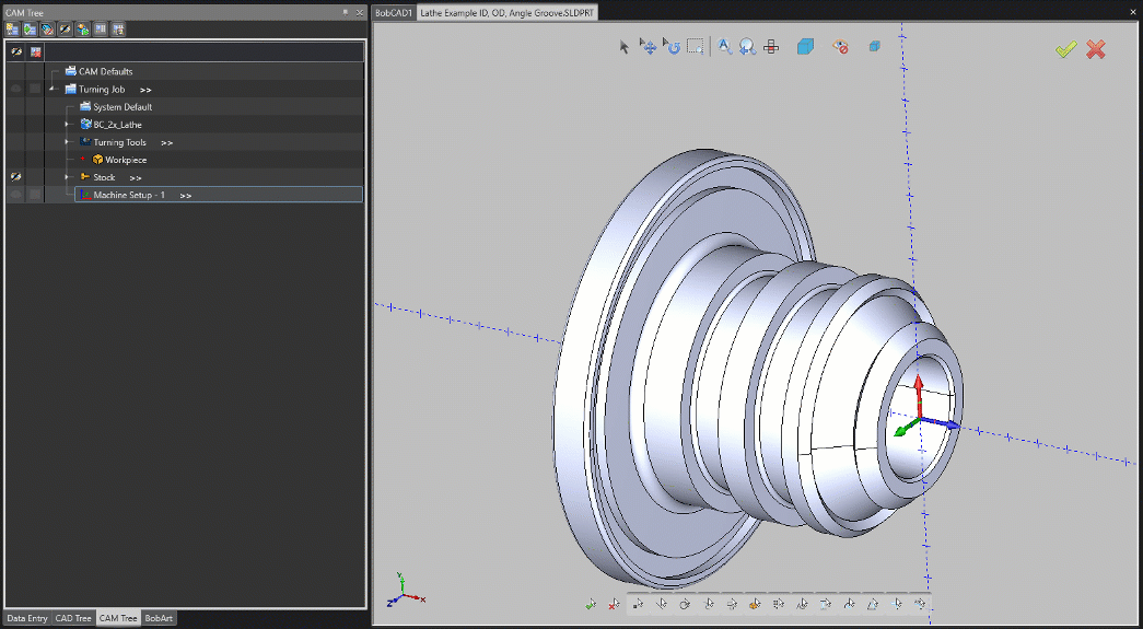

New ModuleWorks MDES File Format
An MDES file is a machine description file that defines the kinematics, geometry, and behavior of CNC machines for use in ModuleWorks-powered simulations. The MDES format is a proprietary file type developed by ModuleWorks. It is primarily used for defining machine descriptions within CAM (Computer-Aided Manufacturing) environments. MDES files contain all the data necessary to describe a CNC machine’s kinematics, structure, and behavior that are essential for machine simulation and collision detection during toolpath verification.
An MDES file includes:
  • Machine Structure – Definition of machine components (axes, tables, spindles, turrets, etc.)
  • Kinematics – Motion relationships between axes (rotational, translational, linear axes)
  • Geometry – Simplified 3D models of machine parts used for simulation
  • Limits & Constraints – Axis travel ranges, speeds, and restrictions
  • Tool Holder & Workpiece Setup – Information needed for accurate simulation and collision checking
Usage
  • ModuleWorks-powered Simulation – Ensures realistic movement of CNC machines during virtual toolpath execution.
  • Collision Detection – Prevents tool crashes by analyzing tool, holder, and machine interactions.
  • Verification & Training – Provides a safe environment to test machining strategies before running them on a physical machine.
To learn more about this new file format, navigate to the official ModuleWorks website: https://www.mdes.info/en/

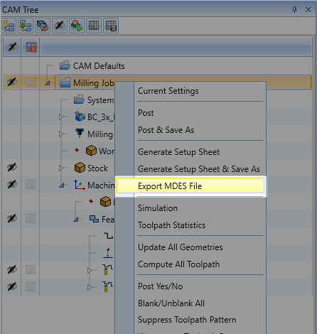

To export a CAM Job as a MDES file type, in the CAM Tree, right-click on the Job name and select, "Export MDES File".

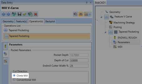

The "Tapered Pocketing" Operation found in the "Mill V Carve" feature has a new option to set the Cut Direction to "Climb Mill".
There is now an arrow that displays in the middle of each toolpath entity when backplotting. The size of this arrow as well as disabling/enabling it can be found in the Backplot dialog under "Show Direction Arrow".
There is now a different color for highlighting the current toolpath you have selected to make to easier to differentiate between the selected toolpath and the other toolpaths showing in the graphics area.
You can now right-click on an Operation in the Operation Tree and get to the "Backplot" dialog from this tree.
Customized Depths - Vary The Depths Between Each Depth Cut
You can now setup variable depth of cuts in the Mill 2-Axis Operations. This gives you the ability to be able to setup larger gaps towards to top of the part and smaller gaps at the bottom when trying to finish the part or any variation in between the top and bottom of job.
  • Add - Add a depth cut. The default value splits the distance between the previous depth cut and the bottom of job
  • Insert - Insert a depth below the selected Depth. The default value splits the distance between the previous depth cut and the next depth cut
  • Move Up - Deletes the selected depth cut

Mill Thread
You can now select a "Line" lead in/out for the Mill Thread Operation Leads.

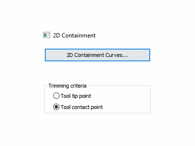

Tool Tip Point and Tool Contact Point
New boundary trimming options—Tool Tip Point and Tool Contact Point—have been added to the Advanced Planar, Advanced Z Level Finish, and Equidistant toolpaths, giving users finer control over how toolpaths are trimmed to containment curves. These options allow users to choose whether the boundary is respected based on the position of the tool’s tip or its contact point with the surface. This enhancement is especially useful when working near containment edges, improving precision and efficiency when processing cusps and surface transitions, especially in triangle mesh-based toolpaths.

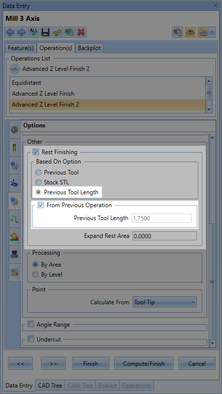

Rest Finishing By Previous Tool Length
A new By Tool Length option has been added to the Rest Finishing settings in Advanced Z Level Finish, Advanced Planar, and Steep Shallow operations. This enhancement detects and removes remaining material that previous tools couldn't reach due to limited stick-out or flute length. By dividing the toolpath into zones based on the previous tool’s usable length, this feature improves surface quality, enhances feed control, and ensures better access to deep or restricted areas without manual cleanup.

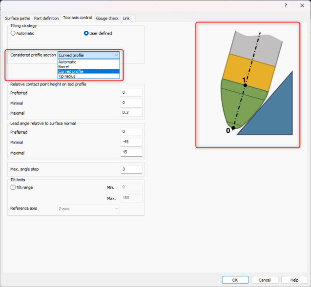

Automatic Angle Range Detection for Barrel Tools
A new Automatic option has been added to the Angle Range section for the Advanced Z Level Finish, Advanced Planar, and Equidistant toolpaths (Advanced UI only). When using supported barrel tools—Lens, Double Profile, and Tangent to Shaft—this enhancement intelligently detects which areas of the part can be machined in 3-axis and automatically sets appropriate slope angles based on the tool’s geometry. This helps improve surface quality while reducing setup time and user input. Toolpath focus adapts based on the tool and strategy: walls are favored in Advanced Z Level Finish, while floors are prioritized in Advanced Planar and Equidistant.

After Each Depth Step and After Last Depth Step
A new Order option has been added to the Flatlands feature within the Advanced Rough operation, giving users greater control over when flat areas are finished during roughing. Users can now choose to machine flat regions either After Each Depth Step, where flats exposed at each step are cleaned up immediately, or After Last Depth Step, where all flat areas are finished in one pass after full roughing is complete. This flexibility improves machining efficiency and part quality by allowing Flatlands to be applied exactly when needed.

Maintain Cutting Direction for Closed Cuts
The Advanced Roughing toolpath now includes a Maintain Cutting Direction for Closed Profile Passes option, giving users greater control over tool engagement in closed-loop regions. When enabled, the system preserves the selected cutting direction—climb or conventional—throughout each closed profile. For open areas, a zig-zag approach is still used to optimize link lengths and reduce machining time. This blend of precision and efficiency enhances both part quality and cycle performance in Advanced UI workflows.

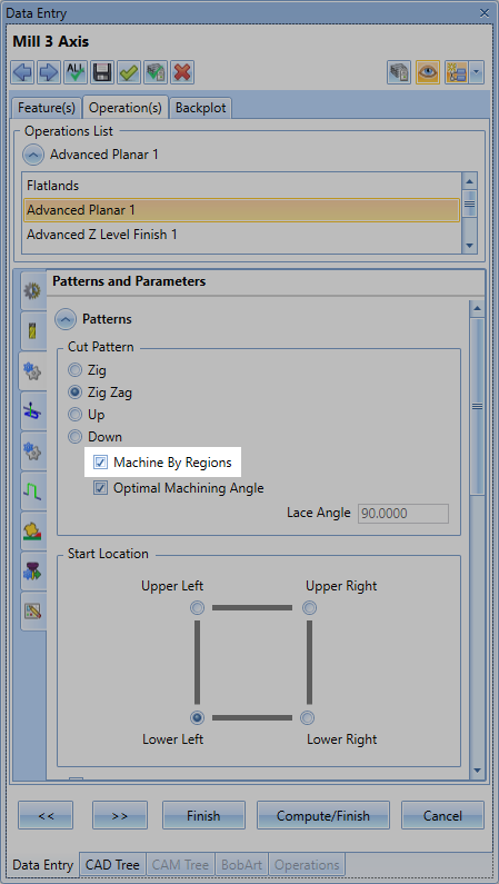

Machine by Regions
The Parallel Cuts pattern now supports Machine by Regions, a new ordering method that completes one region at a time before moving to the next. This approach eliminates unnecessary engages and retracts within a region, resulting in improved surface quality and smoother motion. Offered alongside the traditional shortest path option, this feature gives users more control over toolpath behavior in complex geometries.
Equidistant
Blend Along Distance
The Equidistant operation now includes a Blend Along Distance option for Spiral patterns, offering a new way to create smooth, continuous motion across the surface—similar to Spiral behavior, but with the flexibility of a Zig pattern. Rather than linking separate passes with abrupt transitions, this option blends between them over a defined distance, creating fluid shifts where one pass transitions into the next. It’s ideal for complex areas where traditional Zig motion may introduce sharp linking moves, delivering improved surface finish and a more refined toolpath across both flat and contoured surfaces.

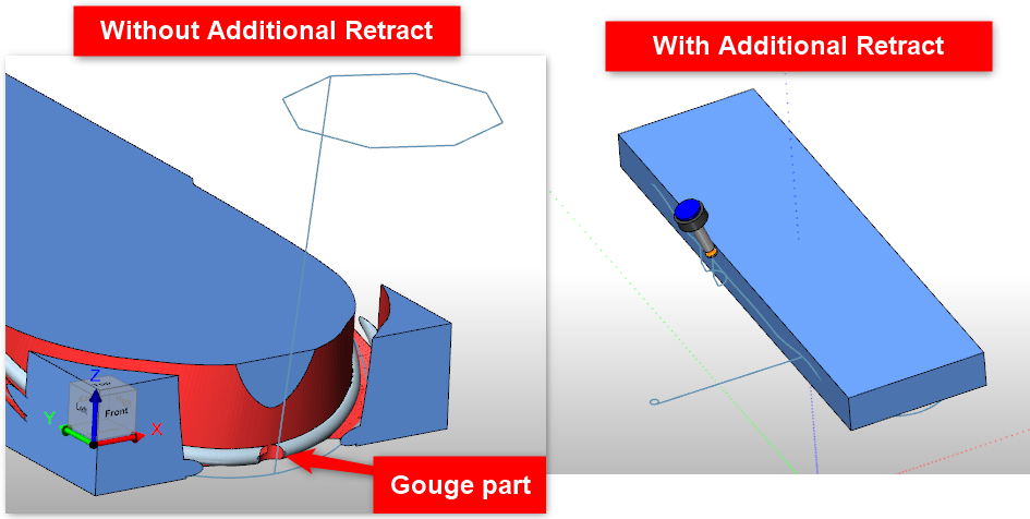

Flatlands
Additional Depths
The Flatlands operation now includes an Additional Depths option, designed to improve control when machining thicker stock. Instead of cutting flat areas in a single pass, users can now divide the motion into multiple depth steps for more efficient and safer roughing. This group includes options to define a consistent Depth Step, set a specific Number of Passes, and an option to enable a Final Depth Step to apply a lighter finishing cut at the bottom. These enhancements give users greater flexibility when managing material removal and tool load on flat regions.
Single Cut for Thin Areas
Single Cut for Thin Areas improves toolpath efficiency by applying an optimized algorithm that reduces travel, especially in tight regions where multiple offset passes aren’t needed. This checkbox enables a streamlined approach in areas smaller than the tool diameter, offering three targeted options—Narrow, Wide, and Narrow and Wide. The Narrow option traces along tight regions with a single pass, Wide skips unnecessary cuts and applies shaped offsets to broader areas, and Narrow and Wide combines both strategies. This added control leads to cleaner, faster results in challenging flatland geometry.
Previous AlgorithmNarrowWideNarrow and Wide
Optimal Machining Angle
The Flatlands strategy now includes Optimal XY Angle, a powerful toolpath enhancement originally introduced in Planar. This feature intelligently aligns parallel passes with the longest dimension of each machined area, optimizing cut direction for improved efficiency and surface quality. By allowing independent angle adjustments across different regions, it maximizes material removal and minimizes air cutting—bringing smarter, faster machining to flat features with complex shapes.
Outside-in Ordering Enhancements
Flatland toolpaths now benefit from an automatic outside-in ordering strategy that optimizes pass direction without requiring user input. By starting from the outer edges and working inward, this improvement reduces top-down engagement on the material surface—resulting in better surface quality and significantly extended tool life. This behind-the-scenes enhancement delivers smarter motion for cleaner, more efficient flatland machining.
V-Carve
Spot Drill and Chamfer Mill support for V-Carve
The V-Carve toolpath in BobART now supports Spot Drills and Chamfer Mill tools, giving users greater flexibility when selecting tooling for artistic and engraving-style operations. This enhancement expands beyond traditional V-style tools, allowing for more control over edge detail, engraving depth, and finish quality. Whether you're creating decorative features or functional markings, the ability to use these tool types adds precision and efficiency to your BobART workflows.

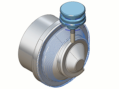

Rotary Machining

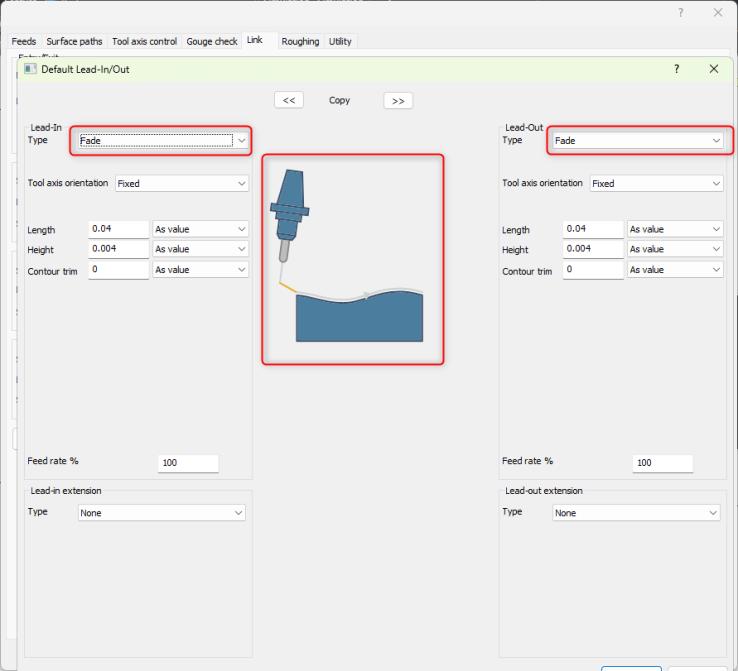

Leads for Roughing
A new Leads for Roughing option has been added to rotary machining toolpaths in the Advanced UI, allowing users to apply lead-in and lead-out motions to roughing operations. These additional moves enable smoother tool engagement and exit, reducing the risk of tool shock and improving material removal quality. This enhancement brings more control and reliability to rotary roughing strategies, especially in complex geometries where clean entry and exit paths are critical.
Leads for Finishing
The Cylindrical or Conical Surfaces pattern in rotary finishing now supports Leads for Floor Finishing, allowing users to apply lead-in and lead-out motions for smoother tool entry. This enhancement offers greater control over the toolpath, reduces tool marks, and can improve surface finish in critical areas. Available exclusively in the Advanced UI, this option adds refinement to floor finishing strategies for cylindrical and conical surfaces.
Fixture / Chuck support
Rotary Roughing and Finishing toolpaths now support fixture and chuck collision avoidance, adding a new layer of safety and precision to rotary machining. Users can select a mesh or model to represent the fixture or chuck, which is then spun and analyzed during toolpath calculation to avoid collisions. An optional offset ensures added clearance and control. This enhancement not only improves confidence and safety during programming but also streamlines CAM integration, particularly when working with complex rotary setups or tight clearances.
Containment Trim for Rotary Finishing

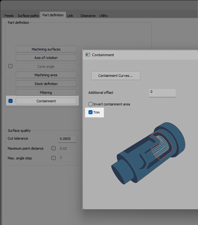

A new Trim option has been added to the Containment dialog for rotary finishing toolpaths, giving users more precise control over how toolpaths interact with selected boundaries. When enabled, the toolpath is generated as if no containment exists, and then trimmed back to the containment region based on the tool center. This avoids unnecessary toolpath extensions beyond the defined boundary and provides a cleaner finish in critical areas. Ideal for users who want to apply containment boundaries without altering the natural flow of the toolpath, this enhancement offers greater flexibility and refinement for finishing operations.
Along Tool Axis Lead
A new Along Tool Axis lead type has been added to the standard UI for Rotary Finishing operations. Previously limited to Parallel, Right Angle, and Circular leads, the updated interface now includes a vertical lead option that moves the tool directly along its axis for entry and exit. This enhancement improves control and flexibility for rotary finishing strategies, especially when working on complex or confined geometry.
Stepover Optimization for Wall Finishing
Rotary Machining users can now benefit from optimized stepover for walls, ensuring more consistent maximum stepover on curved and slanted surfaces, thus improving precision. Users can also adjust the minimum depth step, reducing the number of required toolpaths and increasing efficiency. Toolpaths are trimmed to focus only on necessary areas, minimizing unnecessary machining.
Turn Milling

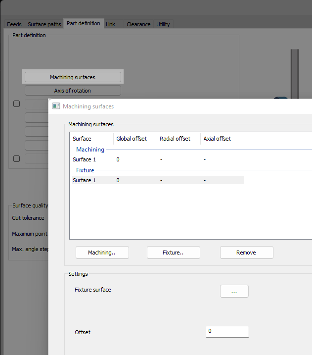

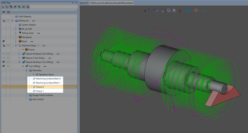

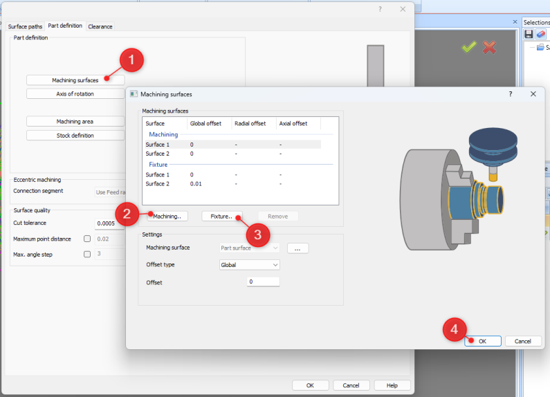

Multi-Geometry Picking and New Fixture Selection
You can now select multiple profiles and fixture geometry for the Turn Milling Operation
  • Support for multiple Turn Profiles / Machining Surfaces for Turn Milling - gives more flexibility when selecting geometry for the feature
    • The new enhancement for Turn Milling allows users to select more than one profile or surface for the geometry in the machining surfaces dialog.
    • As seen in the image below, you can also select multiple Fixture geometries as well.
  • Support for Fixtures/Chucks for Turn Milling - improves collision avoidance with Fixtures/Chucks
    • The new enhancement for Turn Milling allows users to select Fixtures/Chucks for inclusion in the collision avoidance calculations for Turn Milling toolpaths.
    • The selected mesh/model is spun, and the resulting profile is used to avoid collisions. An offset distance is also provided to give users more control and greater safety.
Offset Type - Radial and Axial Allowance
There is a new feature within the new “Machine surfaces” dialog. There is now an option to set an “Offset Type”. This is similar to how you can define an “Offset Type” for your allowance in the Advanced Rough operation for either “Side and Bottom” to set two different offsets depending on if it a wall or floor surface, or “global” to set a universal offset amount for any surface. This Offset type for the Turn Milling operation allows you to define “Global” offset allowance for all surfaces, or “Radial and Axial” for wall surfaces or cylindrical floor surfaces.
  • Axial and Radial Offsets for Turn Milling - provides greater control of offsets
    • There is a new option for setting the axial and radial offsets for both the machining geometry and the fixture, in addition to the existing global offset option. This means that users can now define offsets to meet the finishing requirements.
    • This provides more flexibility and control over leaving the offset material to meet the requirements of the specific finishing job, resulting in an overall better surface finish.

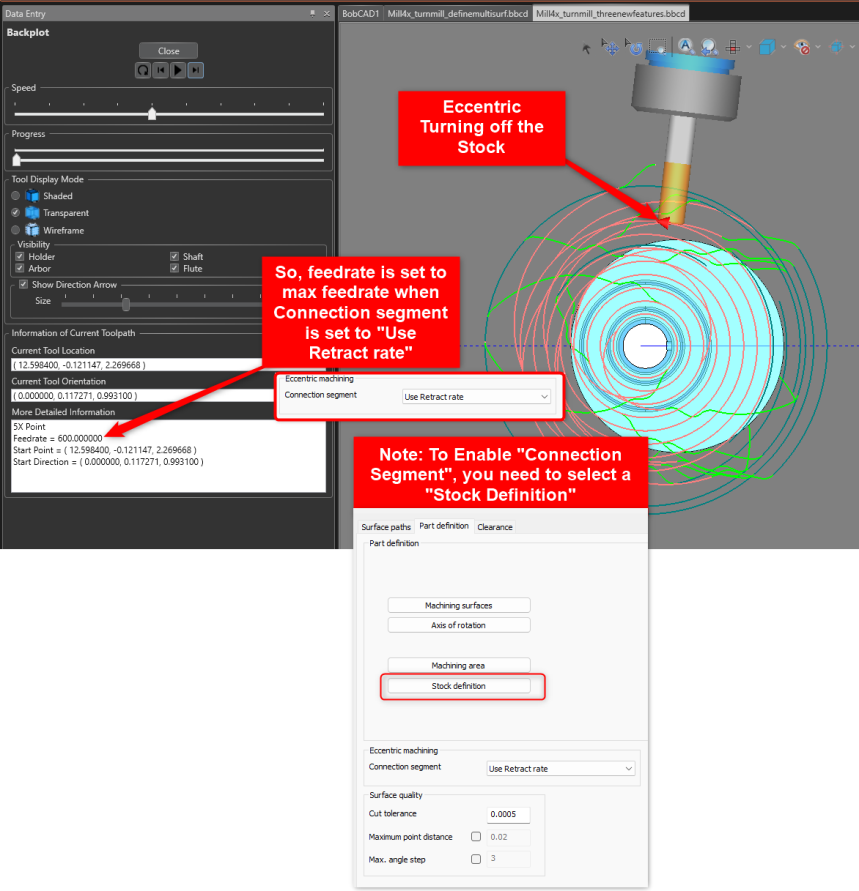

Eccentric Turning - Faster Links
There is a new option on the “Part Definition” page called, “Connection segment”. This allows you to define how you handle toolpath that is not touching the part. It allows you to set “Use Retract rate” to make the tool move at max feed rate when it is air cutting and “Use Feedrate” to keep the old way of moving at the Operation’s defined feed rate.
  • Faster Links in Eccentric Milling - enhances the feed rate for faster linking
    • Allows users to generate faster linking moves in roughing toolpaths when performing eccentric milling.
    • This reduces the overall cycle time of the operation as the tool moves faster when it is not cutting any material.
    • This new option offers better support for eccentric parts, especially casting, and reduces machining time.
    • This option is available only when Stock is defined as a Surface.

Continuous Toolpath Around Corners
The Deburring toolpath now provides a more continuous toolpath when handling inner or outer corners. No need to set any parameters in the CAM Wizard! The toolpath calculation will automatically handle this.
  • Corner Arc Support for Chamfer Tools
    • This new enhancement creates a continuous toolpath around inner and outer corners when using a chamfer mill without any intermediate links for 5-axis deburring.
    • This reduces the linking motions and hence the overall cycle time for chamfering.
    • Toolpath enhancements, no UI change

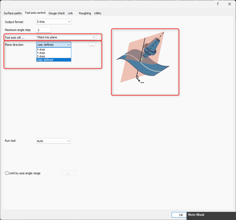

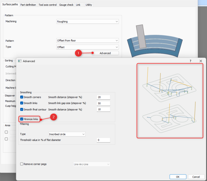

More Rigid 5-Axis Toolpath Motion For Better Surface Finish
Toolpath Calculation improvement for 5-Axis Simultaneous motion. Ensures more 3+2 motion and minimal 5-aixs motion. No need to set any parameters in the CAM Wizard! The toolpath calculation will automatically handle this.
  • Consolidated 3+2 Behaviour
    • The common direction algorithm has been enhanced for deburring to ensure a 3+2 orientation with minimal 5-axis movements.
    • This minimizes undesired 5-axis motions, resulting in safer and more accurate machining.

New "Fade" Lead Type
This "Fade" lead type moves slowly away from and towards the machine surfaces. The result is a very small ramp that enables rest finishing strategies to easily engage the material without leaving stepover marks on the workpiece. The main benefit is improved surface quality after tool changes, orientation changes and machine down times.
  • Fade Lead In/Out – new Lead Type
    • This "Fade" lead type moves slowly away from and towards the machine surfaces. The result is a very small ramp that enables rest finishing strategies to easily engage the material without leaving stepover marks on the workpiece.
    • The main benefit is improved surface quality after tool changes, orientation changes and machine down times.
User Defined Plane Direction for Multi-Axis Tool Axis Control
There is a new option called, "User Defined" in the Tilited into plane "Plane direction" drop-down box found on the "Tool axis control" tab for the Mill Multi-axis feature. The "User Defined" option allows you to restrict the tool axis within a user defined plane of motion instead of just the X, Y or Z axis. This is a very specific new feature, but very useful if ever needed.
  • Using this feature, the tool axis can be restricted in the user defined plane.
  • Depending on its orientation, either rotary or alternatively tilt can be avoided completely. If the plane normal is aligned with a rotational axis of the machine, it will limit rotational machine movements to that axis.
  • Benefits: With this enhancement, users can expect fewer machine axis movements for more stable machining.

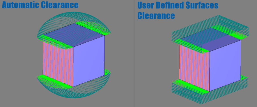

Select Surfaces To Define Retract Clearance Areas
There is a new Clearance Area type for the Mill Multi-axis feature that allows you to set the Clearance Area based of a set of user defined surfaces. Previously, you could select a Plane, Sphere or Cylinder aas a Clearance area. However, in really tight spots on certain models, you sometimes need to be able to select a very specific set of surfaces to retract the tool to. This is where the "Surfaces" type will shine.
  • This new feature allows the selection of user-defined surfaces as clearance areas. With this feature, toolpaths can be limited to shorter retracts, thereby reducing the overall cycle time while providing more flexibility and control to the user

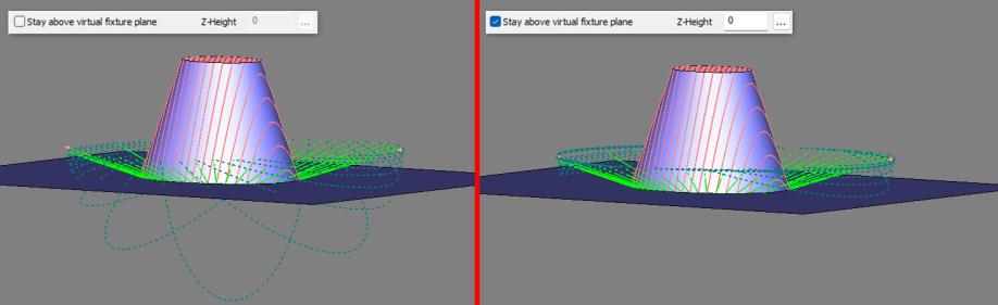

Stay Above Fixture Plane (Sphere Clearance Type)
There is a new option called, "Stay above virtual fixture plane" which is used with the Sphere Clearance Area Type. There are cases where the Sphere retract goes below the desired work area. This new option trims the retract so that the retracts do not go under the part and cause a potential collision. For Sphere Retract type.
  • Virtual Fixture Plane for Safe Linking
    • With this feature, users can avoid links that go beyond the defined virtual fixture plane. This prevents the tool from entering dangerous areas.
    • This feature defines the fixture plane according to a user-specified height so that links are forced to stay above that plane.
    • Defining the fixture plane reduces the risk of collisions, even on complex machining setups.=
    • This option is available for Sphere Clearance only.

Roughing: Minimize Links (reducing cycle time), Ramp improvement, improves tool engagement, New “Detect thicker than” to avoid toolpath is unnecessary areas, New Clearance options similar to options in “Surface” Ops
The new "Minimize Links" toggle can be found in the "Advanced" button in the "Pattern" section.
  • This new enhancement reduces the number of ramps in the multi-axis roughing strategy by optimizing the start points for closed contours.
  • This means that some ramps are removed, and, in these cases, the tool engages from previously cut passes.
  • This reduces the total cycle time of the operation while increasing tool life.

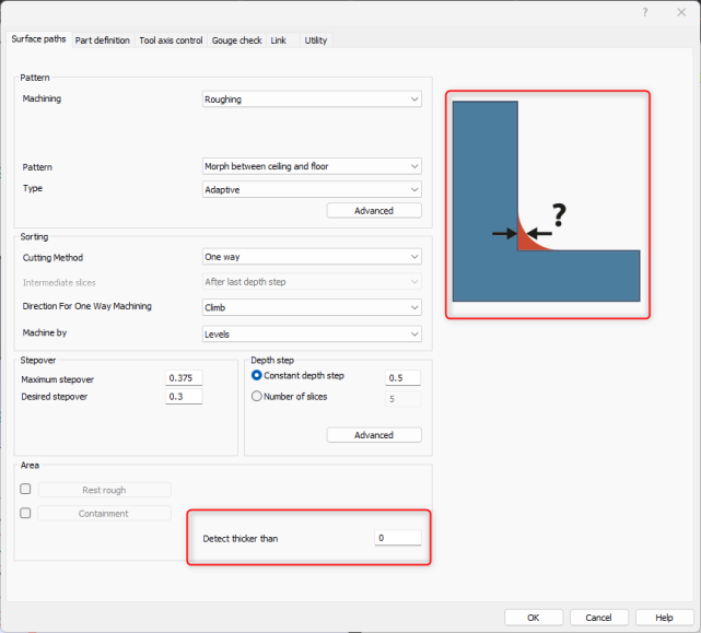

There is a new “Detect Material Thicker Than” option is used to detect only areas thicker than the assigned value. It works similar to an allowance where you set the amount left to be machined with the finishing tool. This gets rid of additional toolpath that is generated in areas where you do not need to cut.
  • With this new feature, thickness of rest material gets detected considering the preset value. This improves the quality of stock-based roughing operation, as tool does not go into the unnecessary areas.
You can now set more Clearance Area types for the Multiaxis Machining Roughing Operation such as Plane, Cylinder, and Sphere. Previously, you had to manually define the surfaces you want to retract to. For basic retracts, this required additional work of creating surface planes for selection. You now have access to these options directly in the CAM Wizard.
  • With this enhancement users can define clearance area as plane or sphere or cylinder to handle retracts.
  • Plane: The planar area is raised above the workpiece at the specified height and in the desired direction. The direction is determined by the direction of the plane normal vector.
  • Cylinder: The cylindrical area around the workpiece is specified by the radius and desired direction. This may be useful for 4-axis and 5-axis machining operations.
  • Sphere: The spherical area around the workpiece with a specified radius and desired position. The position can be defined as XYZ coordinates or by an imported point
Wall, Floor and Rest Finishing
Finishing: Barrel Tools; Considered profile section to determine what part of the tool you want to engage the material, Cusp Height option added, Toolpath Extension extends toolpath of closed contours to eliminate cusps at start/ends of toolpath, new Parallel to Floor Surface pattern for Wall Finishing.
There is a new option for the "Considered profile section" drop-down in the Tool axis control page to control the Curved profile. The picture that highlights the tool in green shows the full area that the tool can engage with the stock. This gives users greater control over the tilting range as well as the tool contact point for operations.
You can now define the Stepover by Cusp Height for the Multiaxis Machining Finishing Operations.
  • This enhancement adds an option for defining the stepover based on the cusp height for advanced tools, including barrel mills.
  • With a cusp-based stepover, users can easily set up operations and avoid mistakes in manual calculations
You can now Extend toolpaths for the Multiaxis Machining Finishing Operations similar to how you can extend toolpath in other Operations to extend the toolpath fully off the part.
  • This feature allows the tool to extend its motion beyond the start and end point of each closed contour. This reduces the size of the cusps at the start and end points, in particular with advanced tools such as barrel tools, and produces clean surfaces.
There is a new "Pattern" for the Multiaxis Machining Finishing Operations called, "Parallel to floor surface".
  • The new floor parallel cut pattern for wall finishing generates slices parallel to a planar floor to ensure that features on the wall do not disrupt the pattern generation.
  • This introduces a whole new set of geometries that can be machined with less tilting and better surface quality.
Multiblade Machining
You can now set a "Link Feed rate(%)" for the Mill Multiaxis Multiblade Operation in the Link page.

Lathe programming just got a major upgrade in BobCAD-CAM V38! You can now also select solids and surfaces directly when defining your Lathe features and the software will automatically convert them into a turn profile behind the scenes. Although you still can select wireframe geometry if desired, there is no more need to revolve or extract wireframe geometry first if you already have the solid model. This makes setup faster, easier, and far more intuitive, especially for users working from 3D models. This new picking method matches the workflow in BobCAM for SolidWorks, creating a more seamless experience between the two platforms. Whether you're programming in BobCAD-CAM or inside SolidWorks, your Lathe workflow now feels familiar, consistent, and more efficient.
When picking geometry for a Lathe Feature, select "Solid and Surface". Then setup your selections in the "Solid and Surface Picking" section.
These are the parameters to setup from top to bottom:
  • Select Solid Body (toggle) - Enabled: Allows you pick whole solids in the graphics area. Disabled: Allows picking individual surfaces off a solid model.
  • Selected Geometry - The box where all selected geometry in shown for the feature.
  • Feature Extraction Method - Allows you to pick the method for extracting the wireframe geometry to be used for the feature.
    • Section Planes - Works similar to the "Section View" CAD function in the software. Creates a wireframe from the cross-section of the surfaces. There is no tolerance involved in the wireframe extraction leading to a more accurate wireframe geometry. The "Start Angle(Deg)" value may need to be adjusted if you have Mill cut features on the part that do not give you a lathe revolved geometry around the part.
    • Spun Profile - Is the same "Spun Profile" CAD function in the software, but now built into the Lathe feature. Finds all the outer most surfaces along the profile of the part and gives you a wireframe geometry to be used in the feature. Think of it as the opposite of the "Revolve" CAD function. Instead of taking a wireframe and revolving the make a solid. You are taking a solid, and un-revolving it the make the wireframe with the added benefit of being able to un-revolve a part that has additional Mill cut features (Eg. If the Part would used in a Millturn job). There is a tolerance associated with this method that can be adjusted in the "Spun Profile" section.
  • Section Planes - Shows when "Section Planes" option is selected
    • Display section planes (toggle) - Enabled: Shows a visual transparent plane in the graphics area to show what cross section of the part will be used for the wireframe geometry
    • Enter Section Angles - Used when setting up the section plane based on a specified angle
      • Start Angle(Deg) - The angle of the cross section plane. Adjust this if you have a model that has Mill features and the cross-section plane interferes with that feature on the part.
      • Interval Angle(deg) - a value between 0 and 360. Allows you to visually see all the planes about an interval and pick from one in the "Section Angles (Deg)" list. When set to 360, you will only see 1 plane at the 0 (Or, 360) degree angle to select from. When set to a value less than 360, you will multiple planes to select from.
    • Pick Section Angles - Allows you to pick from geometry in the graphics area to generate the cross-section plane. Select a point on the model or a line in the graphics area to set the plane.
      • Select Section Positions - The box where the selected geometry is shown for the Pick Section Angles option
    • Section Angles (Deg) - Shows a list of all the available planes to select from.
  • Spun Profile - Shows when "Spun Profile" option is selected
    • Generate Spun Profile - Generates the wireframe geometry for the feature. Click this button only if you have updated the CAD model and have already generated the Lathe feature.
    • Arc Fit - Enabled: The generated wireframe for the lathe feature will generate arcs where applicable. Disabled: Will generate only lines for the wireframe geometry for the feature.
    • Tolerance - Set the tolerance of the Spun Profile wireframe geometry for the Lathe feature.
  • Feature Refinement - Further refinements for the "Solid and Surface" option
    • Remove first vertical line (toggle) - Enabled: Removes the first vertical line in the generated wireframe geometry for the feature.
    • Remove last vertical line (toggle) - Enabled: Removes the last vertical line in the generated wireframe geometry for the feature.

Simulation
The improvements target rendering the stock model and also allow for an improved more watertight mesh to export. This new triangulation method leads to significantly faster stock drawing and mesh exports, resulting in improved overall simulation performance. In addition, the new method significantly improves the watertightness of the exported mesh.
  • New Graph-based Triangulation
    • This new triangulation method leads to significantly faster stock drawing and mesh exports, resulting in improved overall simulation performance. In addition, the new method significantly improves the watertightness of the exported mesh.
Overall improved wait time in simulation. This is especially noticeable in large stock models and large amounts of toolpath.
  • Asynchronous Rendering
    • Rendering calls for highly complex in-process stock can be expensive, affecting the responsiveness of the CAM application.
    • Asynchronous rendering uses a separate thread to triangulate and render the in-process stock, independent of the simulation thread. This improvement accelerates simulation in play mode by eliminating wait times for in-process stock rendering.
    • Reduced wait time in simulation load and run.

It is now possible to define the "Retract Direction" of the Additional Retract option on the "Multiaxis Post" tab in the CAM Wizard. This can be useful if you have a specific toolpath that would gouge the part when trying to retract straight up.

Millturn
  • 3560. Output Lathe Tool Y-Shift in the g-code? y
    • This post question controls the Lathe Tool Y-Shift g-code output. This question is needed on some machines when utilizing a lathe dual tool holder. Since the Lathe tools are not centered on the mounting point of the station, the g-code needs to reflect that shift in Y. This Y-shift value can be controlled 2 different ways.
      • 1st Way: If this post question is enabled, if you have a tool adapter setup in the tool crib, it will automatically post out the Y-Shift based on the position of the lathe tool in the tool holder and the center point of the station.
        2nd Way: If this post question is enabled and you do not have a tool adapter setup. You can use the Y "Shift" section of the tool crib to manually input the Y-Shift.

Advanced Posting Page - Support for Unlimited Number of Check Boxes, Edit Boxes, and Combo Boxes
Thanks to the new CAM Wizard, you can now have any number of Check/Edit/Combo Boxes on the Advanced Posting page! There is no longer a limit since the new dialog allows you to scroll down if the number of boxes exceeds the size of the window.
Further Support for Helix Moves - Number of Revolutions and Helical Direction G-Code
In the previous version of BobCAD-CAM, we added new Post Blocks to handle Helix Moves. In the new version, we have added further support for helix moves with the new post variable, helix_num_revolutions, which sets the number of revolutions in the helix move line in the g-code. We also added Post Questions: 735, 736, and 737. 735 handles the prefix for the new helix_num_revolutions post variable. 736 sets the Helix that moves in the clockwise direction. 737 sets the Helix that moves in the counter-clockwise direction. Both 736 and 737 are called from the g_arc_move post variable. Make sure this post variable is in the Helix Blocks (67, 68, 69) if you need this type of output. If the helix segment were to make 1 complete 360 degree revolution and the prefix on 735 is set to "D", the output code would be D1.
New Post Questions Added:
735. Prefix for Helix Num of Revolutions (helix_num_revolutions)? "D" : Prefix for helix_num_revolutions
736. G Code for Helix CW? "G06" : used with g_arc_move
737. G Code for Helix CCW? "G07" : used with g_arc_move
New Post Variable added:
helix_num_revolutions : Number of revolutions in the helix segment being posted out. If the helix segment makes one complete 360 degrees revolution, the helix_num_revolutions will output D1. With “D” being the prefix setup in post question 735.
Example of how to implement into post processor:
Add Post Blocks
Copy
67. Helix move XY
    n,g_arc_plane,g_arc_move,x_f,y_f,z_f,arc_center,feed_rate,helix_pitch,helix_num_revolutions
68. Helix move YZ
69. Helix Move XZ
AND...
Copy
733. Prefix for Helix Total Angle? ""
734. Prefix for Helix Pitch? "K"
Example output code: Spiral Entry from a Mill 2-Axis Pocket
Copy
N08 G07 Z0.0588 I0.1111 J-0.0572 F3.3369 K0.0412 D1.
N09 Z0.0177 I0.1111 J-0.0572 K0.0412 D1.
N10 Z-0.0235 I0.1111 J-0.0572 K0.0412 D1.
N11 Z-0.0646 I0.1111 J-0.0572 K0.0412 D1.
N12 Z-0.1058 I0.1111 J-0.0572 K0.0412 D1.
N13 Z-0.147 I0.1111 J-0.0572 K0.0412 D1.
N14 Z-0.1881 I0.1111 J-0.0572 K0.0412 D1.
N15 Z-0.2293 I0.1111 J-0.0572 K0.0412 D1.
N16 Z-0.2704 I0.1111 J-0.0572 K0.0412 D1.
N17 Z-0.3116 I0.1111 J-0.0572 K0.0412 D1.
N18 Z-0.3528 I0.1111 J-0.0572 K0.0412 D1.
N19 Z-0.3939 I0.1111 J-0.0572 K0.0412 D1.
N20 Z-0.4351 I0.1111 J-0.0572 K0.0412 D1.
N21 Z-0.4763 I0.1111 J-0.0572 K0.0412 D1.

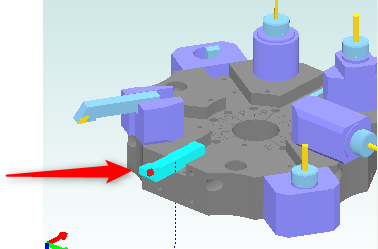

Adding a Y-Shift in the g-code when using Lathe Dual Tool Holders
This is needed for some Millturn machines.
