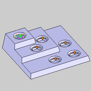

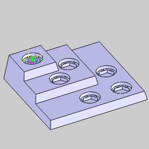

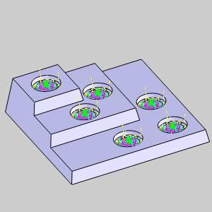

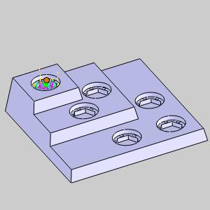

Specified Points
This options allows you to handle situations that do not fall neatly into the a simple translation pattern. Pick the Start point, then pick the positions where the copies should be created.
Toolpath to be patterned
Start Point
Positions
Result
Start
Pick the first point. This is the point the others will be measured from to determine the X, Y, and Z distances the copies need to be moved to.
  • X - is the distance from the current X Axis location of the machine setup.
  • Y - is the distance from the current Y Axis location of the machine setup.
  • Z - is the distance from the current Z Axis location of the machine setup.
  • Pick - selecting this option will hide the dialog, and launch the Toolpath Pattern Picking dialog to allow you to select geometry from the graphics area to define the end location. The nearest snap point of the selected entity is used.
