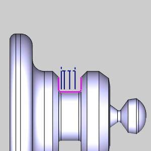

Pattern

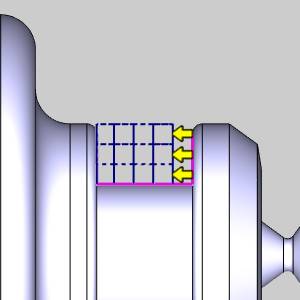

The Pattern allows  you to select how the passes are laid down. Choose between Standard, Single Pass, and Zig Zag.
Standard
Single Pass
Zig Zag

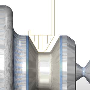

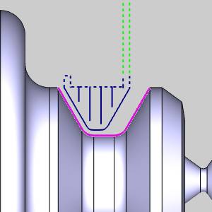

Standard - Each pass will be perpendicular to the center of rotation. The order of cuts are handled with Sorting options below.

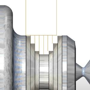

Single Pass - will cut the groove without using a stepover.
  • Center - will center the tool in the feature.
  • Begin - will place the side of the tool at the very beginning of the feature.
  • End - will place the other side of the tool at the very end of the feature.

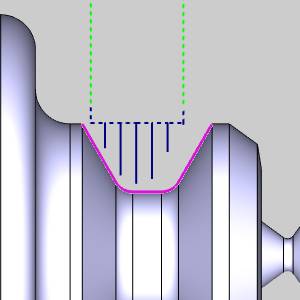

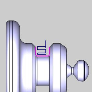

Zig Zag - Each pass will be parallel to the center of rotation and alternate direction.

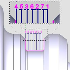

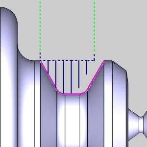

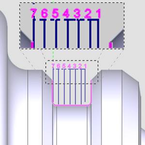

Sorting
Sorting allows  you to select how the passes link to following pass.

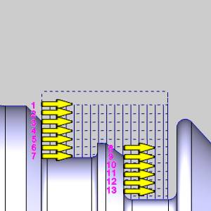

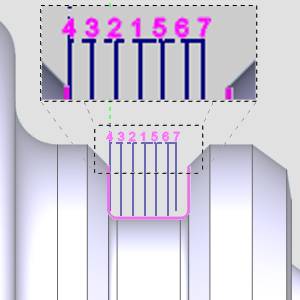

Standard - will start on one end and make one cut directly after the other until the groove is clear.

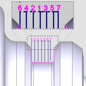

 Center Out - will start in the middle and clear out one side of the groove, making one cut directly after the other. Once it reaches the end, it will go back to the middle and cut in the other direction, making one cut directly after the other, until the groove is clear.
 Center Out Alternate - will start in the middle, and alternate making a cut on one side of the middle and then the other, moving back and forth until the groove is clear.
 Skip - will  start on one end and make one cut. It will then move in one direction, skip one cut and cut the next cut. It will then continue in the same direction, only cutting every other cut. Once it reaches the end, it will move in the other direction, cutting only the remaining passes in order.

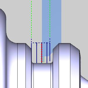

Stepover - sets the spacing between toolpath passes.
Rough Allowance -  Selecting this option will create a pass before the final pass to act as a semi-finish. The spacing of the semi-finish pass will be dictated by the values entered in the Z and X boxes.
Semifinish Pattern - Once a Rough Allowance has been selected, the Semifinish Pattern will allow you to select between a one directional semifinish, or a semifinish that forces a downward cut.
Basic Finish
Force Down Cutting
Force Down Cutting with Overlap
Force Down Cutting - selecting this option will force the semifinish to be cut from each side of the groove one at a time, each in a downward direction, to the middle of the groove. Adding an overlap will set each pass to go past the center of the groove half the specified amount.
Overlap - sets the total distance between the two passes exits, not including any leads that are uses.
Basic Finish - sets the semifinish pass to one single direction.

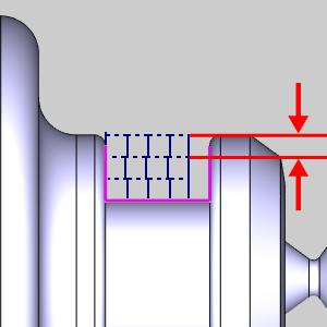

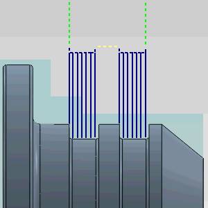

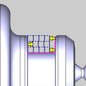

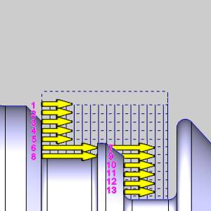

Multiple Depths
The Multiple Depths group allows you to break the total groove depth into steps rather than just one full depth cut or pecked cut.
Depth of Cut - allows you to set the spacing between depth passes.
Processing - allows you to handle instances where the selected geometry causes the toolpath to be broken along a number of passes. This will allow you to decide how the tool will move between the separated areas of toolpath.
By Area - will complete all depth passes on whole area before moving to next.
By Level - will cut all areas of the part to the current pass depth before beginning the next.

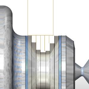

Bounds
Trim to Stock -  With this option cleared, no toolpath will be trimmed.
Trim to Stock - With this option selected, the toolpath extending beyond the Operation Stock will be trimmed.
Trim to Stock off
Trim to Stock on
