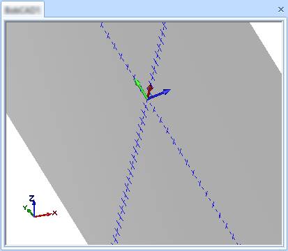

UCS vs WCS
The WCS, or World Coordinate System, is the underlying coordinate system everything in the system is based on and it shares is location and orientation with the Top(X/Y) Plane, and is always visible in the lower left of the graphics area, as seen in the image below. Other Coordinate systems can be created on top of the WCS however, and these are referred to as User Coordinate Systems. A UCS, or User Coordinate System, is a coordinate system whose X, Y, Z zero positions have been redefined for the purposes of making the current drawing, or at least the current portion of the design, easier to draw for the user. Not only can the location of the X, Y, Z zeros be redefined, the vector direction, or orientation, of the UCS itself can also be redefined.
In the above image:
 The WCS - This will always show the orientation of the WCS and cannot be hidden.
The UCS Plane - This shows the position and orientation of the current UCS. The color and level of transparency can be adjusted in Settings Part and Settings Default.
The Axis X-Y -  This shows the position and orientation of X, and Y axis of the current UCS, as well as the unit Tick Marks. The color and number of Tick Marks can be adjusted in Settings Part and Settings Default, and its visibility can be toggled in the same screens.
The Gnomon - This shows the position and orientation of X, Y, and Z axis of the current UCS. Its visibility can be toggled in Settings Part and Settings Default screens.

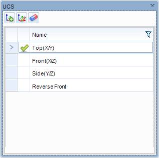

The UCS Manager
The UCS Manager is used to select between existing user coordinate systems, to modify existing user coordinate systems, and to create new user coordinate systems. The default user coordinate systems are, Top (X/Y), Front (X/Z), and Side (Y/Z). The default coordinate systems cannot be modified, but others can be created, and at any point in the drawing process, you can click on a particular UCS in the UCS Manager to make that the active coordinate system. When you set a UCS as active, the coordinate system in the graphics area is updated to reflect the selected UCS. CAD geometry is always created using the X,Y, and Z zeros of the Active UCS.
Top UCS
Front UCS
Side UCS
The default location of the UCS Manager is the right-hand side of the user interface. When the pane is docked with other Managers, as is the case by default, clicking the UCS tab will access the UCS Manager.
The Shortcut and Quick access menus
You right-click anywhere in the UCS window, or the UCS name, to access a shortcut menu with the following commands. The Add New UCS, Modify UCS, and Delete UCS options are also available as buttons in the quick access menu at the top of the UCS Manager.
  • Active UCS - sets the selected UCS as the active UCS.
  • Add New UCS - adds a new UCS to the list and opens the Create UCS dialog box in the Data Entry Manager for you to define the new UCS.
  • Modify UCS - opens the Modify UCS dialog box in the Data Entry Manager for you to change the location of the selected UCS.
  • Delete UCS - removes the selected UCS from the list. You can't delete the default (Top, Front, or Side) work planes.
