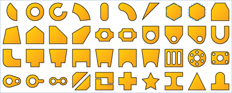

  2. Click the image of the Disk shape in the Data Entry Manager.
    A dialog presenting the available shapes appears.
  3. Select the ring shape.
    The Ring parameters open in the Data Entry Manager.

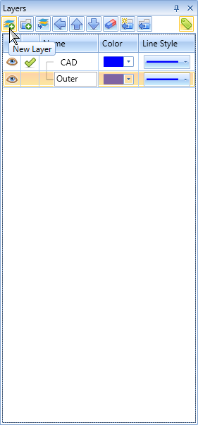

Part 3) Create a Layer with a Different Color
Next we create a layer and assign a color to it. This assists in geometry selection later in the tutorial.

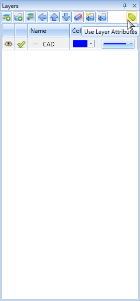

  1. Select the Use Layer Attributes toggle button in the quick access toolbar of the Layers Manager.

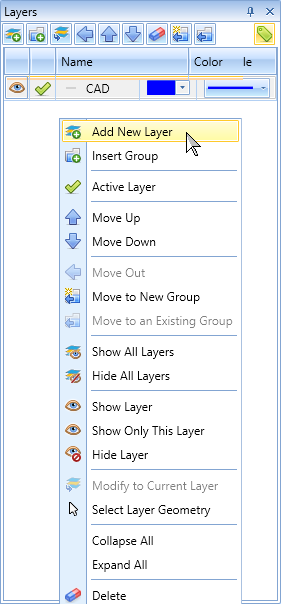

  2. Right-click in the Layers Manager, and select Add New Layer.
    A new layer is created with the name, Layer-1, highlighted to allow for edits, and is set to the active layer automatically.
  3. To name the layer, type Outer.
    The name is automatically updated once focus is placed on another area, or function.
  4. In the Color column of the Outer layer, click the down arrow on the icon.
  5. In the color palette, select the purple color from the Standard Color row.
Tip: With Use Layer Attributes selected, the color and line style set for an individual layer will automatically be set as the active attributes when that layer is active.

Part 5) Create a CAD Layer
Using CAD layers is a great way to keep your drawings organized. This helps with geometry selection and provides a convenient way to hide and show geometry.
  1. In the quick access toolbar of the Layers Manager, click the New Layer button.
    A new layer is created with the name, Layer-2, highlighted to allow for edits, and is set to the active layer automatically.
  2. To name the layer, type Holes.
