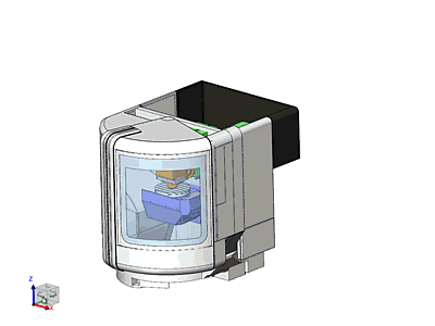

The Simulation tab contains many of the most used buttons for controlling the simulation. This tab contains the Simulation, Control, Simulation Run Speed, Views, Visibility, and Toolpath Rendering groups. The available buttons for each group are explained next. When hovering over some of these options, you will notice a letter in parentheses. This letter is the available shortcut key to access this item without needing to click on it directly.
Simulation

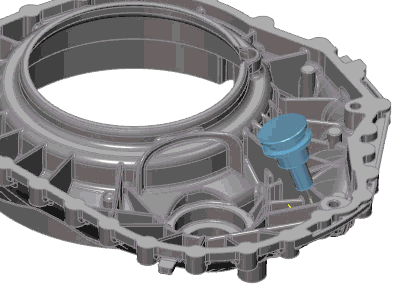

Backplot or Material Removal Mode
The simulation can be run in one of two modes for material removal or toolpath backplot only.
Toolpath Backplot Mode(B) - simulates the toolpath only without material removal (the stock button becomes unavailable as well as many of the material removal verification tools).
Material Removal Mode(V) - simulates the toolpath including material removal. Many of the features of the simulation are designed to work with this mode to verify the material removal.
Display Mode
The simulation display mode is controlled using one of the following options.
Time-based Mode - the machining simulation displays with real time feedrate motions. Machine motions are very fluent, machining time is exact.
NC-based Mode - the machining simulation only uses the tool positions from the move list. Machine motions jump from one position to the next.
Length-based Mode - the machining simulation uses a constant speed, distance/time regardless of the feed rate.
Display Focus
The simulation focus determines how the tool, machine, and material/workpiece display using one of the following options.
Tool Focus(T) - simulates the program with the tool and workpiece visible, with the tool remaining stationary.
Workpiece Focus (W) - simulates the program with the tool and workpiece visible, with the workpiece remaining stationary.
Machine Focus(M) - simulates the program showing the kinematic motion of all machine elements.
Control
The Control group on the Simulation tab contains buttons for controlling the playback of the simulation.
Run (R) - plays the simulation. You can click the down arrow under this button to select the Loop playback button. Clicking the down arrow next to the function will show the Loop, and Feed Move Run options.
Loop (L) - sets the simulation to run repeatedly, or loops back to the beginning of the simulation when the end is reached. Clicking the down arrow next to the function will show the Run, and Feed Move Run options.
Feed Move Run - does a fast forward movement until the first FEED move, and then returns to normal speed until the next RAPID move is encountered. Another fast forward movement is used until the next FEED move is encountered, and then returns to normal speed. Clicking the down arrow next to the function will show the Loop, and Run options.
Stop (S) - stops the simulation at the current position and retracts the tool for you to view the cut stock material.
Pause (P) - stops the simulation at the current position without retracting the tool.
FastForward (Space) - advances the simulation to the last step without showing the simulation process in the simulation window. If a collision happens during fast run, it is reported.
Step Fwd (Page Down) - allows you to incrementally move through the simulation by moving the simulation to the next toolpath point/segment. Clicking the down arrow next to the function will show the Next Feed Move option.
Next Feed Move - jumps over the RAPID moves until the first FEED move is encountered. This is done as a "search" jump, where many functions, like collision checking, are deactivated. This is not a Fast Forward movement. Clicking the down arrow next to the function will show the Step Fwd option.
StepBack (Page Up) - allows you to incrementally move through the simulation by moving the simulation to the next toolpath point/segment. Clicking the down arrow next to the function will show the Prev Feed Move option.
Prev Feed Move - jumps back over the RAPID moves until the first FEED move is encountered. This is done as a "search" jump, where many functions, like collision checking, are deactivated. This is not a Rewind movement. Clicking the down arrow next to the function will show the Step Back option.
Next Op (Enter) - advances the simulation to the next operation (automatically simulating the previous operation).
Previous Op (Backspace) - returns the simulation to the previous operation.
Restart (Home) - starts machining over again from the beginning and resets the material removal (Material Removal mode).
