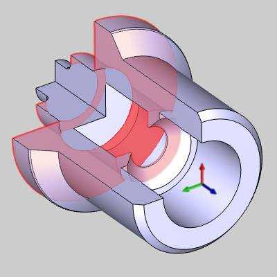

Material Approach

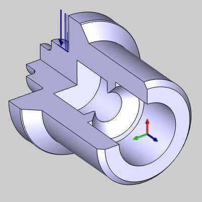

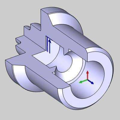

Rapid Plane - is the height at which the tool can rapid safely within a single operation.
Default Rapid
Higher Rapid Value

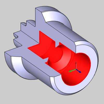

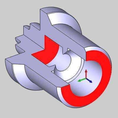

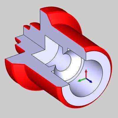

Feature Type
  • OD - Sets the feature to the outer diameter of the part.
  • ID - Sets the feature to the inner diameter of the part.
  • Face - Sets the feature to faces normal to Z+.
  • Back Face - Sets the feature to faces normal to Z-.

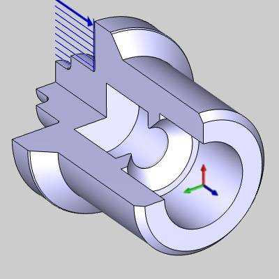

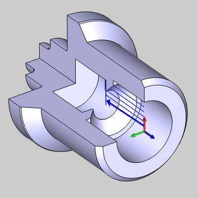

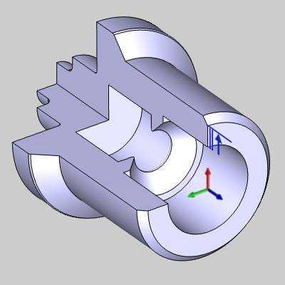

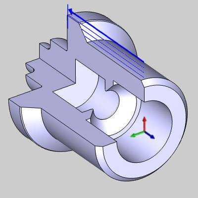

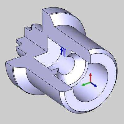

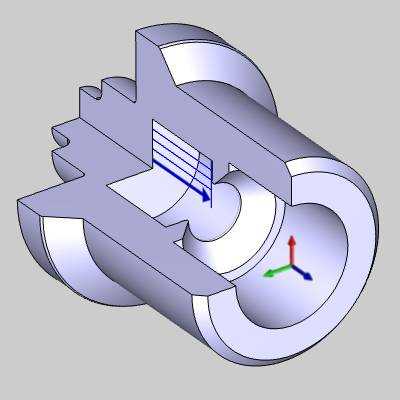

Region - Sets the features default settings for the type of toolpath being used. This will set the default rapids, entry and exits as well as default tool selection and direction of cut.
  • 1 - See examples.
  • 2 - See examples.
