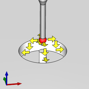

This cycle measures a cylindrical cut extruded in the Z Axis with 4 points. This cycle can utilize the following geometry inputs:
  • An arc whose normal is parallel to the Z Axis.
  • A cylindrical surface edge whose normal is parallel to the Z Axis.
  • A cylindrical surface whose normal is parallel to the Z Axis.
Note: The probe can be made to lift between measurements to avoid obstacles The touch points move away from each other in the X and Y Axes as it is meant to measure cylindrical cut extrusions.
