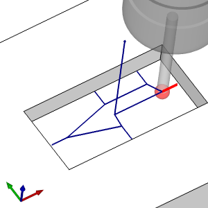

The 5-point Rectangle Internal Cycle

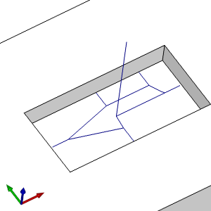

This cycle measures four sides of rectangular cut, whose walls are parallel with X and Y, in order to determine the length and width. This cycle can utilize the following geometry inputs:
  • Rectangular wireframe with sides parallel to the X and Y Axes.
  • Rectangular planar surface with edges parallel to the X and Y Axes.
  • Four planar surfaces whose normals are aligned along the X and Y Axes.

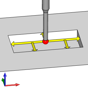

  • Distance Between 2 Points - This cycle uses a single contact point on three sides of the rectangle, and two contact points on the other. This value specifies the distance between those 2 contact points.

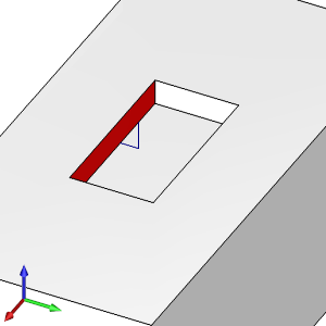

  1. Click the Parameters tab.

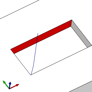

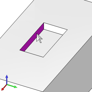

  2. Rotate the part in a manner that allows you to select the surface whose normal is parallel with the Y Axis.
    Since our current geometry works for a Y Single Surface cycle, that is the cycle that is currently selected for us.

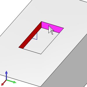

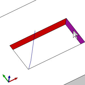

  3. Select the surface whose normal is parallel with the X Axis.
    The geometry is added to the Selected Geometry list, the Initial Position and Parameters section are populated, and the toolpath updates to show an Internal Corner cycle.

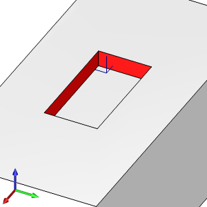

  4. Rotate the part in a manner that allows you to select the next surface whose normal is parallel with the Y Axis.
    The geometry is added to the Selected Geometry list.

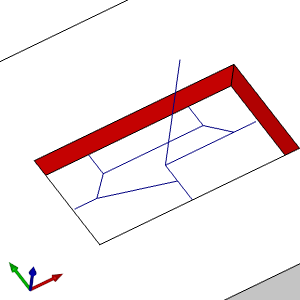

  5. Select the next surface whose normal is parallel with the X Axis.
    The geometry is added to the Selected Geometry list, the Initial Position and Parameters section are populated, and the toolpath updates to show an 5-point Rectangle Internal cycle.
    The value and the toolpath update to put the initial position of the probe a quarter inch further forward in X.

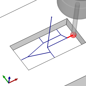

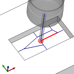

The Options section for this cycle consist of a total of three options: Two Measurements Face, First X Position, and Distance Between 2 Points. The Two Measurements Face option allows you to determine which side of the rectangle will use two contact points. The First X Position allows you to determine the point along the X Axis which a contact point will be used. The Distance Between 2 Points option allows you to set the space between the two contact point which occur on the same face. For this example will explore each of the options.

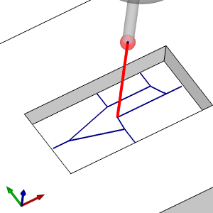

  1. Click the drop down next to Two Measurements Face, and select Top Face.
    The toolpath updates to move the two points from the Bottom Face, to the Top Face.
  2. In the Options section, select the check box for First X Position.
    The toolpath updates. Notice the contact point on the top face is now at the same position along the X Axis as the first point on the bottom face.
  3. In the Options section, update the First X Position value by adding +0.50 to the end, and pressing Tab.
    The toolpath updates. Notice we have updated the contact points on the top face, as well as the contact point on the bottom face.
    Now we have an issue with the last contact point along the X Axis. We will need to adjust the distance between those two points to force the last point away from the right face.
  4. In the Options section, select the check box for Distance Between 2 Points.
    We can now update that value.
  5. In the Options section, update the Distance Between 2 Points value by adding -0.50 to the end, and pressing Tab.
    The toolpath updates. Notice the last contact point along bottom face is now in contact with the surface.
