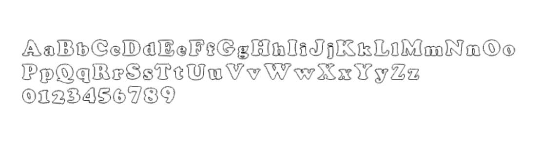

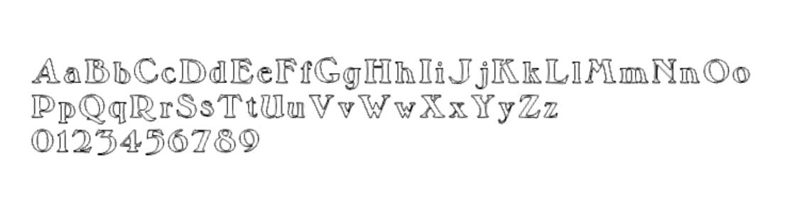

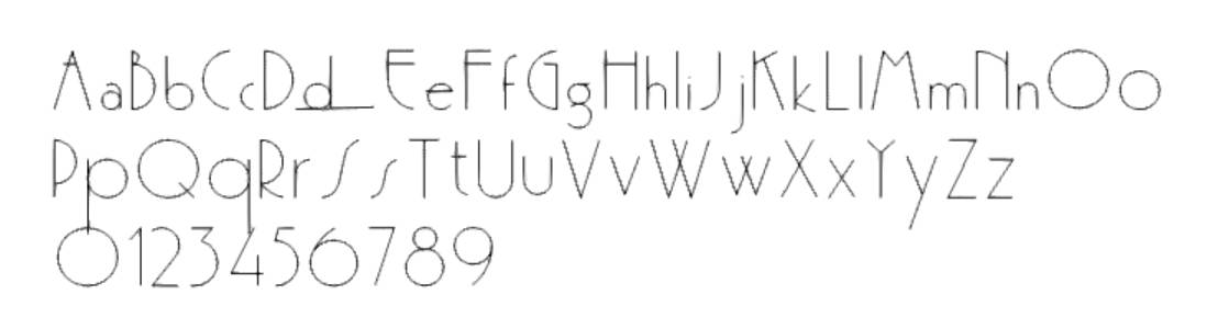

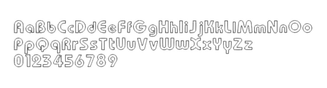

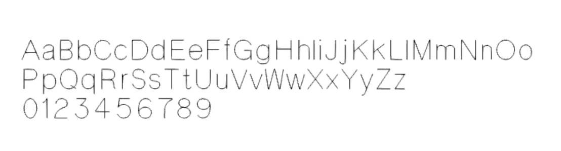

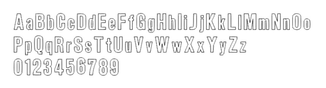

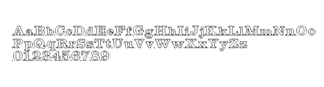

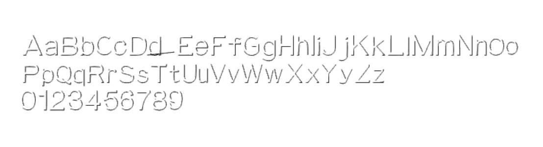

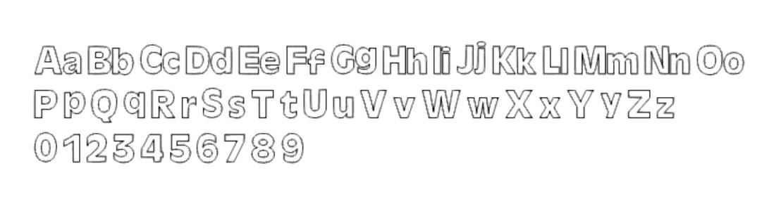

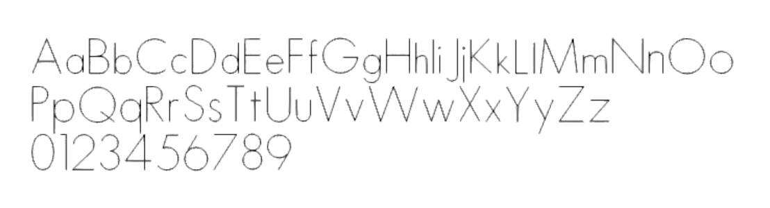

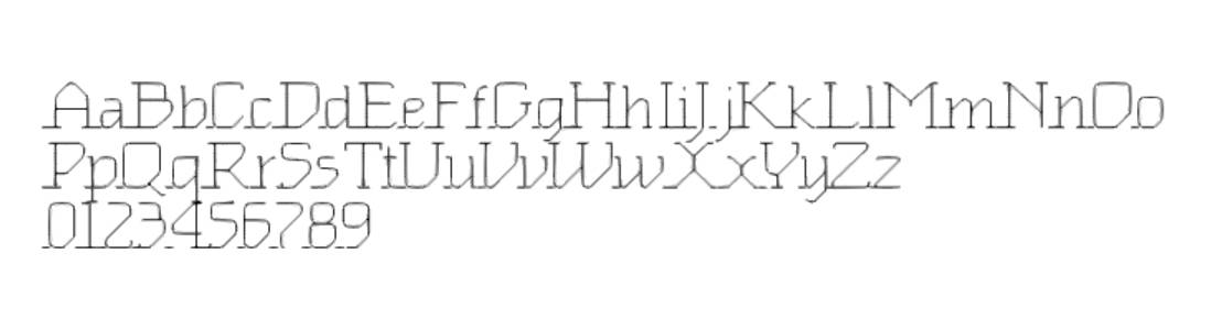

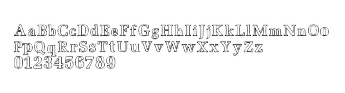

Examples of BobCAD AFNT Fonts

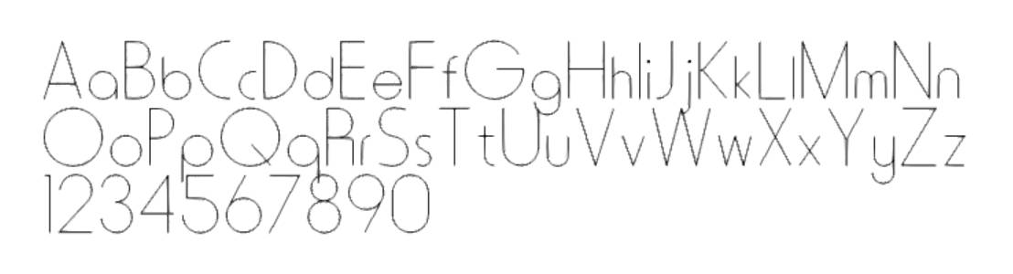

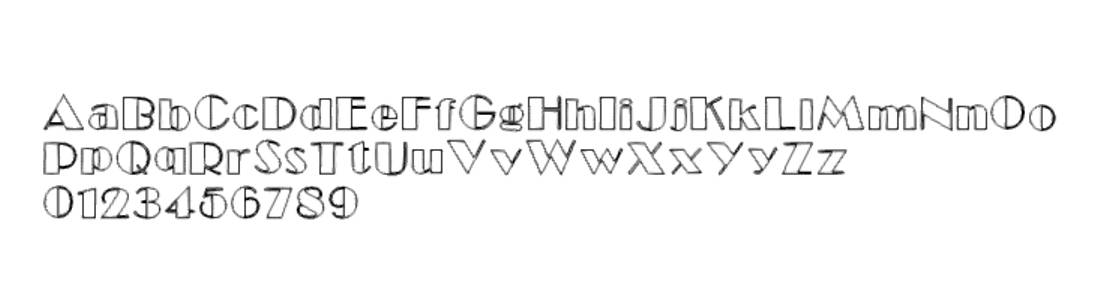

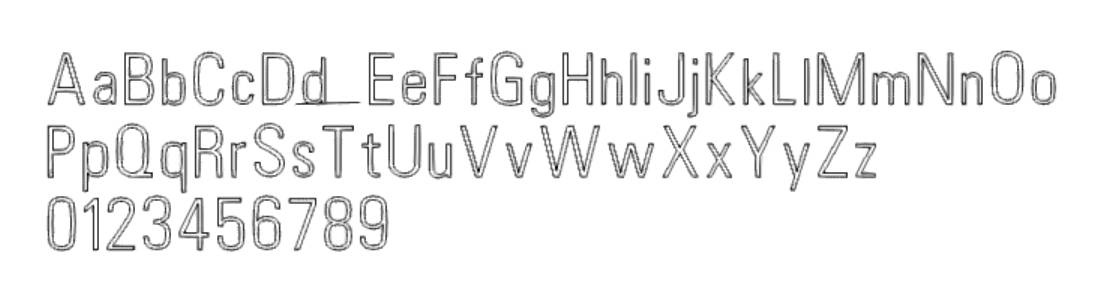

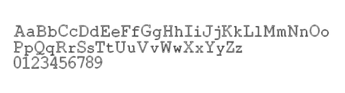

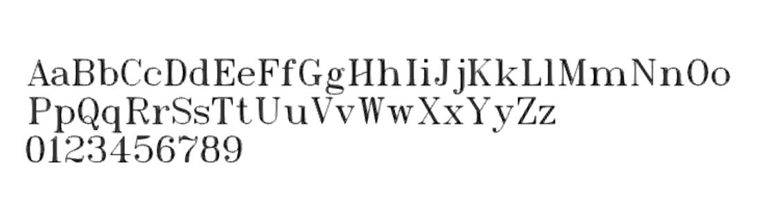

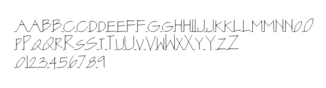

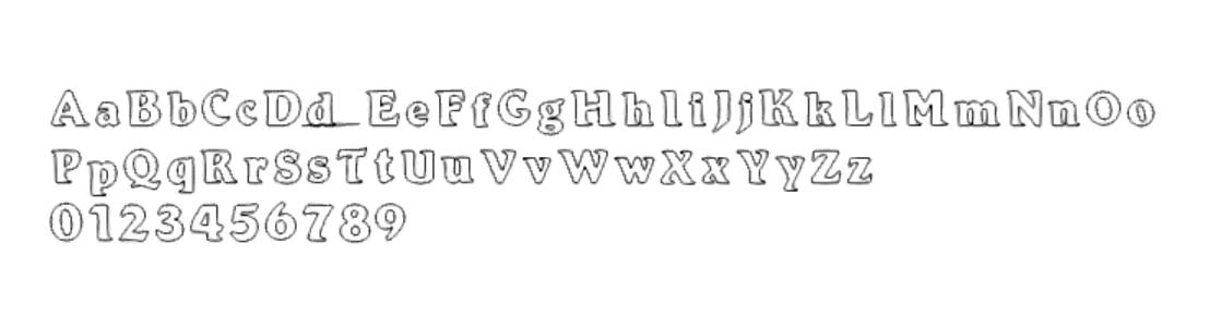

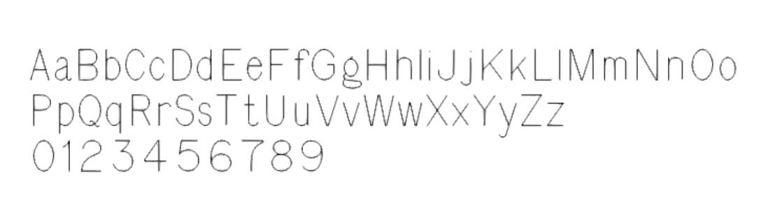

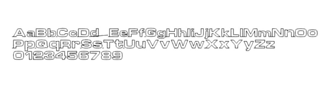

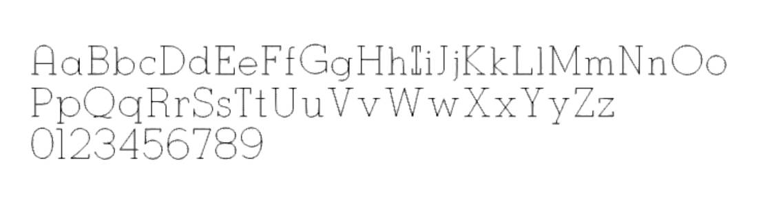

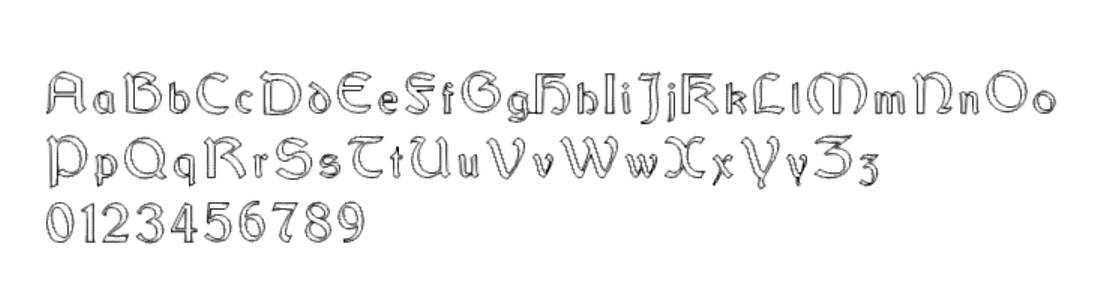

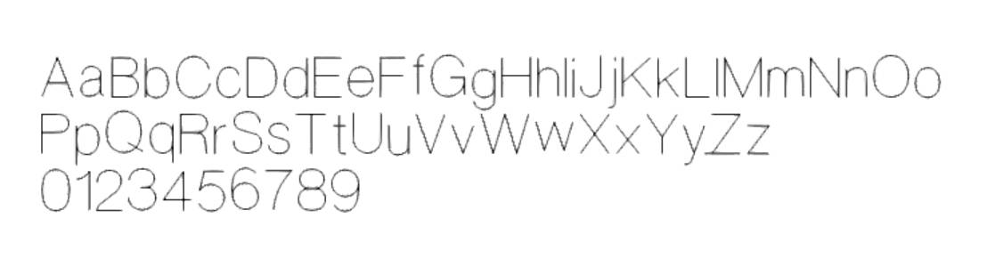

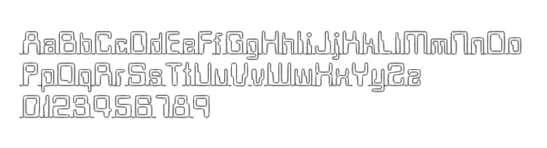

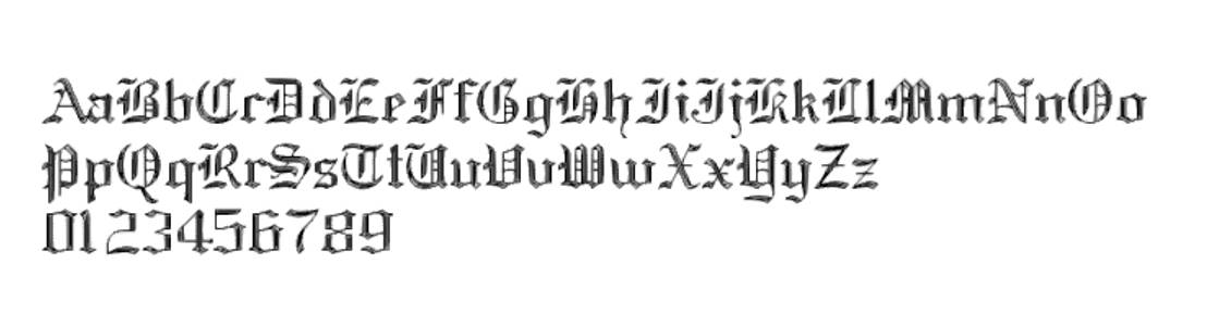

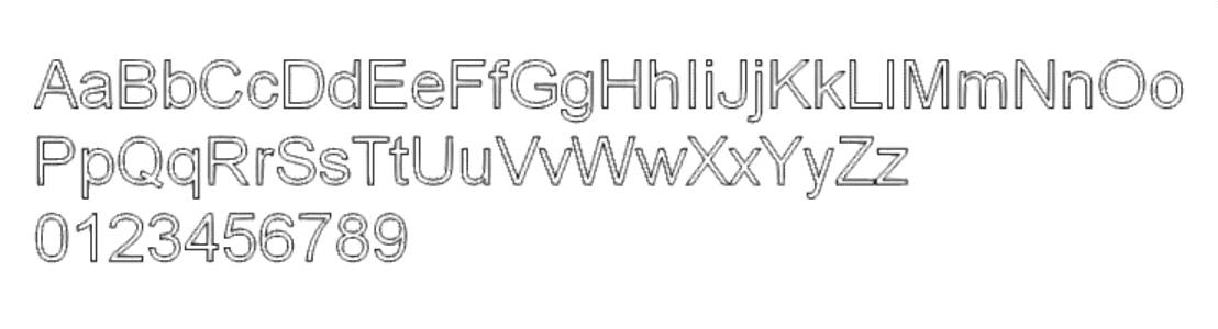

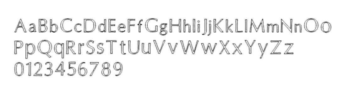

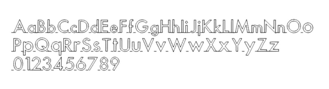

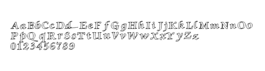

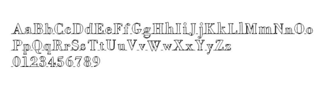

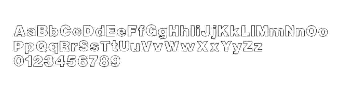

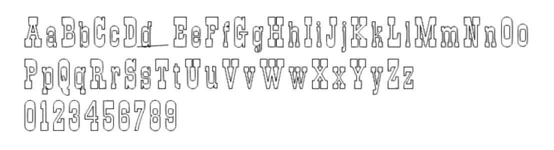

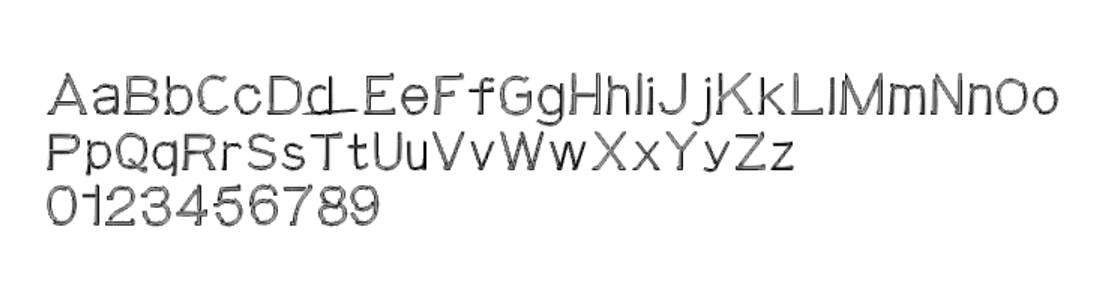

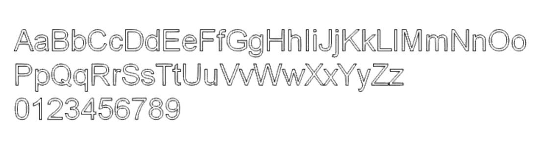

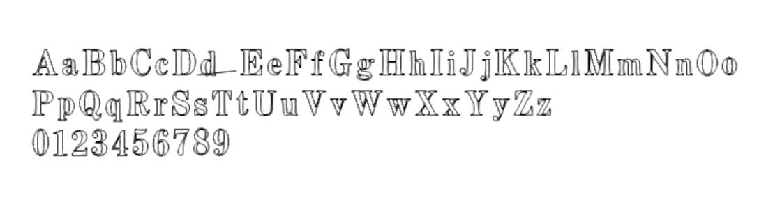

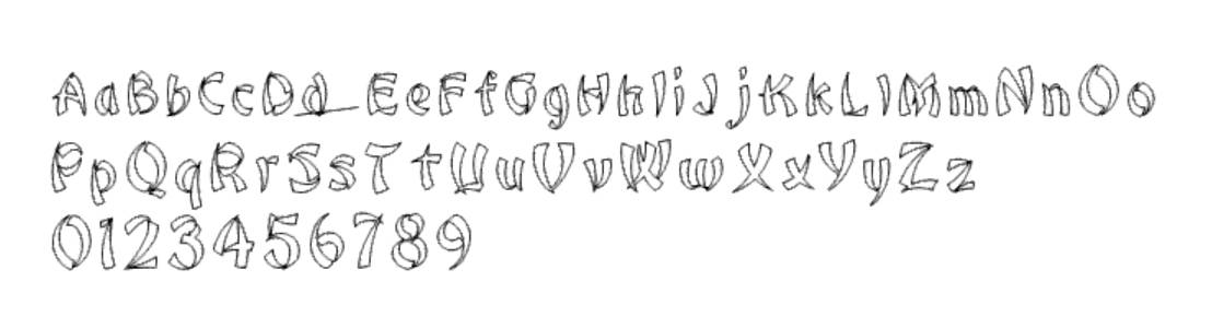

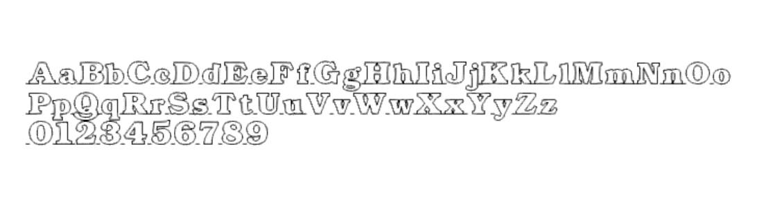

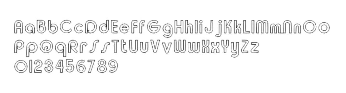

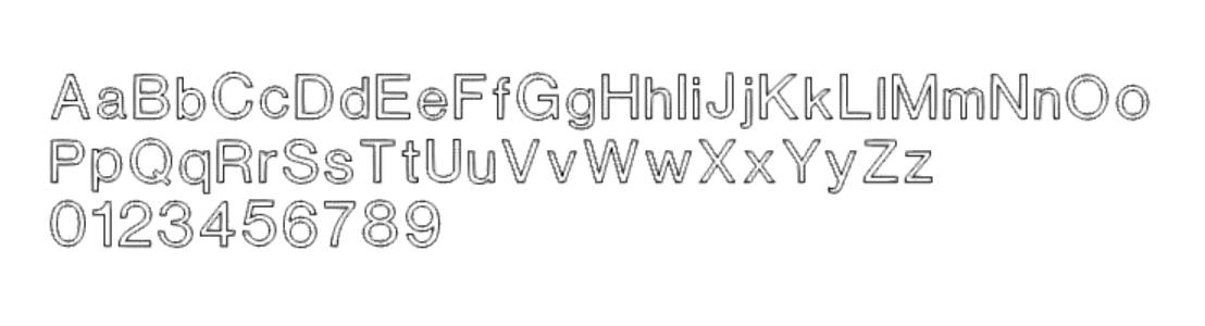

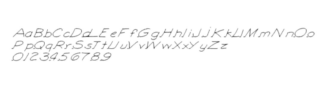

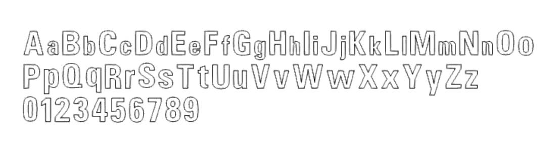

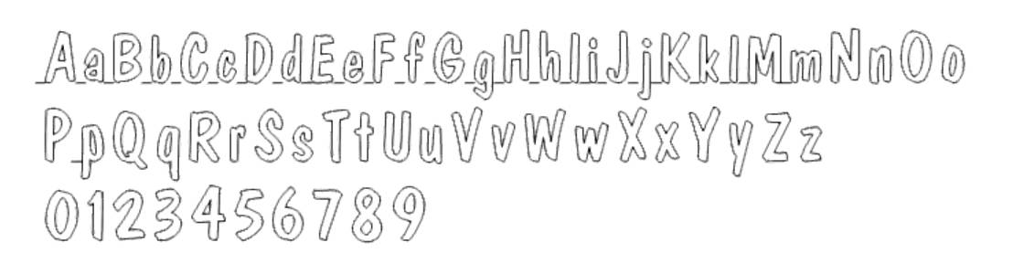

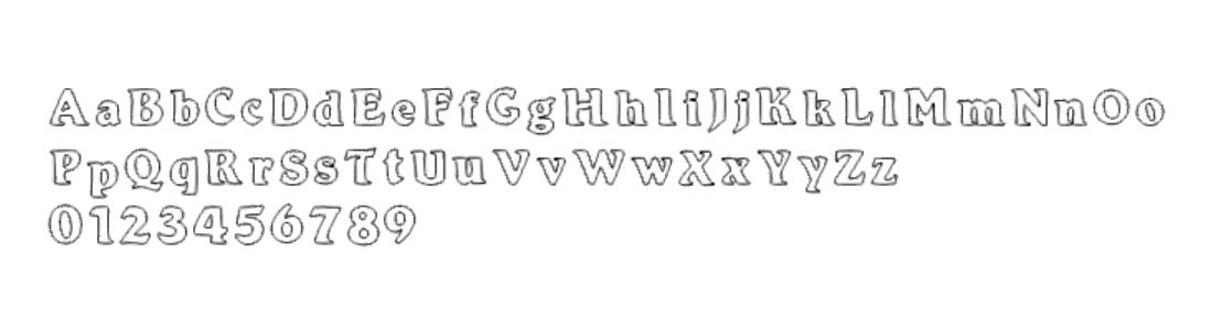

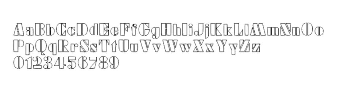

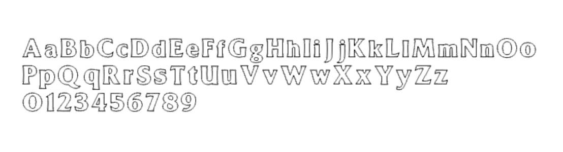

While the available Windows font will vary greatly based on what the individual has installed on their computer, the BobCAD Fonts installed for every user. Below is a list of all BobCAD Fonts, with their name on the left, and example on the right. Hover over a font example to see an enlarged image of it.
Tip: You can also access a BobCAD-CAM file with all fonts on a separate layer in your examples folder: C:\BobCAD-CAM Data\**Current Version**\Examples\BobCAD_AFNT_Text.bbcd
