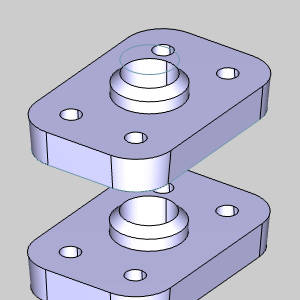

When using Extrude Cut, you can select closed wireframe chains or planar surface geometry.For this example, we select a wireframe chain and then explore Dynamic Drawing to define the extrusion direction and distance from the chain.
  1. Press S,or select Shaded from the document toolbar.
    The Shading is removed from the model.
  2. Under the graphics area, change the value of the (Snap Increment) to 0.2500.
    This allows us to sketch CAD sizes and depths in increments of 0.2500.
  3. For this example, we select the geometry first before defining the Data Entry parameters. This way we can create the CAD preview and explore Dynamic Drawing.

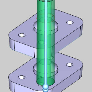

    In the graphics area, hover over the circle, as seen in the image below.
  4. Click the arc to add it to the Selected Geometry list.
    The Preview appears.
Note: Notice that by default the circle is extruded one unit in the positive direction. For any Extrude function, you can specify the extrude distance in either or both directions from the selected geometry. You can also apply a Draft Angle to either or both directions.
  1. To show how Dynamic Drawing works, hover over the sketch handle as seen in the image below.
  2. Click the sketch handle to activate it.
    The sketch handle highlights and the preview moves down based on the next snap increment.
Note: When a sketch handle is activated, the CAD preview changes to a wireframe display until you place the sketch handle. Move the handle down and notice it does not move smoothly, but jumps by an incremental amount. This is the snap increment amount that has been set. Notice too, that the Other Direction Distance is updating as the sketch handle is being moved.
  1.  Move the sketch handle so that the Other Direction Distance is set to 3.0000.
  2. Click to set the sketch handle.
    The Preview updates.
  3. To perform the Extrude Cut, leave the Scope set to All Bodies, and click OK.

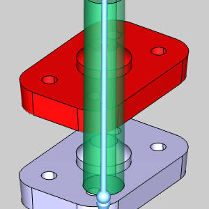

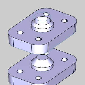

Part 4) Excluding Solids from Extrude Cut
It is important to understand when using the All Bodies option is that any solid body in the file that intersects the extruded shape is included in the Extrude Cut result. This applies to all visible or hidden solids unlessthey are hidden using the Blank command, found in the document toolbar.When set to All Bodies, hiding a CAD layer does not exclude the solids on that layer.
  1. In the Layer Manager, click the Layers tab if it isn't already selected.
  2. In the Layers Manager, right-click the layer name Flange Copy, and click Show.
    If needed, rotate the view to see that the second flange was also cut, even though it was on a hidden CAD layer.
If the second flange was hidden using Blank, it would not have been included in the Extrude Cut.
Tip: After hiding a solid using Blank in order to exclude it from an Extrude Cut, or Boss and then showing the solid using Unblank, if the CAD Tree is rebuilt, that solid will then be included in the Extrude Cut result. If this creates a problem, you can use Solid Subtract instead of Extrude Cut.

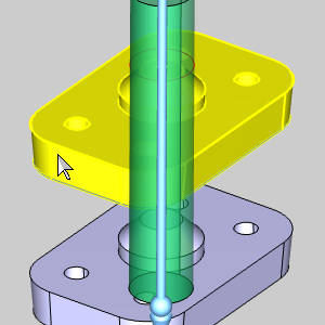

    Double-click Extrude Cut to edit it.
    The CAD preview displays, and the Extrude Cut Parameters open in the Data Entry Manager.
  2. In the Scope section, select Selected Bodies.
    The Selected Geometry list appears.
  3. Select the intended body.
    The body is added to the Selected Geometry list.
  4. To finish editing the feature, click OK.
    The feature is updated with the copy begin excluded from the Extrude Cut feature.
