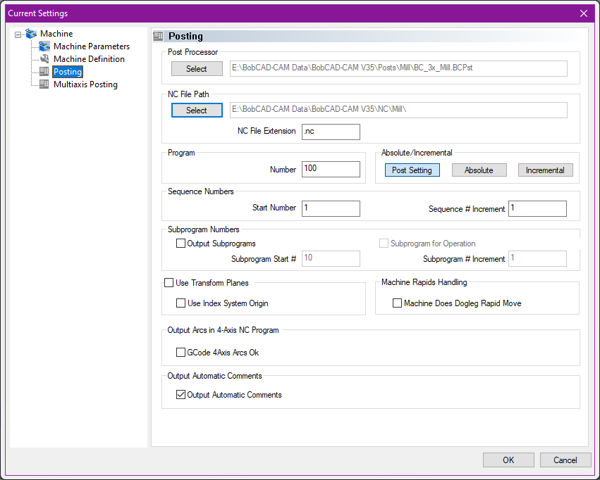

After simulating and confirming the desired result, you are ready to post the NC program. It is important to understand that the NC program is created using the post processor file that is assigned to the machine. The default post processor for each machine is defined in Current Settings and can be modified from the CAM Tree.
How to Access Current Settings
To open the Current Settings dialog box:
  • Right-click CAM Defaults, and click Current Settings.
Tip: This method selects the Current Settings Default (for system default settings). You can also access the Current Settings Job (for the current job only) by right-clicking Milling Job instead of CAM Defaults.
  • Click Posting, and notice the NC File Path. (The machine is selected in Machine Parameters.)
Many important Posting settings, such as the program number, subprogram selection, and more are defined in the Current Settings. For more help, view the BobCAD-CAM Help System.

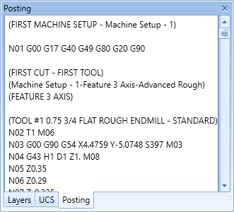

The Posting Manager
When you post a program in BobCAD-CAM, the NC program also displays in the Posting Manager.
The Posting Manager allows you to view the code, and you can open it in the NC Editor.
The NC Editor and RS232 Communication (DNC)
To edit the NC program:
  • Right-click in the Posting window, and click NC Editor.
This launches the editor with the NC program. The editor allows you to edit the code, setup RS232 communications (DNC), and even backplot the program (Editor Pro), which allows you to simulate exactly what the code is going to do on the actual machine.
