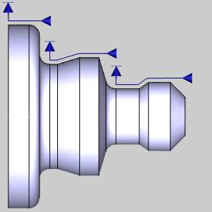

Pattern
Continuous - sets the finishing pass to a single pass along the geometry.

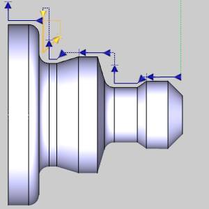

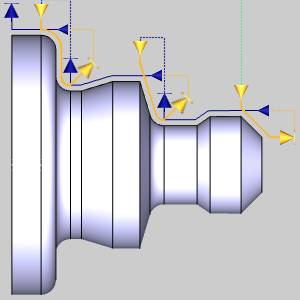

Alternate - breaks the finishing pass into separate groups defined by either vertical faces, turned diameters, or a combination of the two.
Both - will Face Vertical, and Turn Diameter with opposing direction of cuts.
Overlap - allows you to extend the Face Vertical and Turn Diameter cuts so their end points intersect a specific amount.
