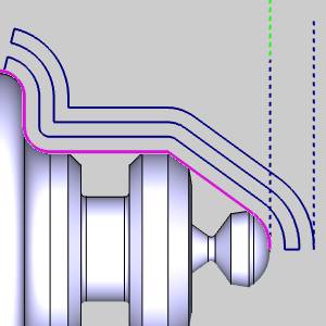

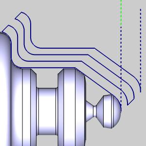

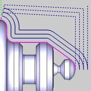

The Pattern allows  you to select how the passes are laid down.
Standard - Each pass will be parallel to the center of rotation.
Offset - Each pass will be an offset copy of the selected geometry trimmed to the feature constraints.
Standard Offset

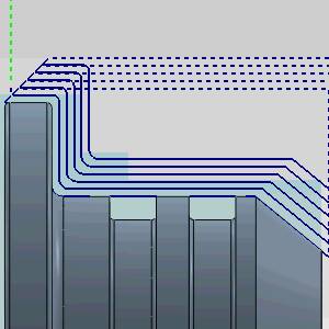

Sorting
Sorting allows  you to select how the passes link to the following pass.
Standard - defines a one-way cutting pattern with retracts between each cut.
Zig Zag - defines a two-way or alternating cutting pattern.
In the table below you can see how these sorting options affect the selected patterns.
Standard Pattern
With Standard Sorting
With Zig Zag Sorting
Offset Pattern
With Standard Sorting With Zig Zag Sorting

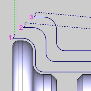

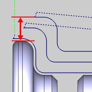

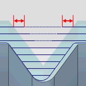

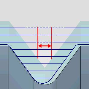

The parameters section give you the ability to adjust the distance of the pattern, the allowances used, and the number of passes to be used.
Z Distance - sets the distance in Z between the last past and any passes prior to it.
X Distance - sets the distance in X between the last past and any passes prior to it.

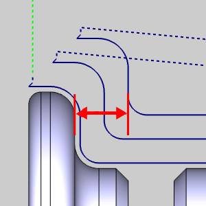

Z Allowance - sets the distance in Z between the last pass and the selected geometry.
X Allowance - sets the distance in X between the last pass and the selected geometry.
Number of Passes - sets the amount of passes.
Note: When the number of passes is set to 1, the Z and X Distance is not available. If only one pass is being used, it is the Z and X Allowance that sets the spacing between the cut and selected geometry.

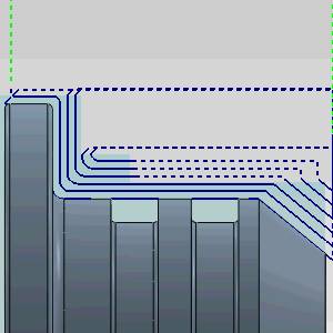

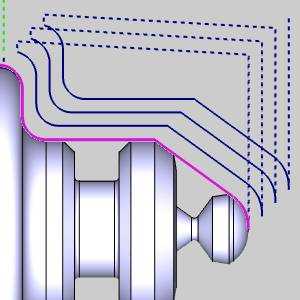

Corner Type
Round - keeps the specified tool geometry in contact with the geometry at all times.
Sharp - allows the tool to move off the geometry in order to line up with the next move on the following entity. This method eliminates the rounding over of the tool.
Theoretical Point on Tool
Rounded Corner
Sharp Corner
