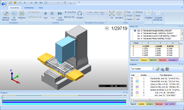

Pro (Full Machine) Simulation
This provides the same functionality as the Standard Simulation and adds the ability to define a virtual machine so you can view the complete machine motion and even perform collision checking between machine components.

Focus
Machine Focus
With Machine Focus (available only for Machine Simulation Pro), the full virtual machine and its movement display in addition to the stock and workpiece.

Move List
The Move List contains a list of all operations and the tool moves for each operation. You can click an operation to go directly to that part of the program simulation. You can also drag the slider to go forward or backward in the simulation.

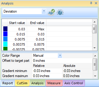

Stock Analysis
The Stock Analysis allows you to apply a coloring scheme to the stock model. For example, the cut stock material can display based on the operation number, tool number, or other criteria such as height change, angle change, or toolpath length. You can also perform deviation analysis to visualize the rest material.
Deviation
The Deviation analysis allows you to compare the cut stock model to the target workpiece. You can set the range, gradients, number of colors, and even customize the colors used.
Operation Number
The Operation Number analysis displays all cut stock material with a separate color for each operation.
Single Marking
The Single Marking analysis displays all cut stock material using a single color.
