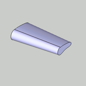

This example will have you:
  • Create Two Rectangles
  • Create a Cam Plate Layer
  • Create the Cam Plate
  • Extrude the Cam Plate
  • Create a Soft Jaws Layer
  • Create the Imprint
  • View the Result
    Intended result:
Part 1) Create Two Rectangles
For this example, we will be imprinting two rectangles that will become a set of soft jaws to hold our Cam Plate. Our first step will be to create those rectangles.
  1. In the Shapes group, of the Create 2D ribbon, click Rectangle.
    The preview with default settings displays.
  2. Set the Length (X) to 4.000.
    The preview updates.
  3. Set the Width (Y) to 1.000.
  4. In the Origin group, set the Z value to -0.75.
    The Preview updates.
  5. Click OK to confirm the settings and placement of the first rectangle.
    The first rectangle is created.
  6. In the Origin group, set the Y value to 2.0000.
  7. Click OK to confirm the settings and placement of the second rectangle.
    The second rectangle is created.
  8. Click Cancel to exit the Rectangle function.
Part 2) Create a Cam Plate Layer
In order to keep our geometry organized, we will create a new CAD layer, so that we may easily hide and show different aspects of our file.
  1. Right-click in the Layers Manager and select Add New Layer.
    A layer is created and the name is highlighted to allow for alteration.
  2. Type "Solid" as the name for the new layer and press Enter, or click off of the layer to set the name.
  3. Right-click the new Solid layer and select Active Layer to set that as the active layer.
    The Solid layer is now marked as active.
Part 3) Create the Cam Plate
Next, we will create the Cam Plate that will be extruded into the solid will create an imprint from.
  1. In the Shapes group, of the Create 2D ribbon, click the Shape Library icon.
    The Disk shape populates in the Data Entry Manager.
  2. Click the image of the disk shape to launch the shape library dialog.
    The Shape Library dialog appears.
  3. Select the icon.
    The parameters open in the Data Entry manager, and the Preview displays.
  4. In the Position and Orientation group, change the X value to -1.5000.
  5. Click OK to confirm the settings and placement of the Cam Plate.
    The Cam Plate is created in the graphics area, and the Cam Plate feature is added to the CAD Tree.
Part 4) Extrude the Cam Plate
The next step is to create the extrusion of the Cam Plate.
  1. In the Extrude group, of the Create 3D ribbon, click Extrude Curve.
  2. Press Ctrl+2 to get into a Front view.
    The View updates.
  3. Window pick the Cam Plate.
    The Preview appears, showing the default settings.
  4. Change the Positive Direction value, from 1.000 to 0.7500.
    The Solid is created and an Extrude Curve feature is added to the CAD Tree.
    Although our geometry is shown in an isometric view, we will remain, or return to, a side view in order to make selection easier.
Part 5) Create a Soft Jaws Layer
We will create a new CAD layer to keep our imprint separate from the rest of the geometry.
  2. Type "Soft Jaws" as the name for the new layer and press Enter,or click off of the layer to set the name.
  3. Right-click the new Soft Jaws layer, and select Active Layer to set that as the active layer.
    The Soft Jaws layer is now marked as active.
Part 6) Create the Imprint
Now that we have a solid model, we can create an imprint of it.
  1. In the Extrude group, of the Create 3D tab, click Imprint.
  2. By default, the Profile Chains group has focus and is ready to accept the geometry we select.
    Window pick the Soft Jaws geometry as seen in the image below.
    The geometry highlights, and the entities are added to the Profile Chains list.
  3. Click in the Selected Solids list to allow us to add our solid to the list.
  4. In the graphics area, hover over the solid to highlight it.
    The solid highlights.
  5. Click the solid to select it and add it to the Selected Solids list.
    The Preview appears.
  6. In the Distancegroup, change the option from Default, to the Distanceoption.
  7. Change the Distancevalue to 1.0000.
  8. Click OK to confirm the settings.
    The Imprint is created and an Imprint feature is added to the CAD Tree.
Part 7) View the Result
To see what we have created, we will hide the rest of the geometry.
  1. Press Ctrl+7 to get into an ISO 2 view.
    The View updates.
  2. In the Layers Manager right-click the Solidlayer.
  3. Select Hide.
    The extruded Cam Plate hides and we can see the result of our Imprint.
