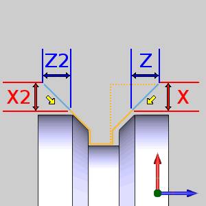

  • Custom - creates a lead into the material that is dictated by the values entered in the Lead-in Z, and Lead-in X boxes.
    • Lead-in Z - sets the distance and direction of travel, in the Z-axis, for the approach into the toolpath.
    • Lead-in X - sets the distance and direction of travel, in the X-axis, for the approach into the toolpath.
  •  Override Z2/X2 - When the Force Down Cutting pattern is in use, there are actually two lead-ins to the feature. By default, these values are adjusted so the one side is a mirror of the other. Selecting this option will allow the Lead-in Z2, and Lead-in X2 variables to be adjusted by the user.
    • Lead-in Z2 - sets the distance and direction of travel in the Z-axis for the other approach into the toolpath.
    • Lead-in X2 - sets the distance and direction of travel, in the X-axis, for the other approach into the toolpath.

  • Custom - creates a lead out of the material that is dictated by the values entered in the Lead-out Z, and Lead-out X boxes.
    • Lead-out Z - sets the distance and direction of travel, in the Z-axis, for the approach into the toolpath.
    • Lead-out X - sets the distance and direction of travel, in the X-axis, for the approach into the toolpath.
Note: The lead-ins and lead-outs for Grooving operations are always adjusted based on the feature and region selected. This means that in most cases you can type positive values and the resulting leads are exactly what is needed to exit the cut. Negative values are still supported and can be used in situations where the adjusted leads do not yield the proper results.
