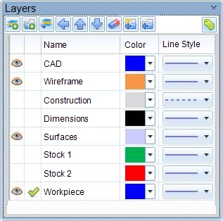

The Layers are what CAD geometry is created on. The default CAD layer is always visible in the Layers Manager. While the original CAD layer, cannot be deleted, it can be renamed. Any geometry, or dimensions, that are created, are automatically placed on the Active layer.
The Layer Manager
The purpose of the Layers Manager is to provide a way to keep your CAD drawings organized. Layers can be hidden to only show certain aspects of a drawing, or you can place different versions of the same part on separate layers.  The Layers Manager can be used to specify a particular color and line style to use for each layer, and you can also select all the geometry on a given layer for use with other CAD functions or CAM features.
The default location of the Layers Manager is the right-hand side of the user interface. When the pane is docked with other Managers, as is the case by default, clicking the Layers tab will access the Layer Manager.

Visibility, Active Layer, Name, Color, and Line Style
Each one of the columns in the Layer Manager control a different aspect of the layers . In each row, the columns contain visual aids that are used to show the current state of the each layer.
  • Visibility - The contents of each layer, can be visible, or not. This column will set whether the particular layer is hidden.
This icon means that the layer is visible. You can click this icon to hide the layer.
This icon means that the layer is hidden. You can click this icon to show the layer.
  • Active Layer - Only one layer can be drawn in at a given time. This column sets which is the active layer being drawn in.
This is the active layer icon. There is always only one active layer. Any geometry that is created is drawn on this layer. Any layer without this icon is considered a non-active layer. Clicking on a layers row, in this column, will make that the active layer, and move the icon to that position.
  • Name - Each layer is given a name upon creation. The original layer is always CAD, with additional layers numbered as Layer-1, Layer-2, etc. To change the name of a layer, double click on the name and enter the name as you wish for it to appear. This column will list the name of each layer.
  • Color - assigns a particular color to the layer. This is only utilized when the Overwrite option is active.
Tip: When each layer is created, the current entity color is assigned to it, which can be updated at any time directly from the layer. To utilize each layers specific color, select the Use Layers Attributes option. With the Use Layers Attributes option active, switching to an active layer whose assigned color differs from the current active color, will automatically update the active color.
  • Line Style - Assigns a particular line style to the layer. This is only utilized when the Overwrite option is active.
Tip: When each layer is created, the current entity line style is assigned to it, which can be updated at any time directly from the layer. To utilize each layers specific line style, select the Use Layers Attributes option. With the Use Layers Attributes option active, switching to an active layer whose assigned line style differs from the current active line style, will automatically update the active line style.
