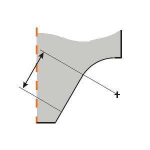

  1. In the Linear Distance text box, set the distance to be measured past the radius of the tool.

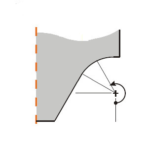

  2. In the Radial Distance text box, set the distance from the radius center to the spindle axis.
  3. In the Options section, select the check box for Check Height.
  4. In the Check Height text box, set the distance from the radius center to the tool tip.

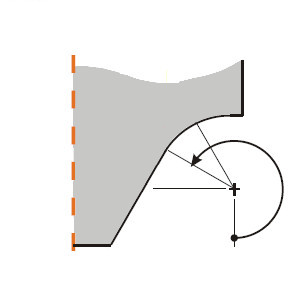

  5. In the Options section, select the check box for Start Angle.
  6. In the Start Angle text box, set the angle to begin measurement of the described radius.
  7. In the Options section, select the check box for End Angle.
  8. In the End Angle text box, set the angle at which the radius terminates.
