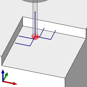

This cycle measures the location of two perpendicular planar surface faces to determine the location of their intersection. This cycle can utilize the following geometry inputs:
  • Two perpendicular lines which are aligned along the X and Y Axes.
  • Two planar surface edges which are aligned along the X and Y Axes.
  • Two planar surfaces whose normals are aligned along the X and Y Axes.

  • Distance Between 2 Points - This cycle uses a single contact point on three sides of the rectangle, and two contact points on the other. This value specifies the distance between those 2 contact points.

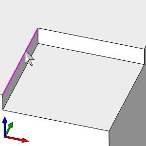

  2. Select the edge of the surface whose normal is parallel with the X Axis.
    Since our current geometry works for a X Single Surface cycle, that is the cycle that is currently selected for us.

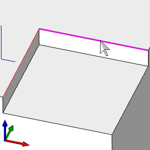

  3. Select the edge of the surface whose normal is parallel with the Y Axis.
    Since our current geometry works for an External Corner cycle, that is the cycle that is currently selected for us.

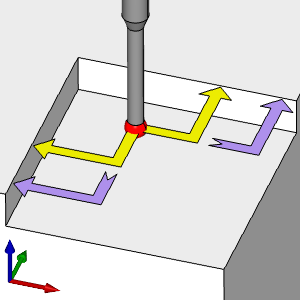

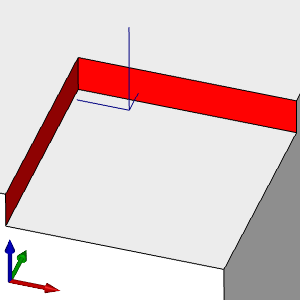

Part 5) Updating the geometry
In this case, the geometry we have chosen could be interpreted as a External Corner cycle.Once we update the cycle, our toolpath will be on the correct side of the corner.The probing feature can do quite a bit of intelligent placement of the toolpath based on the surfaces selected.When edges are the only thing used for geometry selection, not as many assumptions can be made for the intelligent placement of the toolpath.We will take a look at how the geometry selection affects the automatic placement of the created toolpath.
  1. At the top of the Cycles section click the drop down list and select Internal Corner from the list.
    The toolpath and the available Parameters update.However, notice we cannot see the moves that contact the surfaces. This is due to the fact that we have only selected edges. Currently our contact points are inside of the part.Let us take a moment to correct that without having to manually update the necessary values.

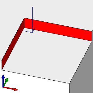

  2. Next to the Selected Geometry list box, click the Delete All button.
    The geometry is removed from the list, and the edges are no longer highlighted.

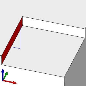

  3. Select the surface whose normal is along the X Axis.
    The surface is added to the Selected Geometry list, and the toolpath updates once more showing us a X Single Surface cycle.Notice this time, the cycle is on the correct side of the surface.

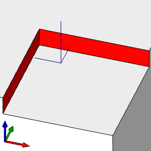

  4. Select the surface whose normal is along the Y Axis.
    The surface is added to the Selected Geometry list, and the toolpath updates once more showing us the intended Internal Corner cycle.Notice this time, the cycle is on the correct side of the surface, as well as at the correct height.

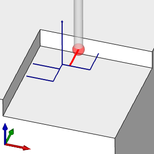

    The value and the toolpath update to put the initial position of the probe a quarter inch further forward in X.
  2. In the Initial Position group, update the Y value by adding -0.25 to the end, and pressing Tab.
    The value and the toolpath update to put the initial position further down in the Y Axis.
The Parameters section for this cycle consists of the Z Measurement Height, the Corner X and Corner Y values, and the Update Work Offset value. In this case we do not really need to adjust the height at which the probe will make contact. The Corner X and Corner Y values should not need to be adjusted since they are calculated automatically and list the position of the intended corner to be measured. The Update Work Offset value can be used as needed. For this example, we will skip to the Options section.

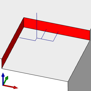

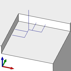

The Options section for this cycle consist of a total of four options: X Distance, Y Distance, X Second Distance, and Y Second Distance. The X/Y Distance options allows you to set a distance from the intended corner at which the contact with the surface will be made. These distances will adjust the contact points without modifying the initial position. The X/Y Second Distance options allow you to create additional contact points on each of the surfaces. These additional contact points allow you to find the corner for surfaces that are not at a ninety degree angle. If both of the second distance options are not used, the corner is assumed to be ninety degrees.

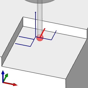

  1. In the Options section, select the check box for X Distance.
    Notice the contact point updates its location along the X Axis without adjusting the initial position.
  2. In the Options section, select the check box for X Second Distance.
    Notice a new contact point is created along the X Axis.
Note: While the value of the X,Y Distance options define the distance from the wall, notice the value of the X,Y Second Distance determines the distance between the first and second contact points.

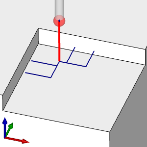

  1. In the Options section, select the check box for Y Distance.
    Notice the contact point updates its location along the Y Axis without adjusting the initial position.
  2. In the Options section, select the check box for Y Distance.
  3. In the Options section, select the check box for Y Second Distance.
    Notice a new contact point is created along the Y Axis. The corner is no longer assumed to be ninety degrees any longer.
