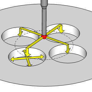

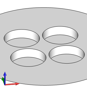

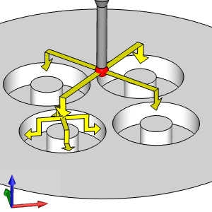

This cycle measures, with 3 points each, a radial pattern of cylindrical cut extrusions which have been cut along the Z Axis. This cycle can utilize the following geometry inputs:
- All arcs of a circular pattern whose normals are all parallel to the Z Axis.
- All cylindrical surface edges of a circular pattern whose normals are all parallel to the Z Axis.
- All cylindrical surfaces of a circular pattern whose normals are all parallel to the Z Axis.

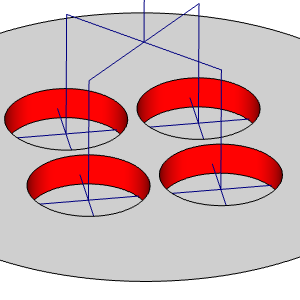

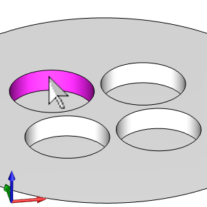

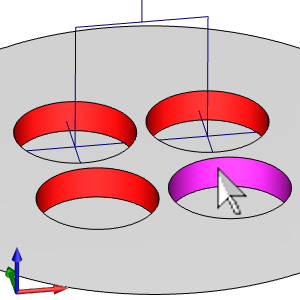

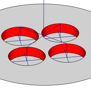

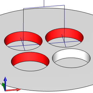

By default the Selected Geometry list is given focus to allow you to select geometry from the graphics area. - Select one of the cylindrical surfaces which has been extruded along the Z Axis, or the edge of that surface.

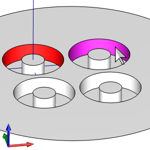

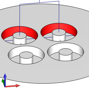

- Select another of the cylindrical surfaces.

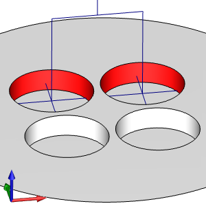

The geometry is added to the Selected Geometry list, and toolpath appears on the selected cylinder.

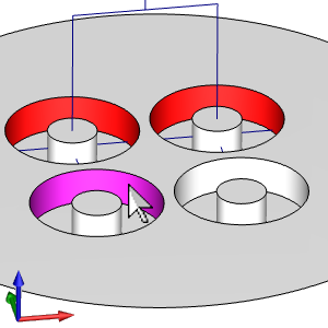

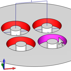

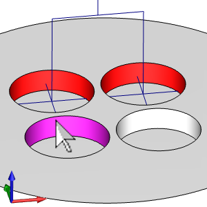

The geometry is added to the Selected Geometry list, but notice toolpath doesn't appear on this cylinder.
Since this cycle is for radial patterns, and since this new geometry does not fit into a radial pattern with the other two, it is left without toolpath.

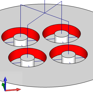

- Select the last of the cylindrical surfaces.
The geometry is added to the Selected Geometry list, and toolpath appears on this, as well as the last, cylinder.
Since the third, and now fourth cylinder fit into the radial pattern of the first two, all toolpath is now added.

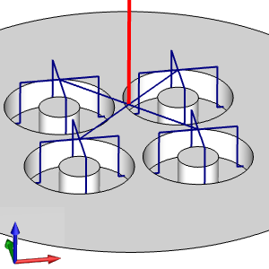

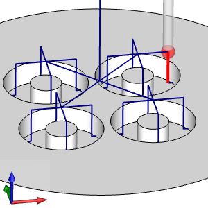

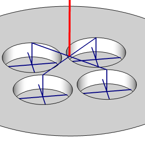

However, notice how the end positions are tied to the initial position. Since this is obviously not what we need, we will set that value back as it was. - In the Initial Position group, update the X value by adding -0.25 to the end, and pressing Tab.
- In the Initial Position group, update the Z value by adding -1.00 to the end of the current value, and press Tab.
Part 6) Updating the Options section
- Click the Options tab.

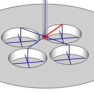

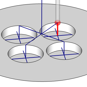

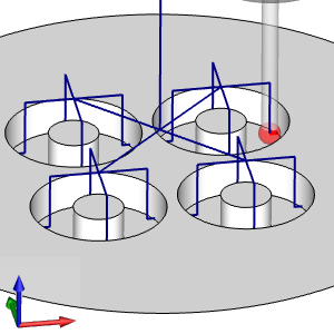

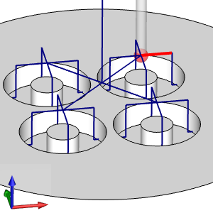

The Backplot dialog launches. - Click Next three times to view the probe movements.
- Notice we seem to have cleared the surface with our probe.Click Next until contact is made with the surface.
Tip: Using a Top View can help you ascertain the clearance of the probe easier.

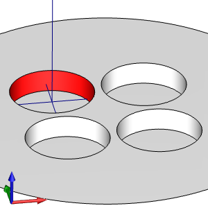

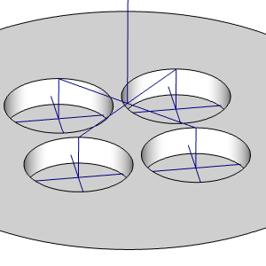

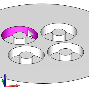

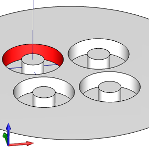

Note: Notice our toolpath is currently going through the obstruction in the middle. This will be handled later in the example.

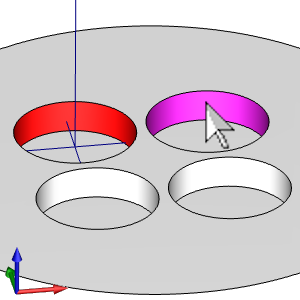

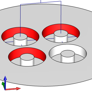

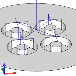

Note: Since our contact points are arranged in a radial pattern, adjusting the X,Y Initial Position will not work.However, we can adjust the Z Axis.

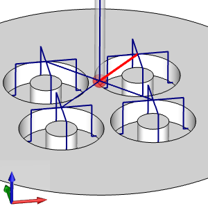

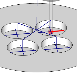

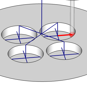

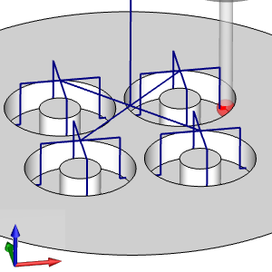

- Notice we seem to have cleared the surface with our probe. Click Next until contact is made with the surface.
