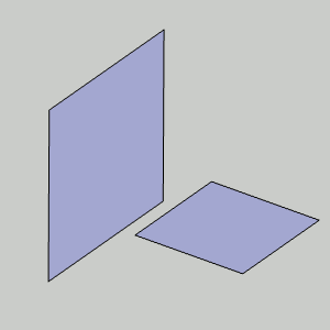

Tip: When an edge is selected, that is shared between two surfaces, which are stitched together, or part of the same solid, two faces will be added to the Choose face to be extended list. This allows you to choose the face whose edge is to be extended. However, when an edge is selected that is meeting the edge of a separate surface, it is sometimes best to hide the surface that is being left alone to ensure the correct edge is selected.
