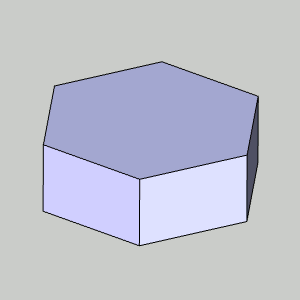

For this example, we select the geometry first to create the CAD Preview before updating the Data Entry parameters. This allows us to visualize the effect of each parameter and the result before actually creating it.
  1. Click to select the top face of the part as seen in the image below.
    The selected face is added to the Selected Geometry list.
  2. Click Show Preview to create the CAD preview.
  3. In the Data Entry Manager, under Direction, click Outward.
    The Direction option determines to which side of the original surfaces the Wall Thickness is applied.
  4. Double-click in the Wall Thickness box, to select all the text, and type 0.0625.
    Press Tab or click anywhere in the graphics area to update the CAD preview.
    The Wall Thickness is applied to all surfaces and it also determines the radius value when using the Fillet option.
  5. To shell the solid as shown in the CAD preview, click OK.
    The Shell is created in the graphics area and a Shell feature is created in the CAD Tree.
