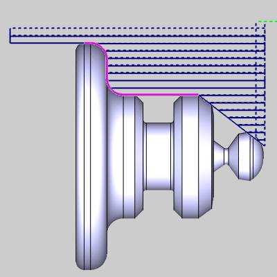

The purpose of Turning is to refine the overall shape of the outer and inner diameters of the part. The Lathe Turning feature offers several operations, each of which has many variables that can be tailored to your needs.

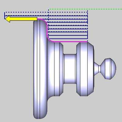

Material Approach

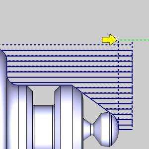

Rapid Plane - is the height at which the tool can rapid safely within a single operation. This value visualized as a dotted line in the toolpath and is an incremental distance above the Top of Feature defined in the Constraints section.
Default Rapid
Higher Rapid Value

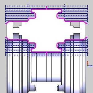

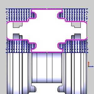

Region - Sets the features default settings for the type of toolpath being used. This will set the default rapids, entry and exits as well as default tool selection and direction of cut.
  • 1 - See examples.
  • 2 - See examples.

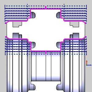

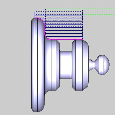

OD
OD Region 1
OD Region 2
ID
ID Region 1
ID Region 2
Face
Face Region 1
Face Region 2
Back Face
Back Face Region 1
Back Face Region 2

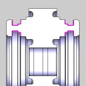

Undercut

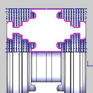

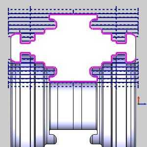

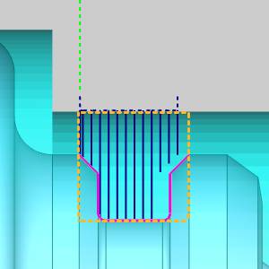

The Undercut section provides a way to limit what is being cut in the feature without the need to create additional CAD geometry. See the images and definitions below to get an understanding of what an undercut is defined as.
OD, ID
Front Face, Back Face

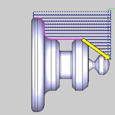

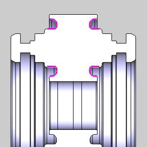

Primary Undercut
The definition of a Primary Undercut varies depending on the region and feature type. Any geometry on an OD feature that drops in X from the initial start point is considered an area of primary undercut. In the case of an ID feature it is geometry that rises in X from the initial start point. Any geometry on a Front or Back Face feature, that doubles back on itself is considered an area of primary undercut.
OD, ID
Secondary Undercut
The definition of a Secondary Undercut varies depending on the region and feature type. Any geometry on an OD, or ID feature that doubles back on itself  is considered an area of secondary undercut. In the case of a Front Face and Back Face OD feature, any geometry that drops in X from the initial start point is considered to be an area of secondary undercut. In the case of a Front or Back Face ID feature, it is geometry that rises in X from the initial start point.

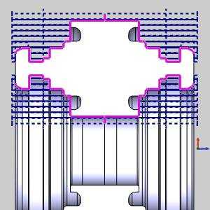

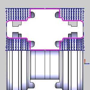

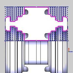

Remove Primary Undercut - Selecting this option will force the toolpath to avoid areas defined as Primary Undercuts.
Remove Secondary Undercut - Selecting this option will force the toolpath to avoid areas defined as Secondary Undercuts.
OD, ID
Remove Primary
Remove Secondary
Remove Primary
Remove Secondary
Remove Primary
Remove Secondary
Remove Primary
Remove Secondary
Remove Primary
Remove Secondary
Remove Primary
Remove Secondary

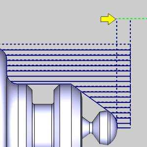

Top of Feature - Defines the height at which the rapid plane will be incremental from.
  • From Stock - Sets the Top of Feature to the highest point of the stock diameter.
  • From Geometry - Sets the Top of Feature to the highest point of the selected feature geometry.
  • Custom - Set the Top of Feature from the highest point of the selected feature geometry to the value entered.
    • Pick - allows you to select a point or the snap point of an entity to set the height of the feature.

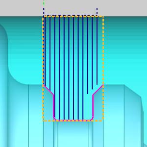

Extensions allow you to extend the feature geometry without the need to create additional CAD geometry. The extension will be added or subtracted along the chain of entities.
- No extension will be added to the feature geometry.
- Will allow you to define an extension to the feature geometry.
