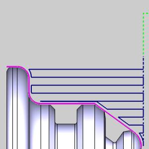

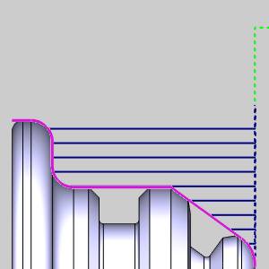

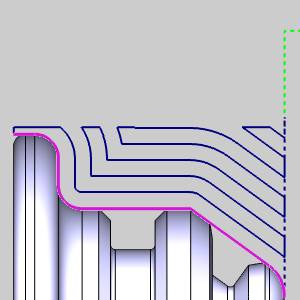

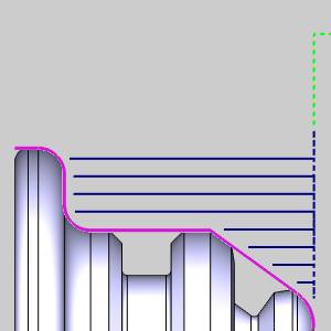

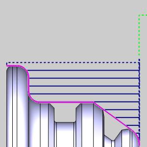

Standard - Each pass will be parallel to the center of rotation.

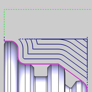

Offset - Each pass will be an offset copy of the selected geometry trimmed to the feature constraints.
Standard Offset
Sorting
Sorting allows  you to select how the passes link to the following pass.

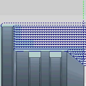

Standard - defines a one-way cutting pattern with retracts between each cut.
Zig Zag - defines a two-way or alternating cutting pattern.
In the table below you can see how these sorting options affect the selected patterns.
Standard Pattern
With Standard Sorting
With Zig Zag Sorting
Offset Pattern
With Standard Sorting With Zig Zag Sorting

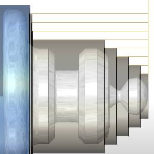

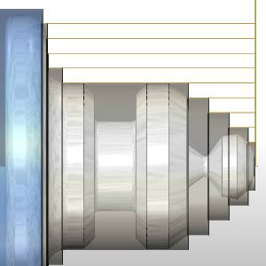

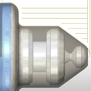

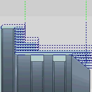

Rough Allowance -  Selecting this option will create a pass before the final pass to act as a semi-finish. The spacing of the semi-finish pass will be dictated by the values entered in the Z and X boxes.
No Allowance
Finish Allowance
Rough & Finish
No Allowance Simulation
Finish Allowance Simulation
Rough & Finish  Simulation
*Steps can also be eliminated with the Overlap options below.
Overlap
The Overlap options allow you to create an additional move prior to the link to the next pass. This link will track back up the geometry in order to eliminate stair steps as seen in the images above. Overlap is controlled with either, To Previous Cut, No Overlap, or Custom Distance.

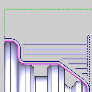

Corner Type
Round - keeps the specified tool geometry in contact with the geometry at all times.
Sharp - allows the tool to move off the geometry in order to line up with the next move on the following entity. This method eliminates the rounding over of the tool.
Theoretical Point on Tool
Rounded Corner
Sharp Corner
Bounds
Trim to Stock -  With this option selected, the toolpath that extends beyond the Operation Stock will be trimmed away.
