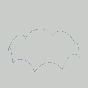

The Multisided Patch function is used to create a 3-dimensional surface from a closed chain that consists of 3 or more edge curves. To perform the function, you chain select each geometry curve one at a time in a consecutive order. After the chain direction of all edge curves is defined, you confirm the selection to create the surface.

When creating a Multisided Patch, you complete one chain selection for each side of the surface.Each chain can be one or more entities. The selection order determines the results, and the chains should all share the same general direction, such as clockwise.

  3. In the Picking Manager, turn off Auto-Chaining, and highlight the end of the first entity, of the first chain, as seen in the image below.

Tip: While selecting the geometry for a Multisided Patch, you can click the start arrow to change the direction of that cross section, or use the Reverse button after highlighting that chain in the Selected Geometry list of the Multisided Patch Surface parameters  in the Data Entry Manager.Itis important that all of the chains share the same direction.
  1. Continue with these steps, selecting each entity as an individual chain, until all chains are added to the Selected Geometry list.
    With all chains selected the Preview appears.
  2. Click OK to finalize the Multisided Patch.
    The surface is created in the graphics area and a Multisided Patch feature is created in the CAD Tree.
